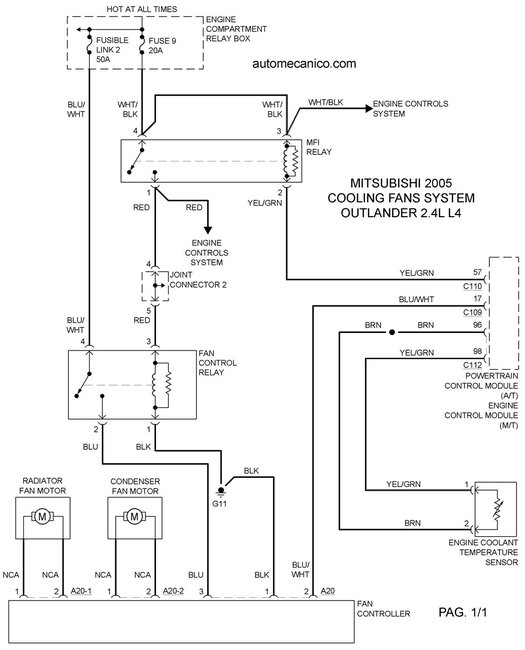

Hi, i have a trouble with the two fans located in front of the radiator. When i turn the switch to on both fans start to run at high speed and never stop, i saw a trouble shooting that says that i have to check the voltage in the fan control module connector at pin 1 and 3. when i checked the voltage at that connector is 12 vdc. It that correct?

Are there any applicable trouble codes? If you pull the fan control relay, it should turn off the fans, as far as testing. The relay should not be energized at all times. The MFI relay is involved as well as the computer. I was hoping the wiring diagram would help, a little.

Hi, well if you share your phone number for sure I will call you, I am using the following wiring diagram. The diagram that I have is for Outlander 2003 and I have another one for 2005, although my car is 2004, the diagrams between 2003 and 2005 are almost the same there is a little difference. Well on these diagrams shows me that the temperature sensor sends the signal to the ECU, I checked made a test to the sensor and it is okay, I measure the resistance and it changes when I put some heat or cold.
The MFI relay is working good because I removed it then I applied 12 VDC with an independient power source I have and it works when the solenoid is energized, the same with the fan control relay. So, when I started to check the fan controller, I measured 12 VDC on the main connector.

opss. I forgot to share the wiring diagram I have.

Sorry, my hearing is no good. I have trouble on the phone. I will not use the phone except in an emergency. That blue wire should not be hot with everything off.
