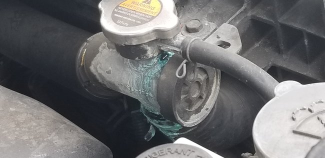

Blue stuff around cap and hose of radiator
123,500 MILES • V6 • 2WD • AUTOMATIC
RG16
How to tell if the leak is from cap, or upper hose?

You need to pressure test the system with a pressure tester. That will tell you if it is a hose. There is a separate adapter for pressure testing the cap itself.
I attached a guide for you to view.
https://www.2carpros.com/articles/radiator-pressure-test

I just uploaded a picture that did not upload before. Does that help?
Jul 20, 2019 at 4:25 AM
Nothing came up.
Try it again.
Jul 20, 2019 at 4:49 AM
RG16
Sorry, I uploaded it to original post. Here it is again:
Jul 20, 2019 at 6:02 AM
Got it.
Do the pressure test I asked you to do. It looks like the cap but you need to be sure.
