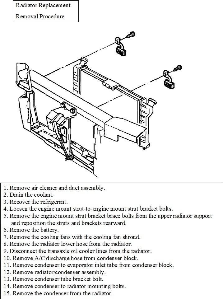

Radiator replacement?
2001 PONTIAC AZTEK
112,000 MILES
SUZETTE PETILLO
Replacing it.
Jun 9, 2023 at 5:54 PM
CARADIODOC
  • 34,321 POSTS
What's the question? Are you replacing the radiator? Want to know how to tell if it needs to be replaced? Wondering if a shop charged you too much to replace it?
Here's links to some related articles you might find of interest:
https://www.2carpros.com/articles/how-a-radiator-works
https://www.2carpros.com/articles/how-to-replace-a-car-radiator

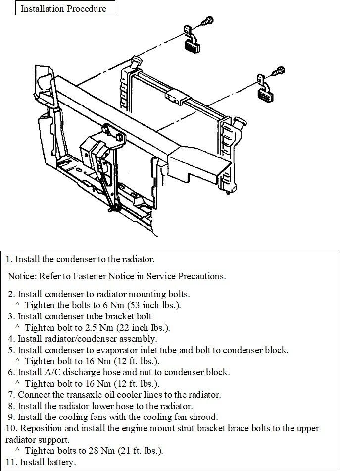

The replacement instructions are below.
