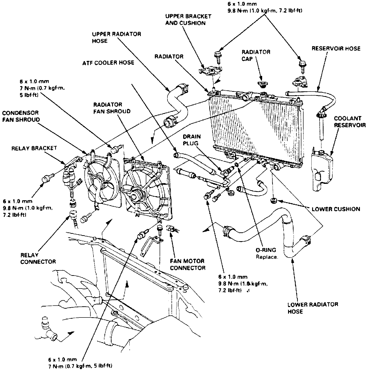

I need instructions how to remove and replace radiator.

Here are the directions you requested from Alldata. See the attached picture for part locations and guidance when doing the job.
I hope it helps.
______________________________________
1. Drain engine coolant, then radiator hoses and ATF cooler hoses, Fig. 77.
2. Disconnect fan motor electrical connections, then remove radiator upper brackets.
3. Pull up and remove radiator, then remove fan shroud assemblies and other parts as necessary.
4. Reverse procedure to install.
Let me know if you have questions.

Thanks for diagram, This was a great help. Got it done. Thanks for all your help.
