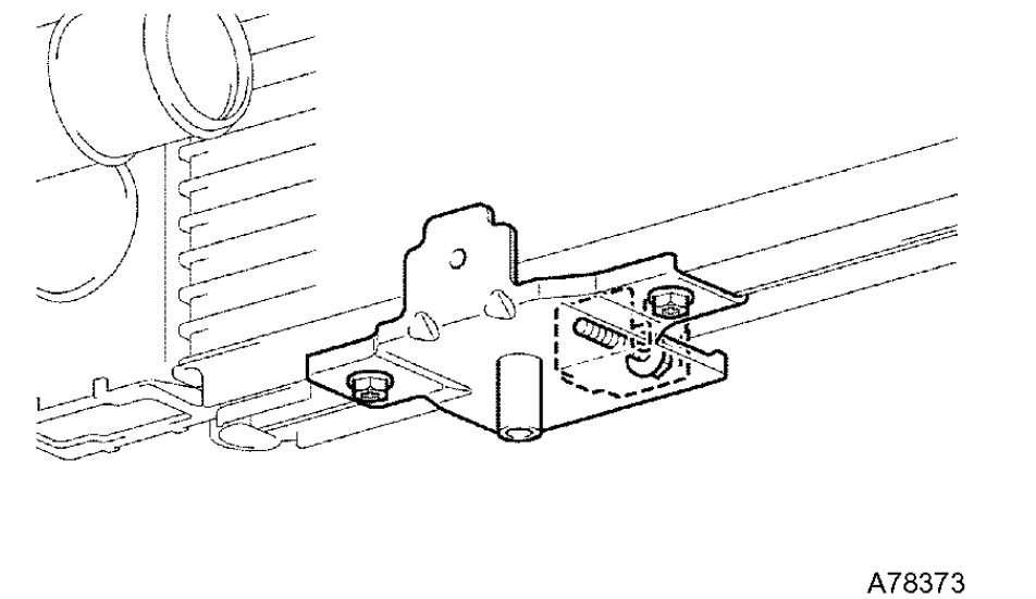

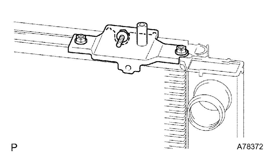

No.2 radiator assembly replacement
1. Drain coolant
2. Disconnect radiator hose inlet
3. Disconnect radiator hose outlet
4. Disconnect oil cooler inlet hose no.1
5. Disconnect oil cooler outlet hose no.1
6. Remove front bumper cover
7. Remove air cleaner cap sub-assembly
8. Remove air cleaner filter element sub-assembly
9. Remove air cleaner inlet no.2
10. Remove air cleaner case
11. Remove air cleaner bracket
12. Remove air cleaner inlet no.1

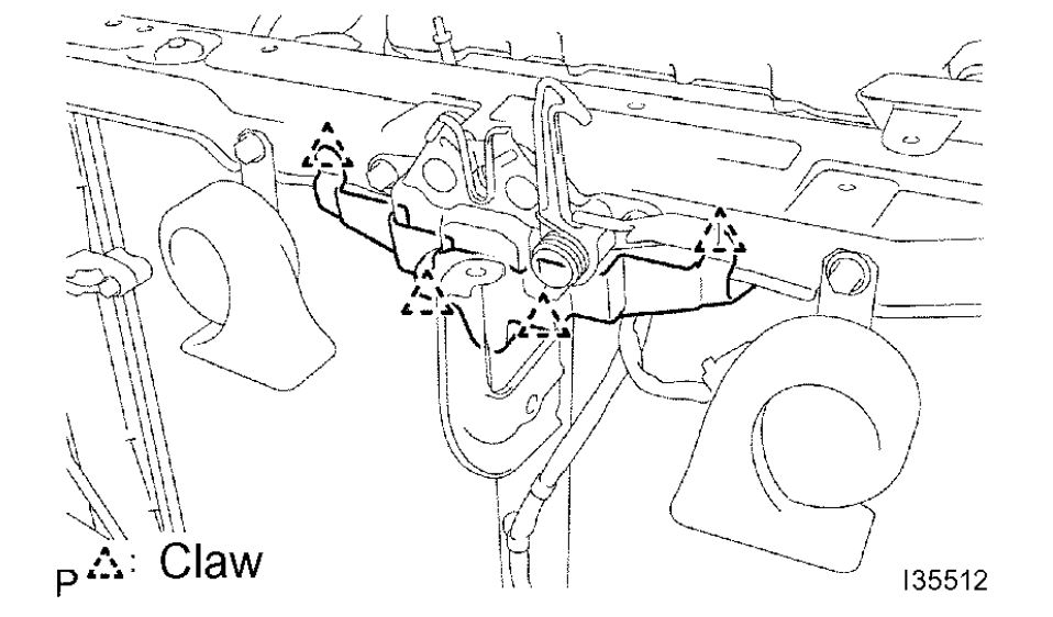

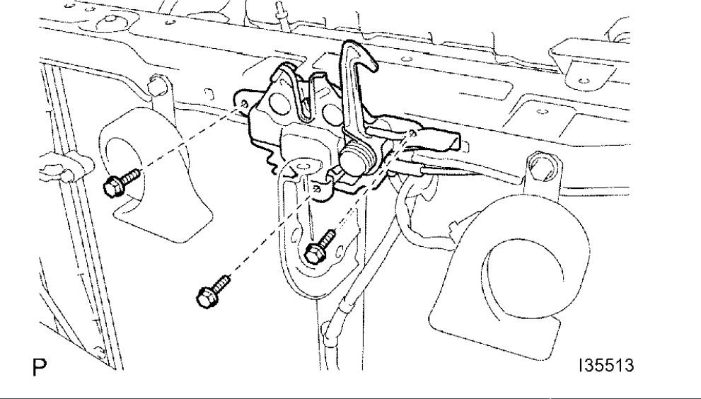

13. REMOVE HOOD LOCK RELEASE LEVER PROTECTOR
a. Release the 4 claws and remove the hood lock release lever protector.
14. REMOVE HOOD LOCK ASSEMBLY
a. Remove the 3 bolts and separate hood lock.

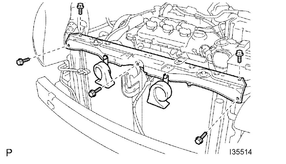

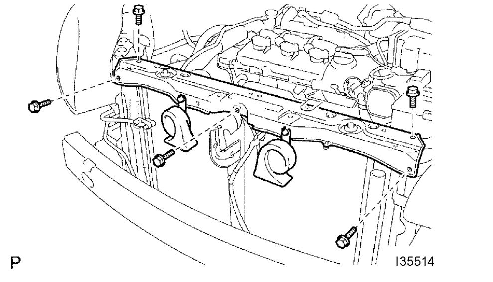

15. REMOVE RADIATOR SUPPORT SUB-ASSEMBLY UPPER
a. Disconnect the horn connectors.
b. Remove the 5 bolts and the radiator upper support.

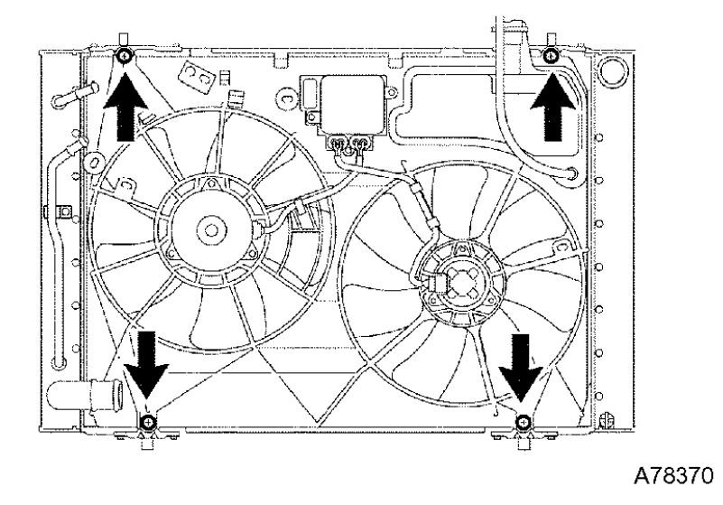

16. REMOVE FAN SHROUD
a. Disconnect the engine coolant reservoir hose.
b. Disconnect the fan motor connector.
c. Remove the 4 bolts and the fan shroud.

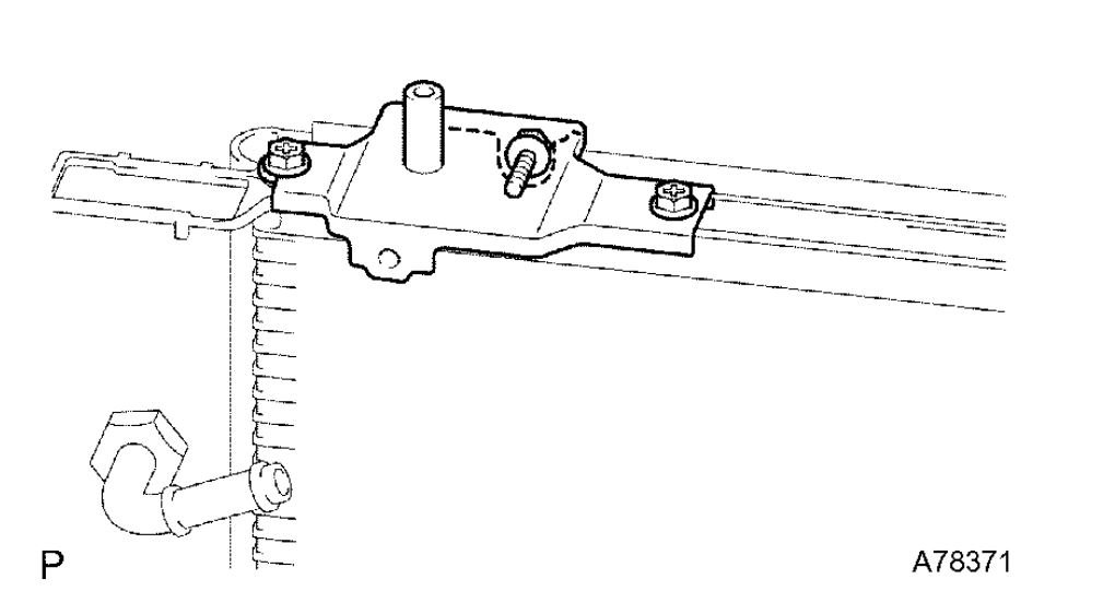

17. REMOVE RADIATOR SUPPORT SUB-ASSEMBLY UPPER LH
a. Remove the 3 bolts and the radiator support upper LH.
18. REMOVE RADIATOR SUPPORT SUB-ASSEMBLY UPPER RH
a. Remove the 3 bolts and the radiator support upper RH.

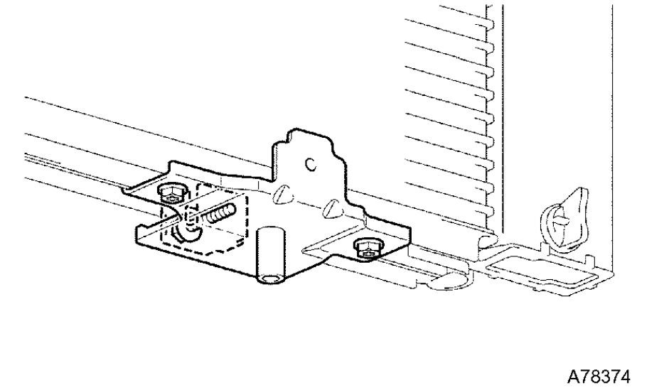

19. REMOVE RADIATOR SUPPORT SUB-ASSEMBLY LOWER RH
a. Remove the 3 bolts and the radiator support lower LH.
20. REMOVE RADIATOR SUPPORT SUB-ASSEMBLY LOWER RH
a. Remove the 3 bolts and the radiator support lower RH.
21. REMOVE NO.2 RADIATOR ASSEMBLY

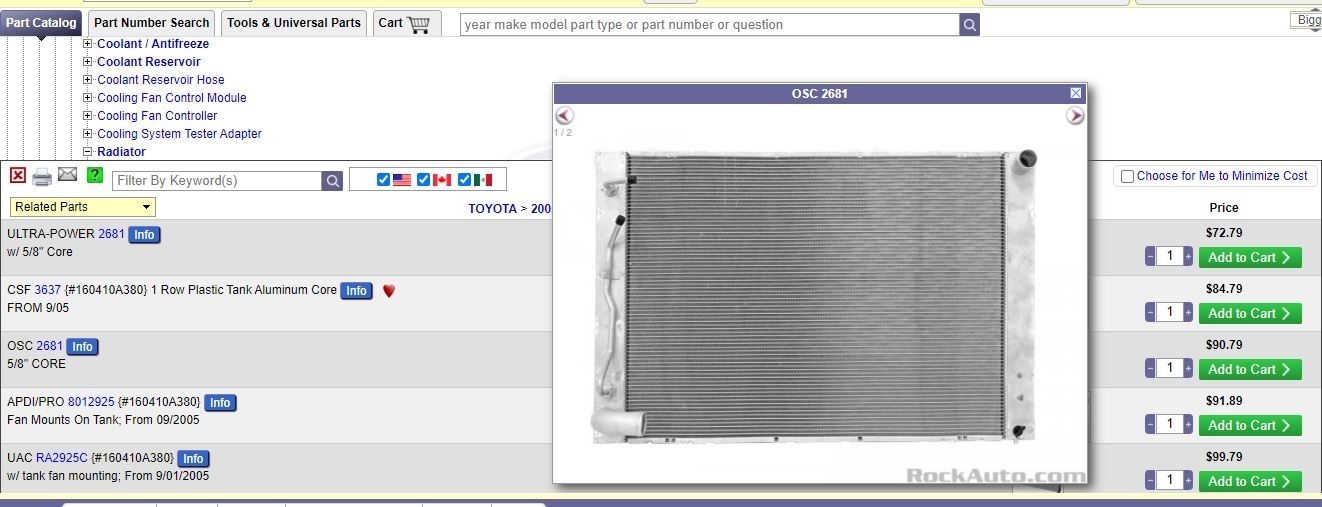

I attached the radiator for you from Rock Auto based on the production date.
Jan 12, 2021 at 2:42 PM
PCULQUI
  • 354 POSTS
So which one is the best? What is the difference between all of them? Disadvantages and advantages.
Jan 13, 2021 at 12:46 PM
The one I gave you is for your car based on the production date.
Of course, the higher the price, the higher the quality.

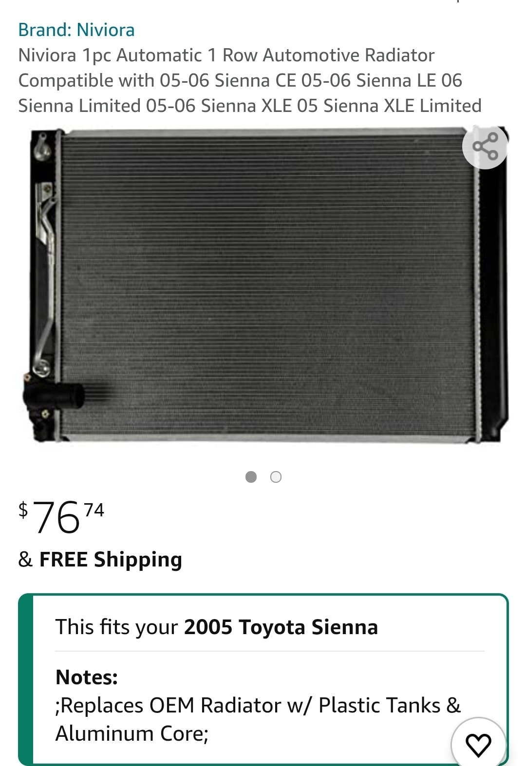

what do you think about this radiator from Amazon. Will it work?
Jan 17, 2021 at 5:08 AM
Is it or does it conform to your date of manufacturer?
Jan 17, 2021 at 5:22 AM
PCULQUI
  • 354 POSTS
I haven't checked that. With Amazon, many times you can't get any info on products.
Jan 17, 2021 at 6:36 AM
Then you have about an 80% chance of the wrong radiator.
Jan 17, 2021 at 6:38 AM
PCULQUI
  • 354 POSTS
On Amazon, its says it's for a 2005-2006 Toyota Sienna le awd 3.3L minivan 1 row which i assume is 1 core and not 2 like the ones in Rock Auto.
Jan 17, 2021 at 6:39 AM
Okay, you can try but I would not expect it to be correct.
Jan 17, 2021 at 6:46 AM
PCULQUI
  • 354 POSTS
oh, okay. Thanks.
Jan 17, 2021 at 11:02 AM
You are welcome.
