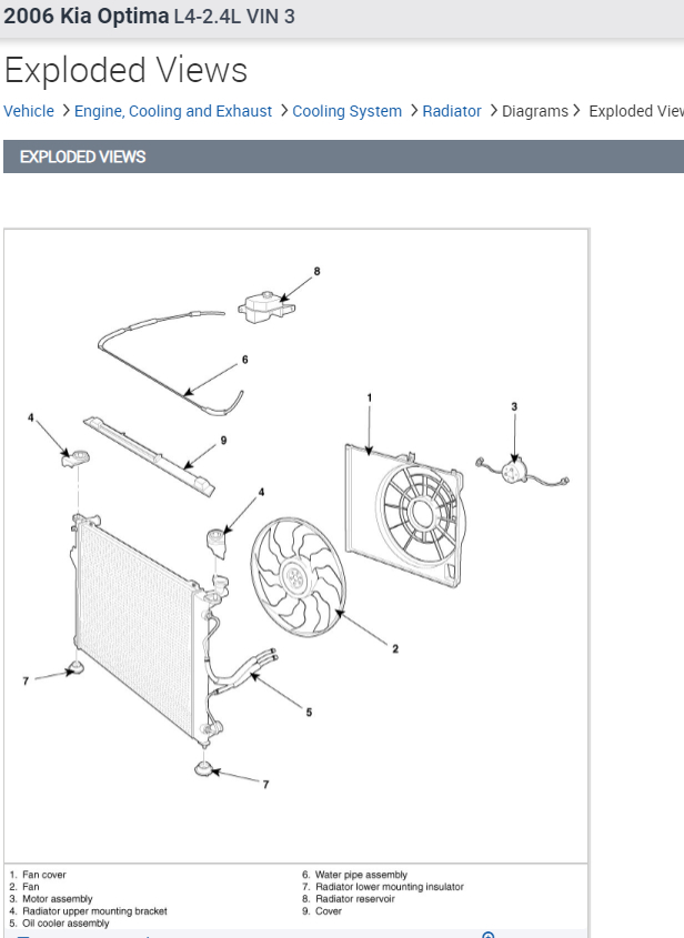

Which years and make and models of radiators will work in my car listed above LX
Five speed transmission?
Jul 16, 2022 at 6:36 PM
SQM
  • 6,383 POSTS
2006-2008 Optima and Sonata with the 2.4L use the same radiator.
