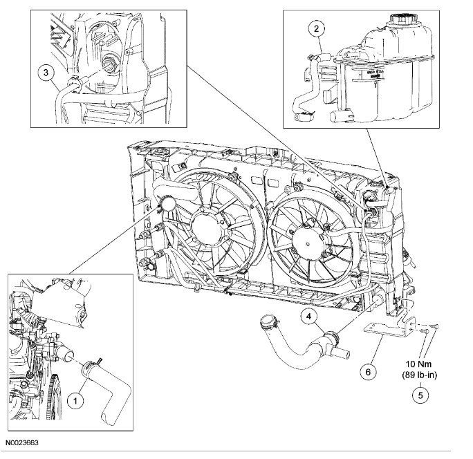

How to replace the radiator in a 2006 ford Taurus 3.0. Does it come out the top or the bottom? I got everything off the top and disconnected all lines but it still won't come out. I'm very confused. I've never changed a radiator where you had to remove the whole front end accessories just to get to the fan shroud.
May 19, 2013 at 2:02 AM
  • 55,711 POSTS
Hey JBK13,
Here is a generic guide to help you step by step with instructions in the diagrams below to show you how on your car. The radiator comes out from the top.
https://www.2carpros.com/articles/how-to-replace-a-car-radiator
Check out the images (Below). Please let us know if you need anything else to get the problem fixed.

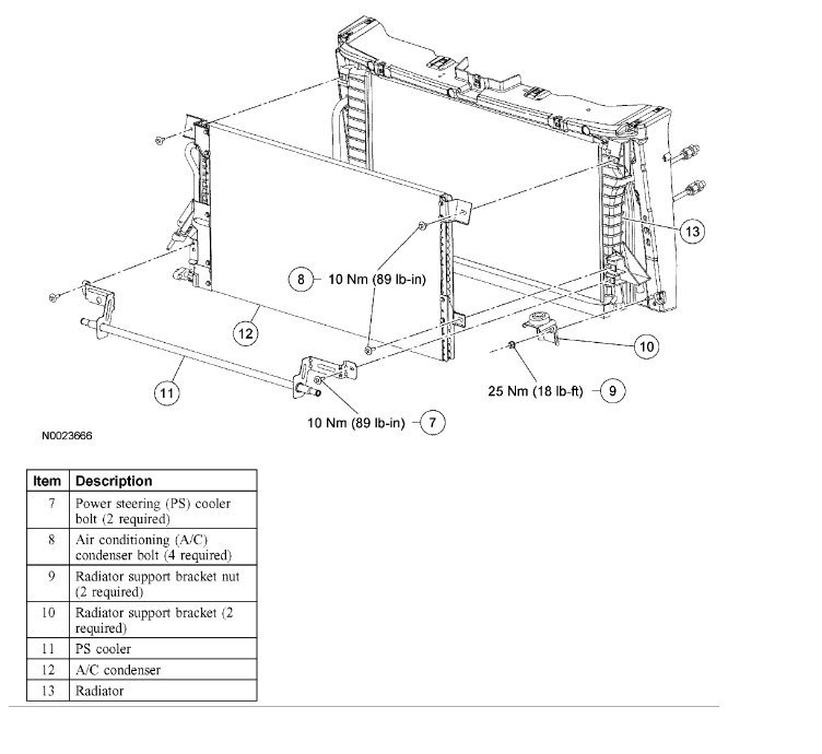

RADIATOR
Removal and Installation
NOTE: 3.0L (2V) shown, 3.0L (4V) similar.
1.Remove the battery and battery tray.
2.Drain the cooling system.
3.Disconnect the upper radiator hose.
4.Disconnect the degas return hose.
5.Using the special tool, disconnect the upper transmission cooler line.
6.Remove the two A/C condenser retaining bolts.
7.Raise and support the vehicle. 8.Remove the radiator support bracket bolts and the radiator support bracket.
9.Disconnect the lower radiator hose.
10.Disconnect the lower transmission cooler line.
11.Remove the two bolts retaining the condenser to the radiator
12.Secure the A/C condenser.
13.Remove the bolt retaining the P/S cooler to the radiator.
14.Remove the nuts and the radiator support brackets.
15.Remove the radiator from the vehicle.
16.To install, reverse the removal procedure.

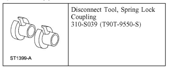

BLUELIGHTNIN6
  • 16,542 POSTS
hoist vehicle up and take radiator out the bottom. will need special disconnect tool to disconnect tranny cooler lines.
Feb 15, 2017 at 7:09 AM (Merged)
FORDARREL
how do you remove the radiator cooler lines from the radiator.
BILLYMAC
  • 2,204 POSTS
you need a lock removing tool from the auto store they use the same locks as the fuel filters
