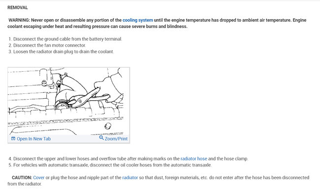

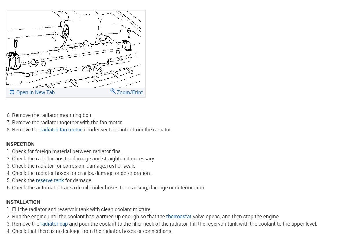

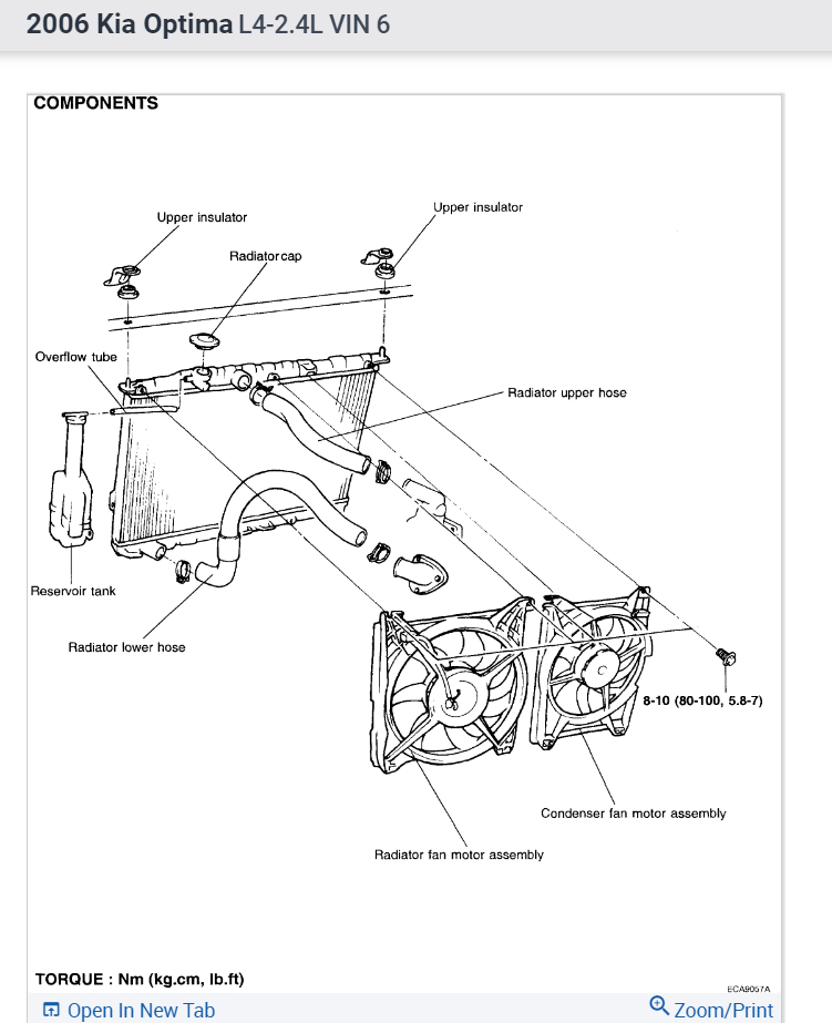

Crack in front of plastic radiator. Can I use another radiator from any car?
Jul 9, 2022 at 3:52 PM
  • 55,423 POSTS
Nope, you must use a radiator for this car, you can get a cheap one from amazon for $76.00.
https://amzn.to/3RoiZDu
Here is a generic guide on how to replace it with diagrams below to show you how on your car:
https://www.2carpros.com/articles/how-to-replace-a-car-radiator
