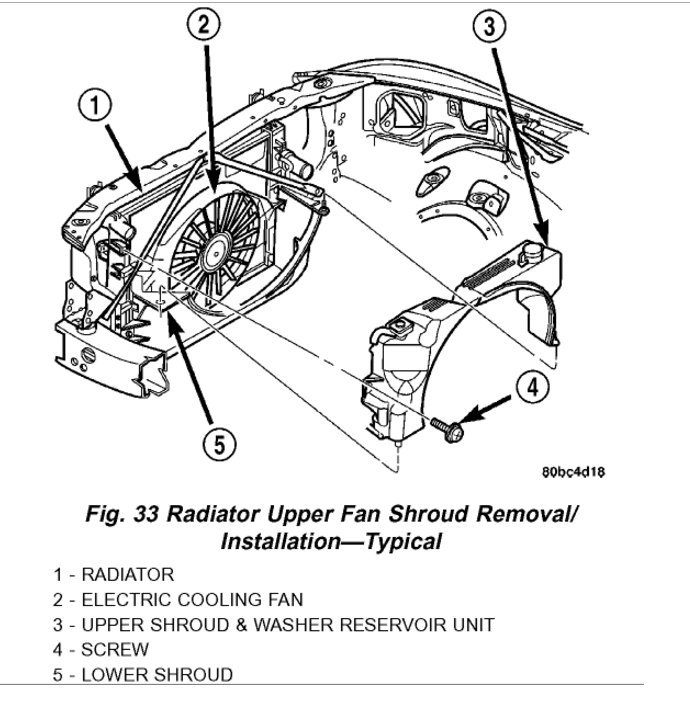

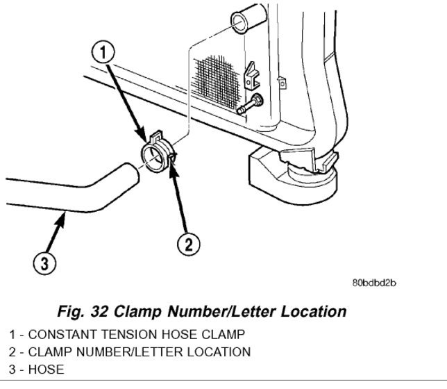

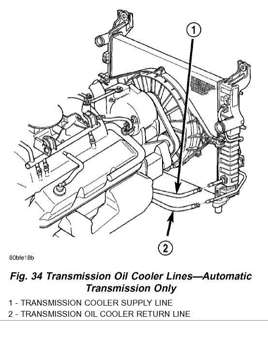

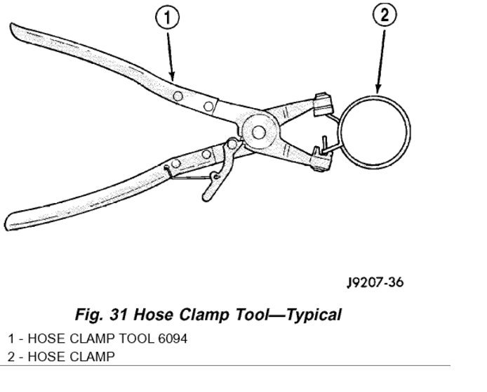

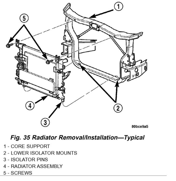

Removal steps for the radiator.
May 11, 2017 at 7:02 AM
Experienced Mechanic
55,694 POSTS
You will need to drain the coolant first, here is a guide to get you headed in the right direction and a few diagrams (BELOW) to further assist you.
https://www.2carpros.com/articles/how-to-replace-a-car-radiator
