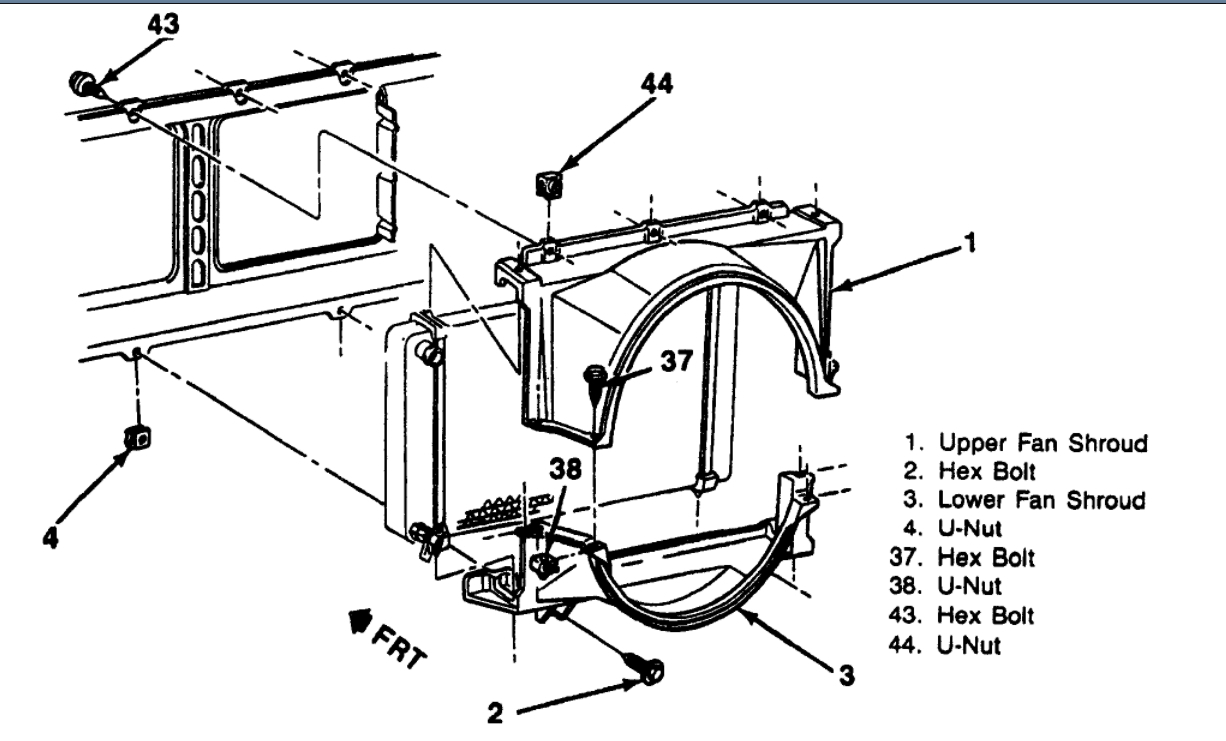

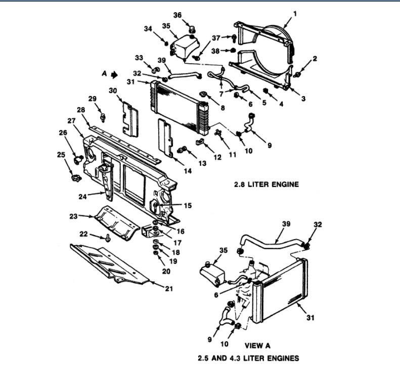

Install or Connect
1. Radiator.
2. Engine oil cooler line fittings.
Tighten
Fittings to 35 N.m (25 ft. lbs.).
3. Transmission fluid cooler line fittings.
Tighten
Fittings to 27 N.m (20 ft. lbs.).

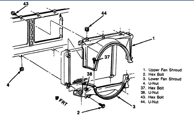

4. Hoses.
5. Upper fan shroud.
6. Coolant reservoir hose.
7. Coolant to the radiator.
