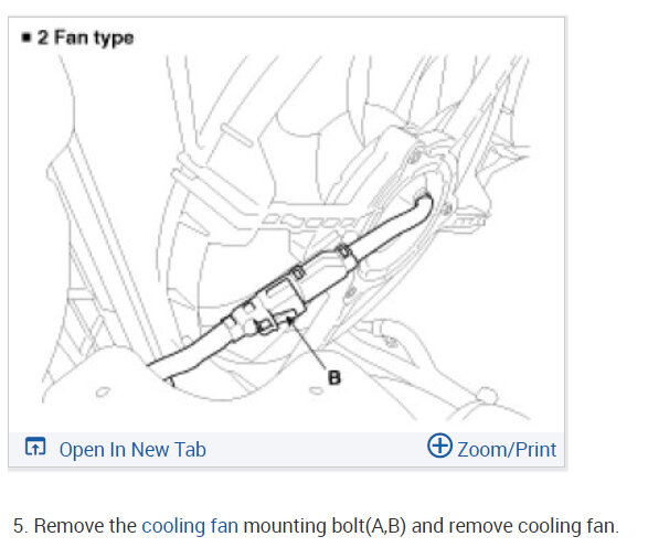

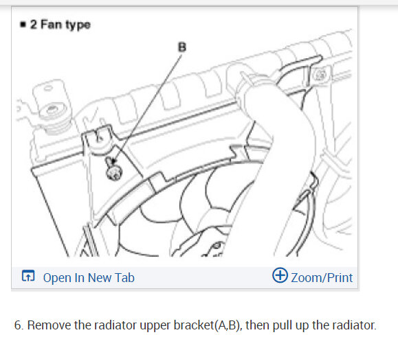

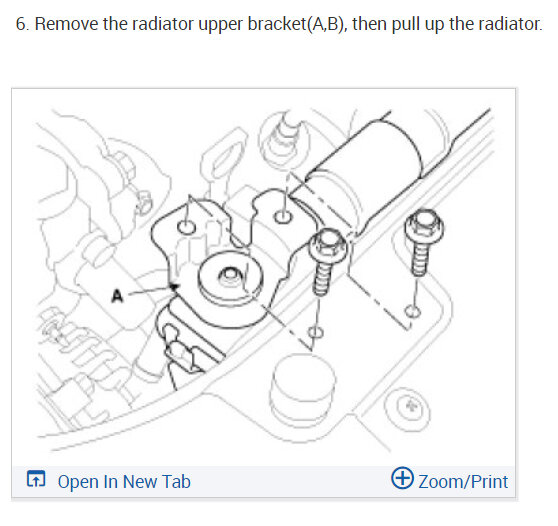

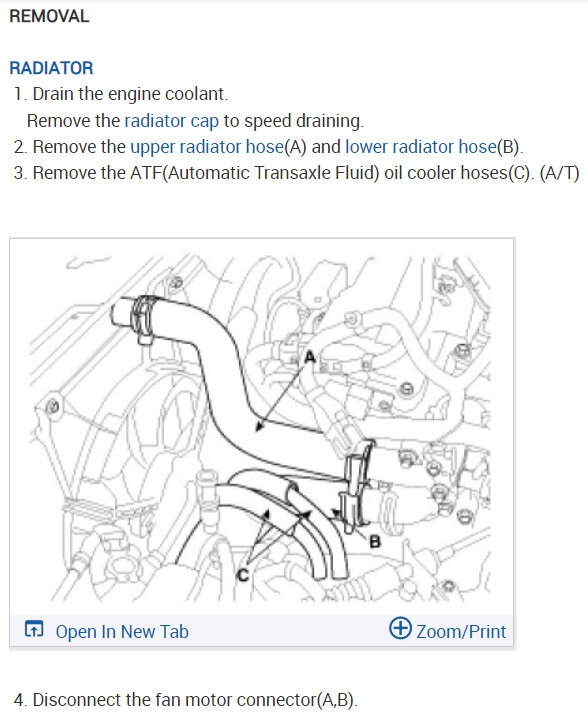

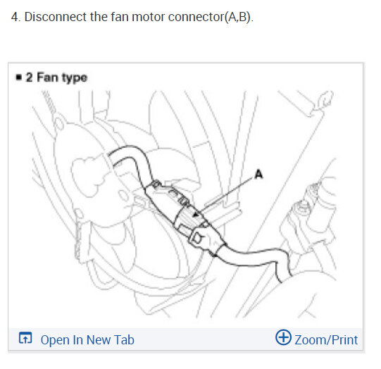

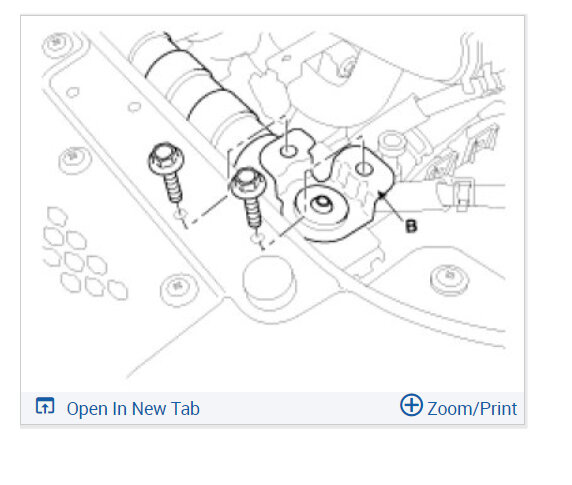

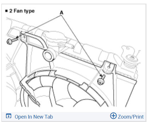

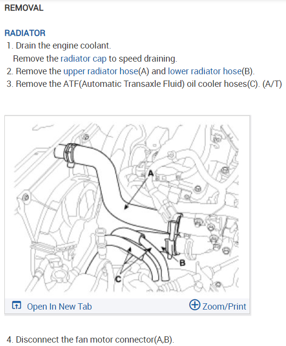

What other vehicle's radiators that will fit my vehicle listed above?
Oct 7, 2024 at 7:59 PM
  • 55,399 POSTS
Here are the cars with radiators that might fit.
Kia Optima (2006-2010): If your Rondo has a 2.4L engine, the radiator from a Kia Optima of similar years may fit.
Hyundai Sonata (2006-2010): Similar engine configurations and chassis design between the Sonata and Rondo could allow for radiator compatibility.
Hyundai Tucson (2005-2009): Depending on your Rondo’s engine, the Tucson’s radiator may also fit.
Kia Sportage (2005-2010): Another option for potential radiator compatibility, especially if it shares the same engine and transmission.
Here is how to change out the radiator in case you need it. Check out the images (below). Let us know if you need anything else.
