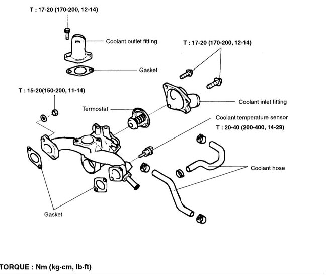

My car had been running great until a couple of days ago. It all of a sudden started getting hot. I was close to home so I made in home. When it cooled off I checked it out and here is what I found; first of all I might add it was like 107°outside when I was driving home. Anyway I checked my oil filter and it was loose, I was able to turn it with my hand and also at the top of the radiator along the seam it is cracked which I am assuming is where I lost my water causing it to over heat. My question is, this does not necessarily mean it blew a head gasket right? Could it be that the thermostat is stuck?
Jul 14, 2017 at 8:02 AM
  • 55,561 POSTS

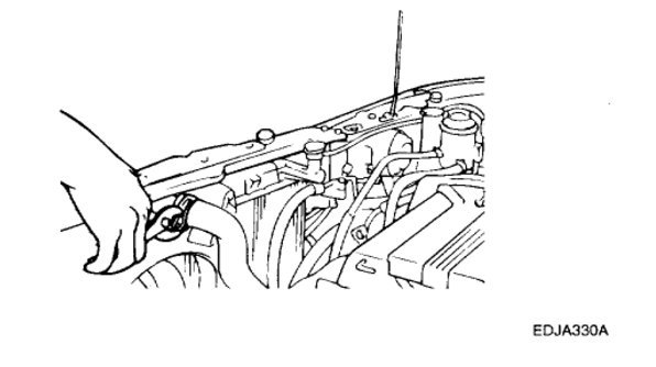

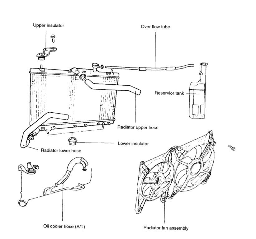

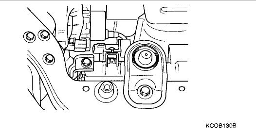

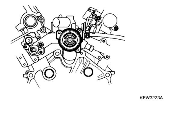

This kind of problem happens all the time to older radiators and the engine can be just fine. I would replace the radiator and thermostat to be safe, though here are some guides and diagrams (below) to help you get the problem fixed and get back on the road.
https://www.2carpros.com/articles/how-to-replace-a-car-radiator
and
Jul 17, 2017 at 3:51 AM
