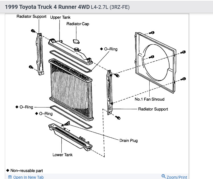

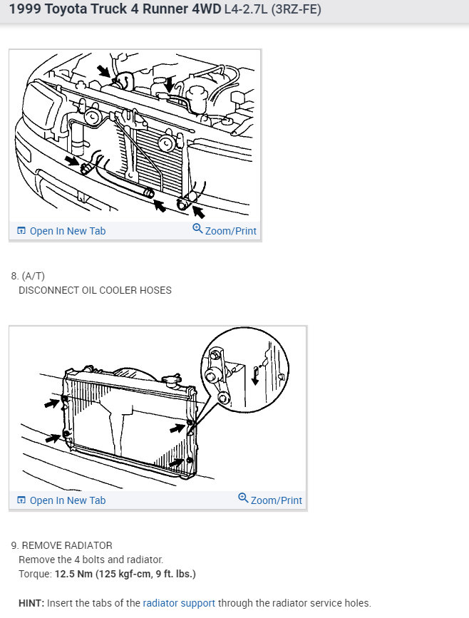

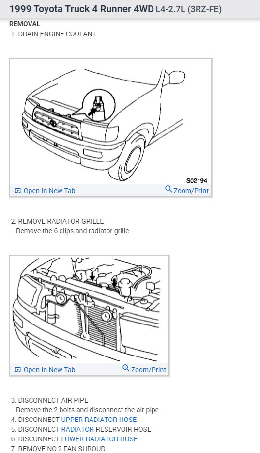

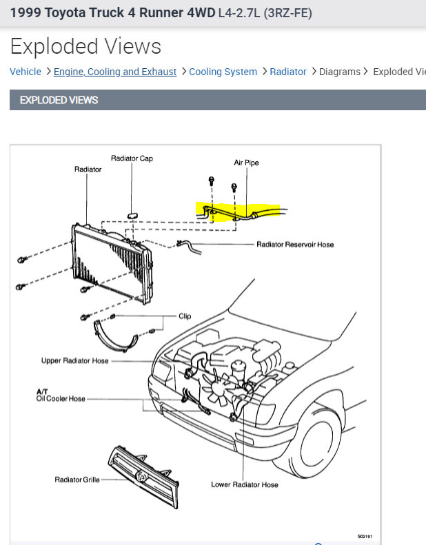

I have a radiator replacement and the tubing on the bottom the metal tubing is different than the old radiator is there a way that I can transport the ports from the old one to the replacements and be, okay?
Feb 23, 2022 at 9:04 PM
SQM
  • 6,383 POSTS
Are you talking about the oil cooler line that is on the radiator?
Can you upload pictures of both the old and the new one? So, we can see exactly what you are mentioning.
I have attached diagrams below for your reference.
