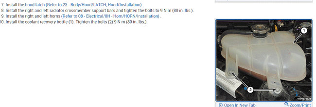

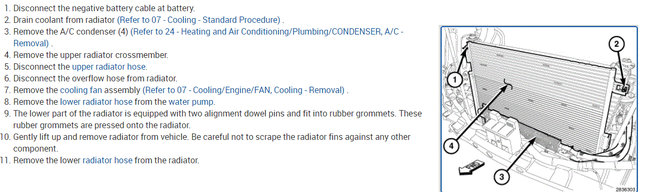

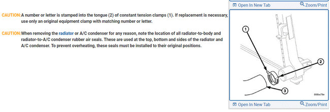

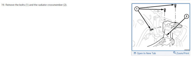

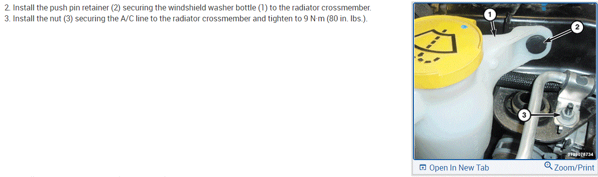

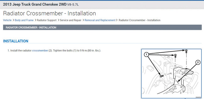

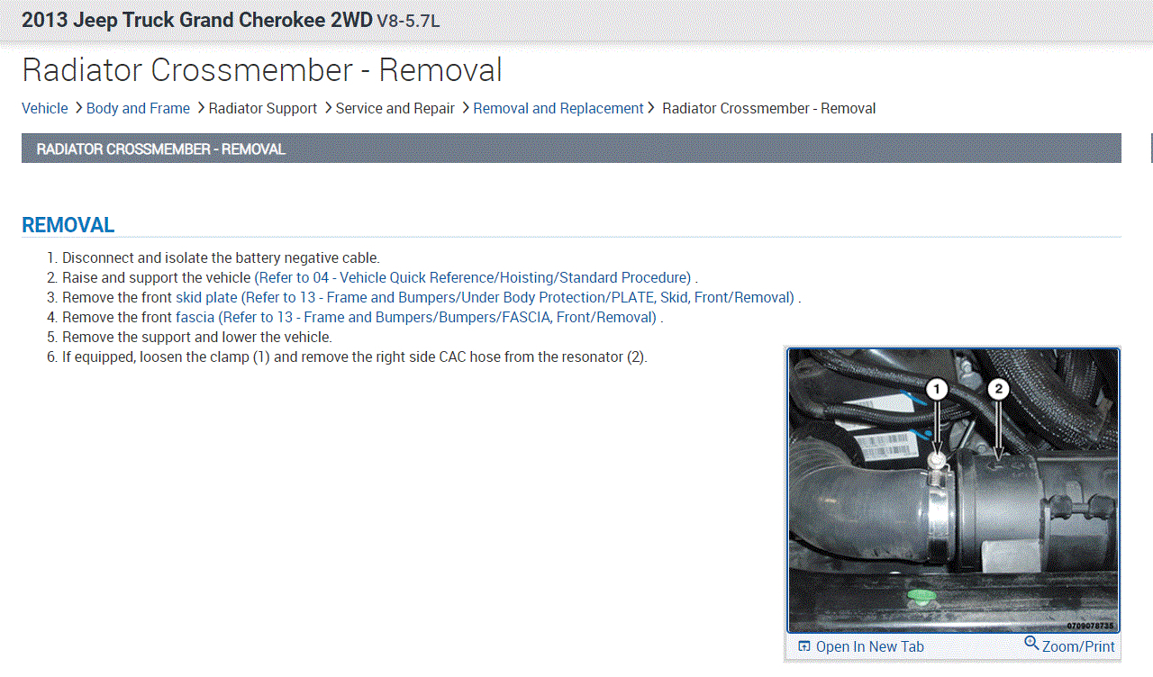

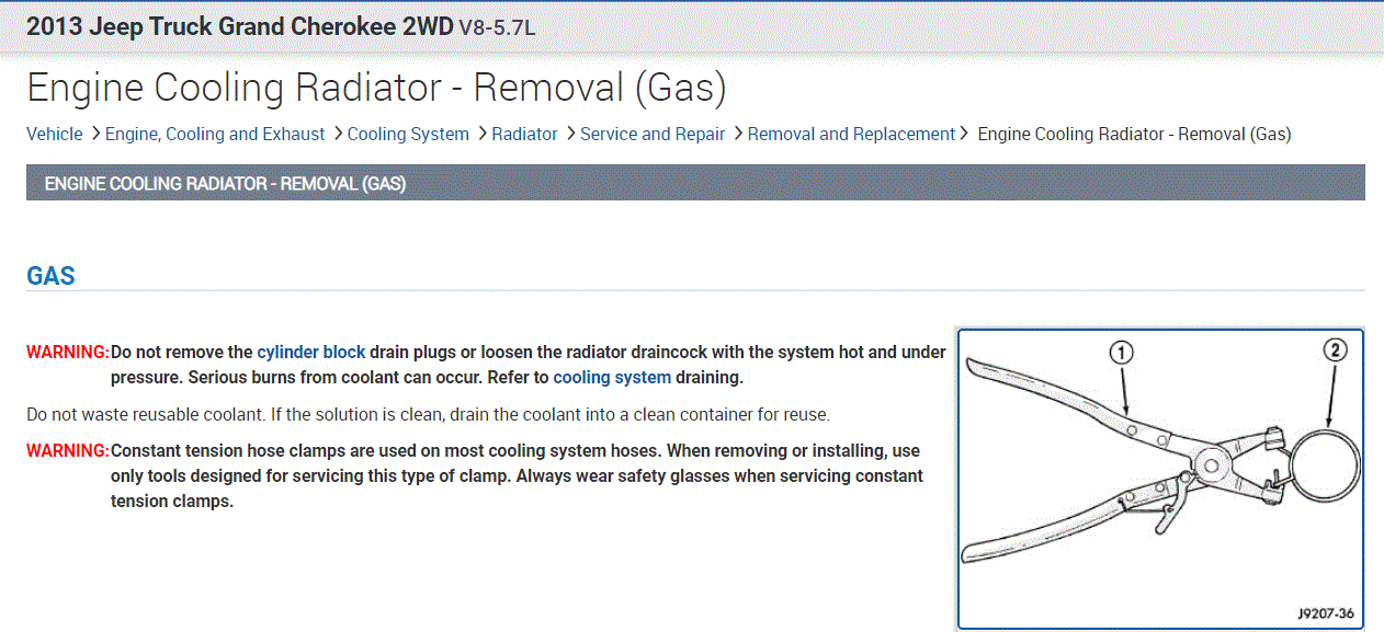

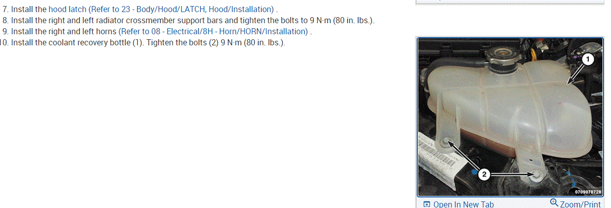

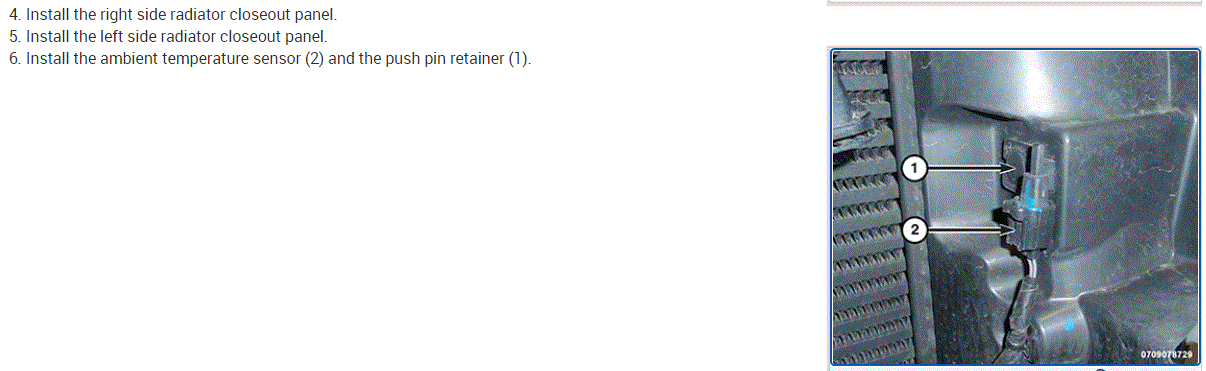

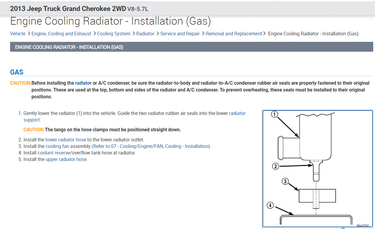

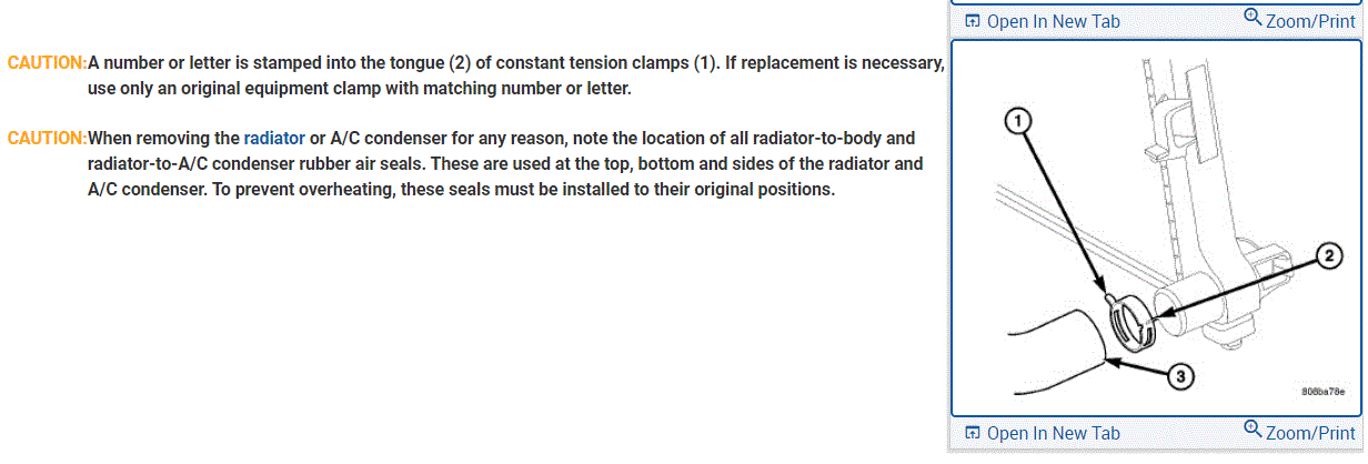

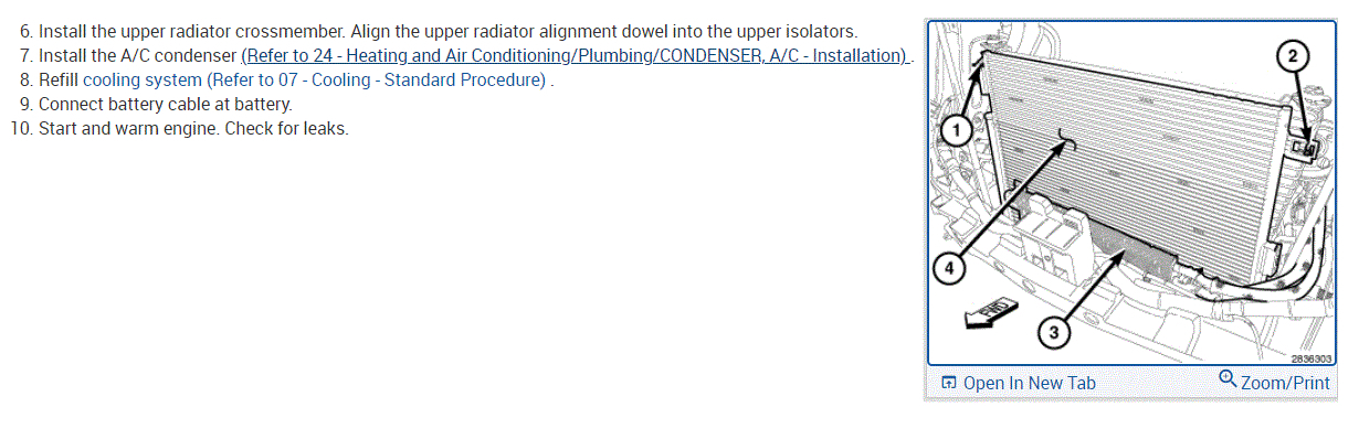

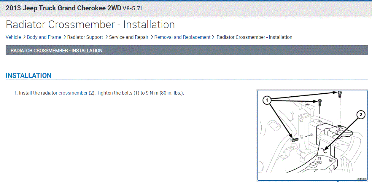

Need to install a radiator on my vehicle listed above with a 5.7 Hemi.
Apr 20, 2021 at 1:10 AM
  • 110,248 POSTS

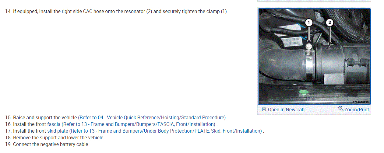

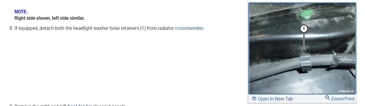

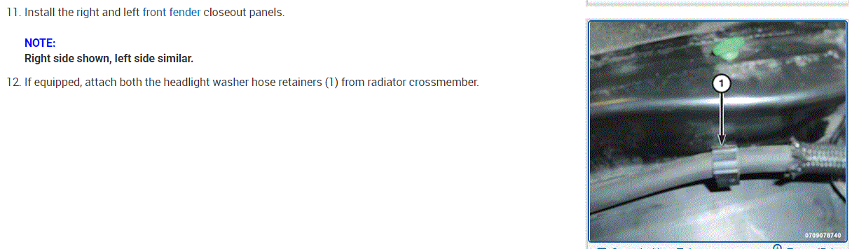

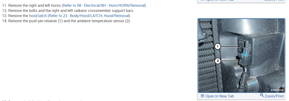

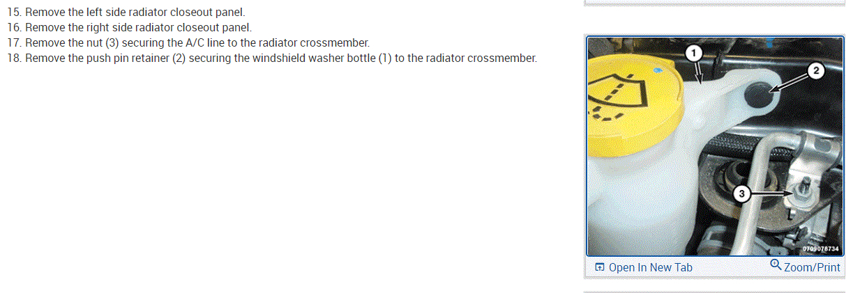

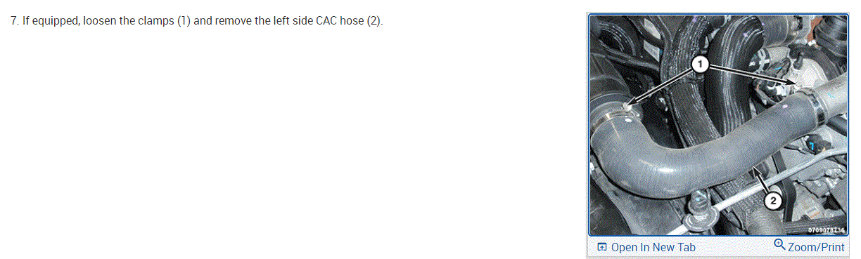

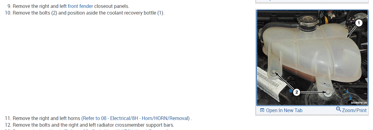

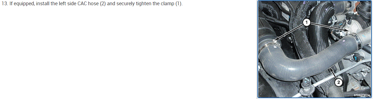

You will need to remove the radiator cross member first. If you look at the attached pics below, they include the directions and pictures specific to this vehicle for replacement. I will need to include the crossmember directs separately. I will start with crossmember removal, then the radiator removal and replacement, then crossmember replacement.
I hope this helps. Let me know if you have other questions and how things turn out for you.
