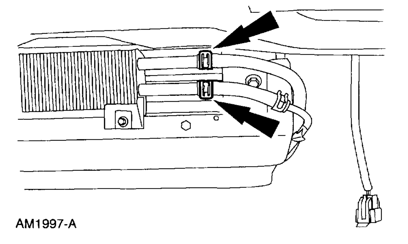

I have a leak on my am I radiator and I would like to know if I could use J-B Weld to temporarily take care of the problem until I get the money for you regular radiator thank you
Feb 3, 2021 at 2:29 AM
Good afternoon,
Depends on where the leak is located.
https://www.2carpros.com/articles/how-to-replace-a-car-radiator
https://www.2carpros.com/articles/car-is-leaking-coolant
Can you upload a picture for me of the area?

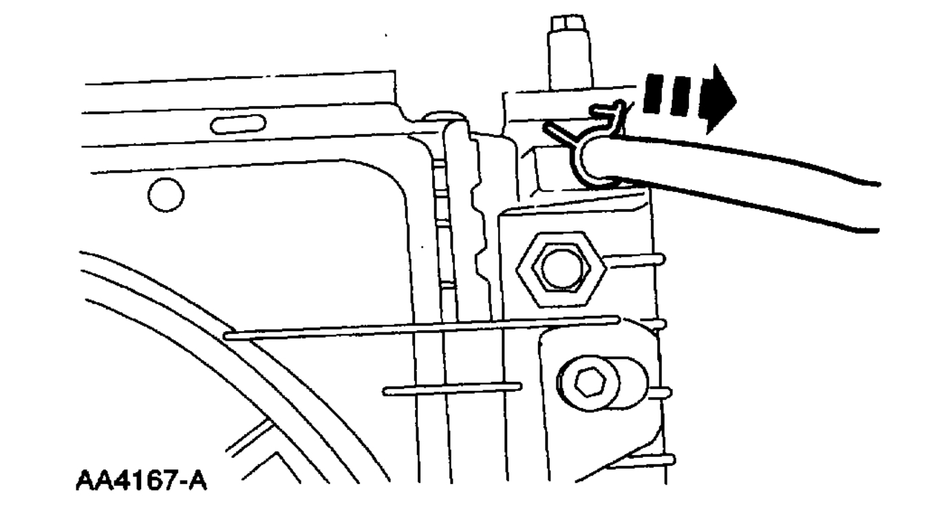

1. Disconnect the battery ground cable.
2. Drain the cooling system.

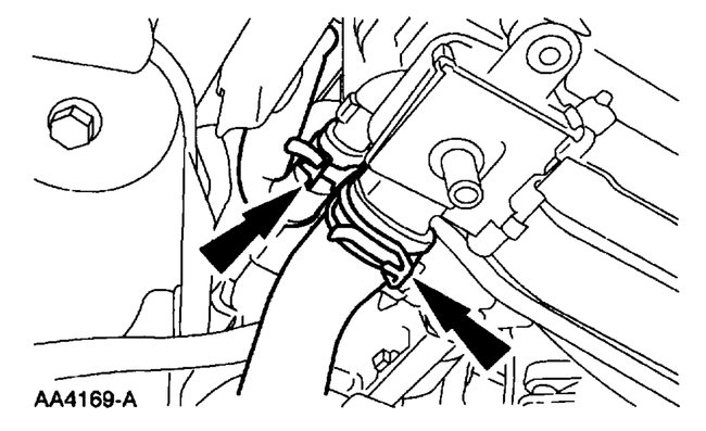

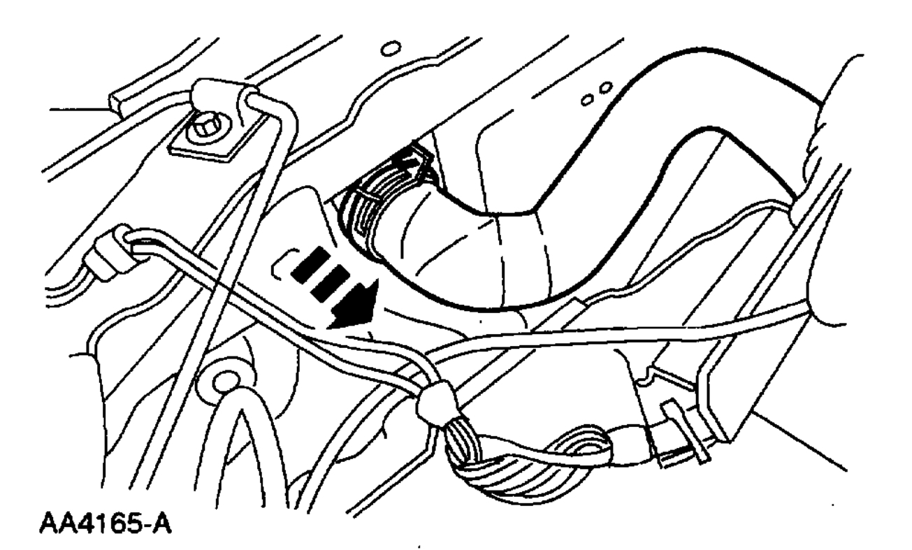

3. Disconnect the upper radiator hose from the radiator.

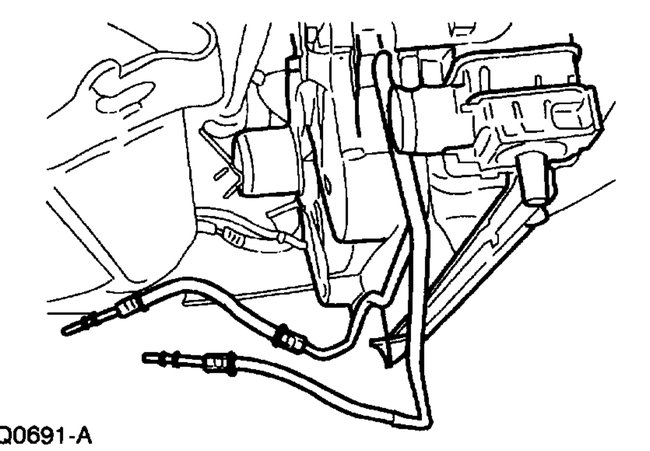

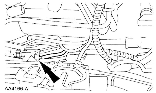

4. Disconnect the electrical connectors and the harness.

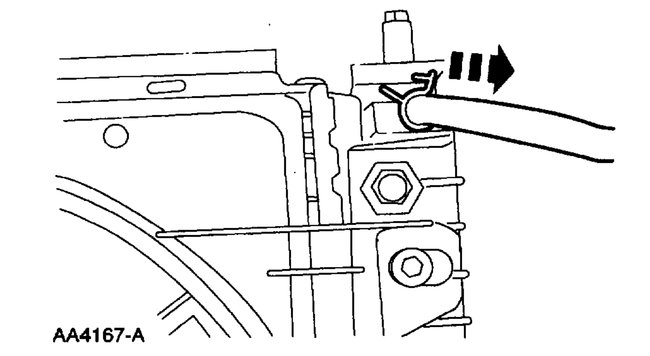

5. Disconnect the radiator vent hose from the radiator.
6. NOTE: A/C condenser must be secured.

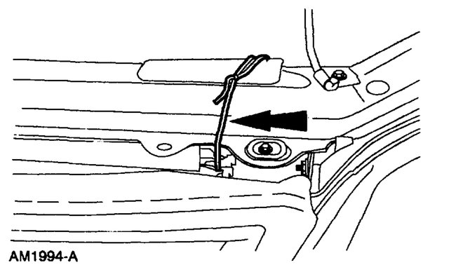

Tie the A/C condenser to the upper radiator support.

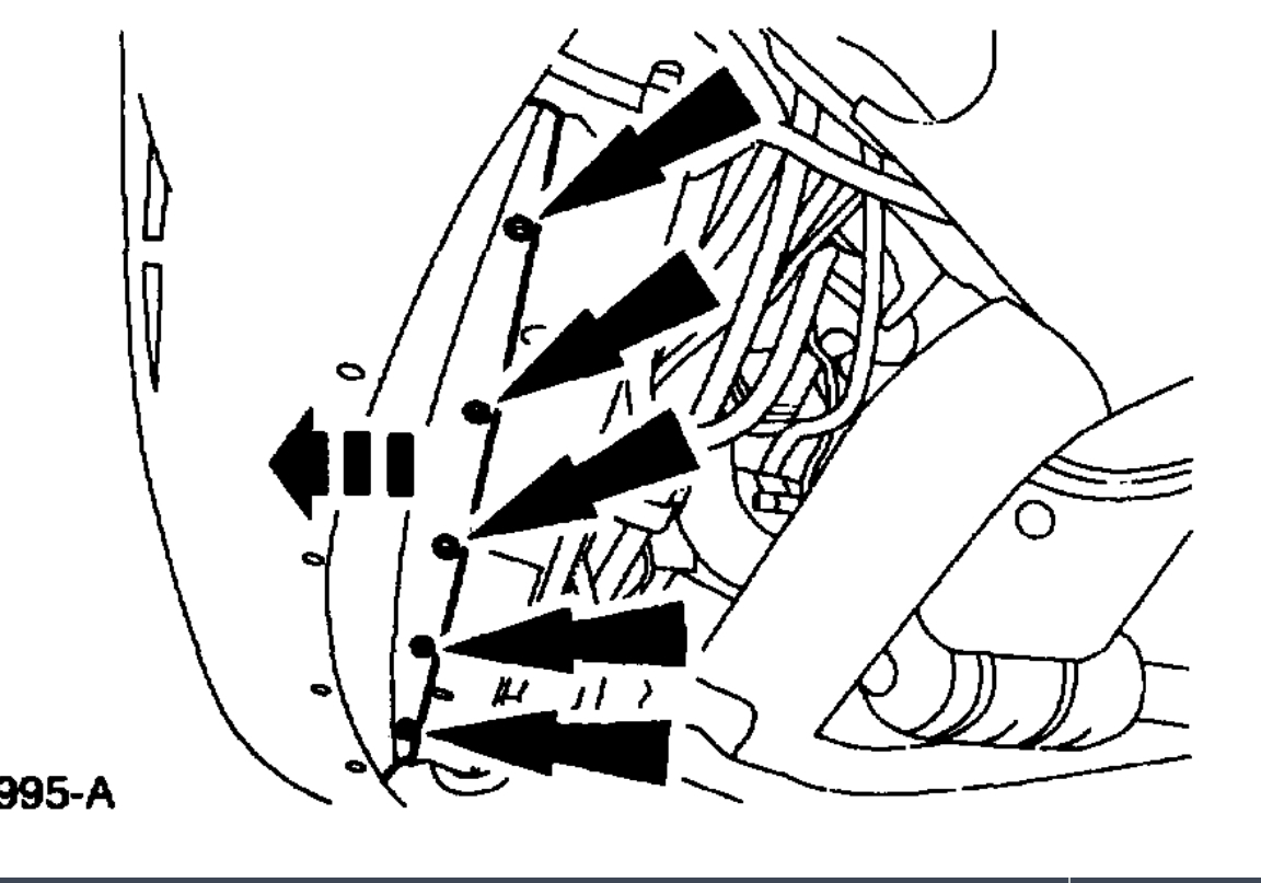

7. Raise and support the vehicle.

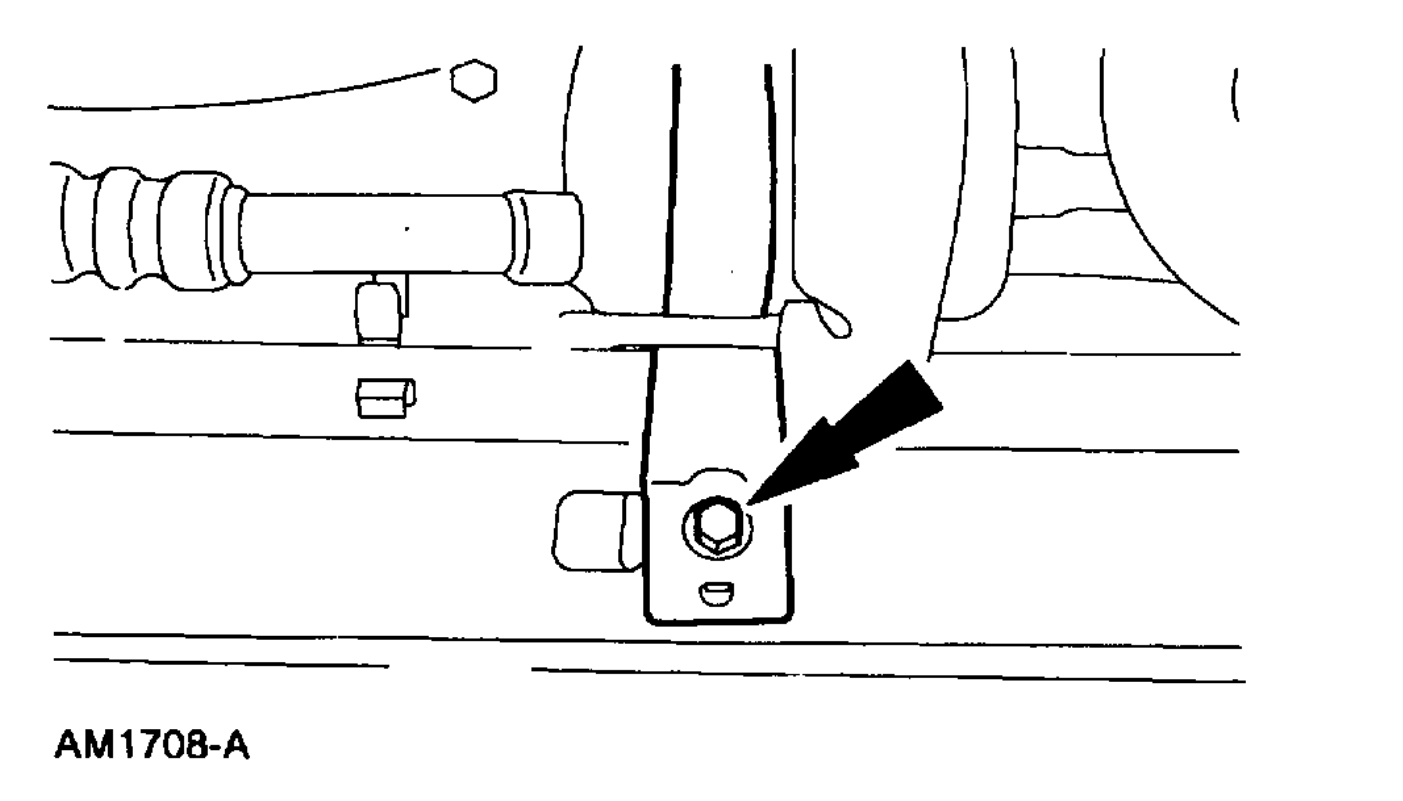

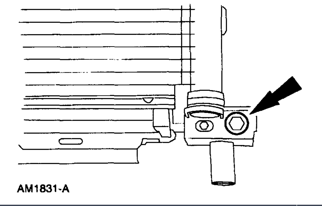

8. Remove the five screws to access the A/C condenser bolts.
9. Remove the bolts from the A/C condenser.
10. Remove the bolt and position the A/C muffler bracket out of the way.

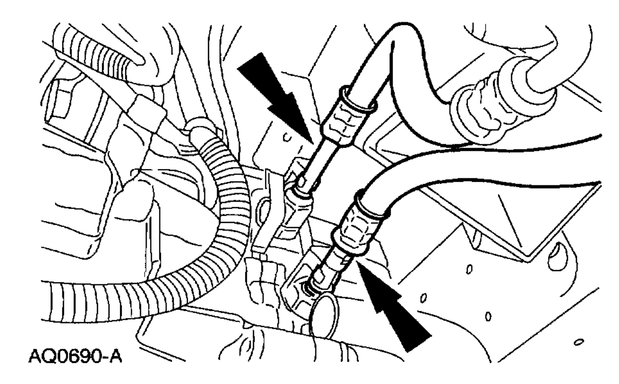

11. Disconnect the lower radiator hose and the degas bottle supply hose from the radiator.

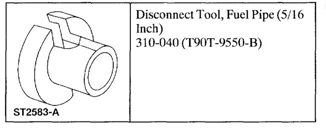

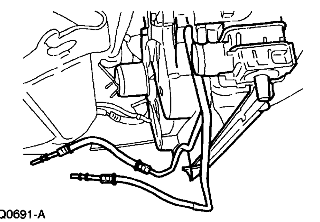

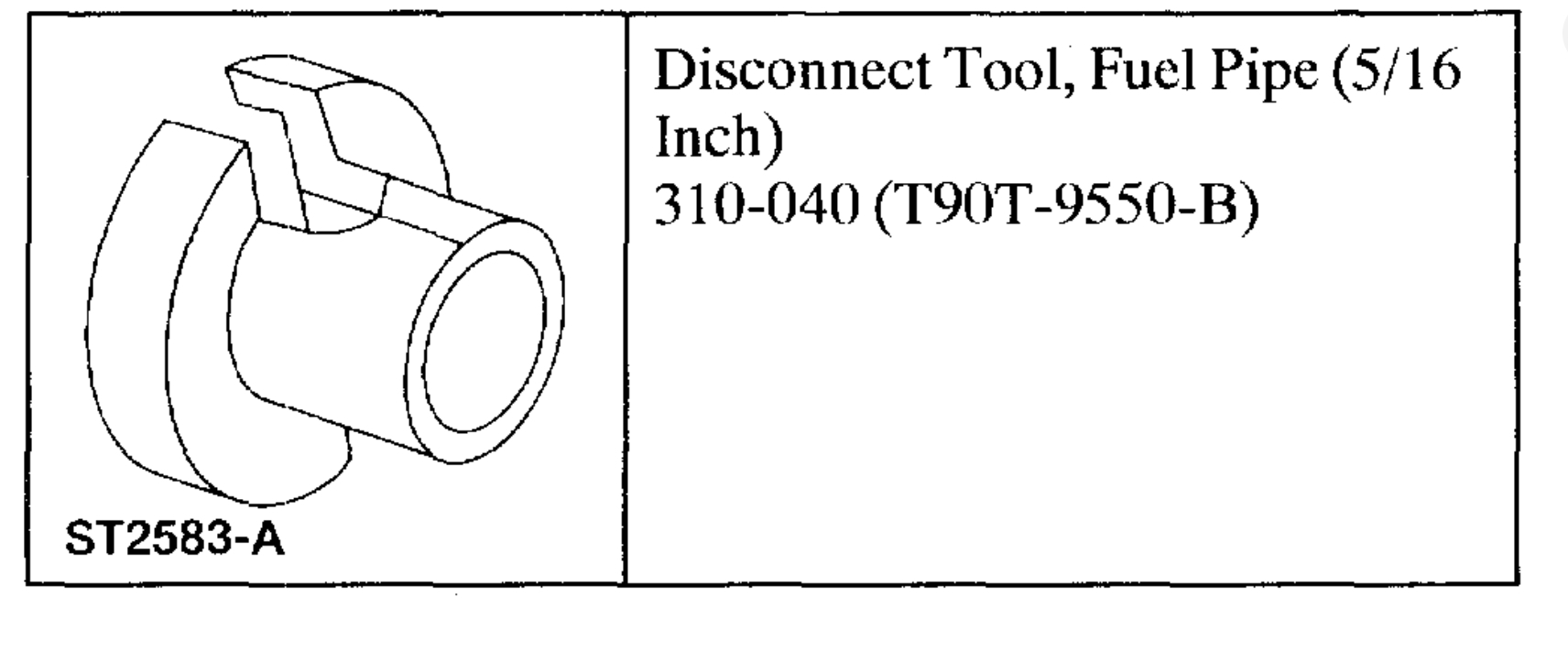

12. Using the special tool, disconnect the transmission cooler tubes from the transmission.

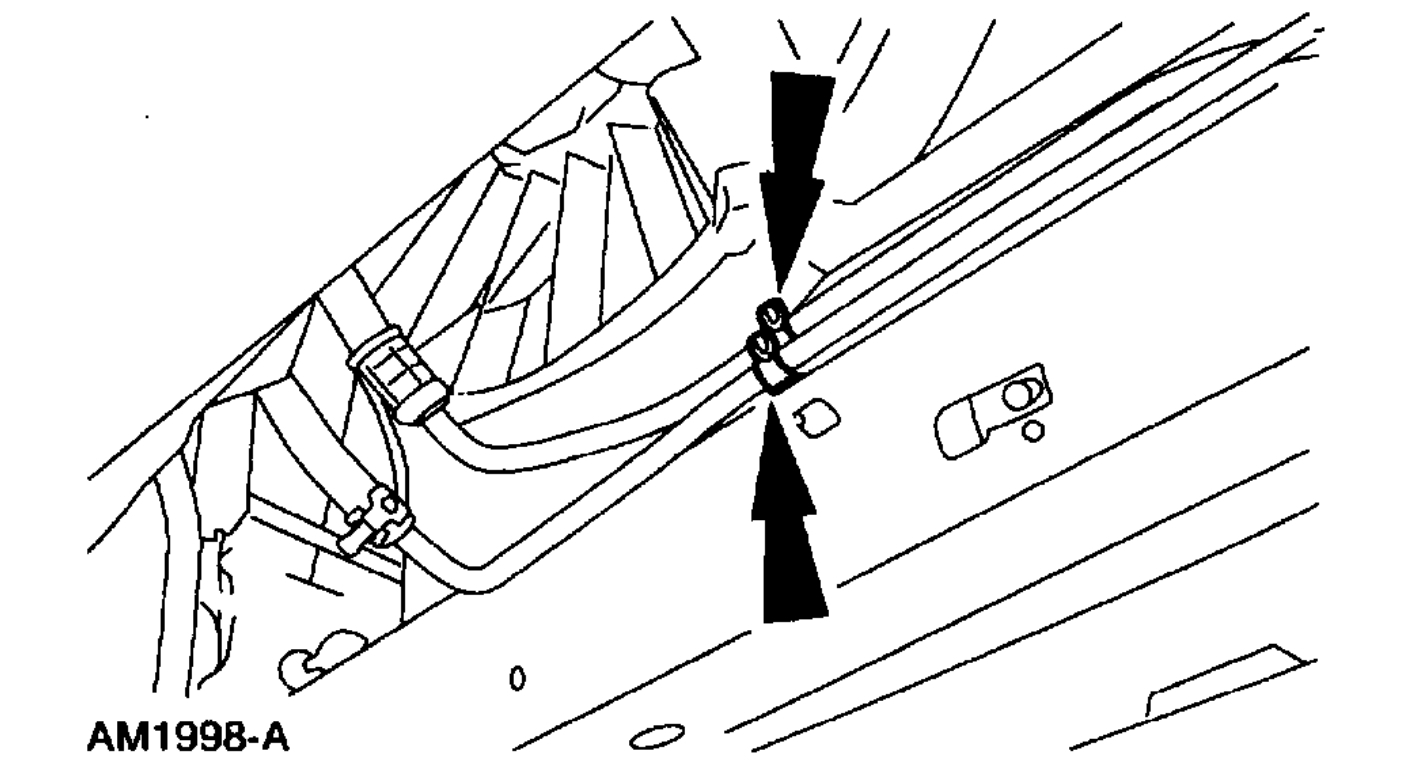

13. Unclip the transmission cooler tubes from the lower radiator support.
14. Disconnect the auxiliary cooler tubes.

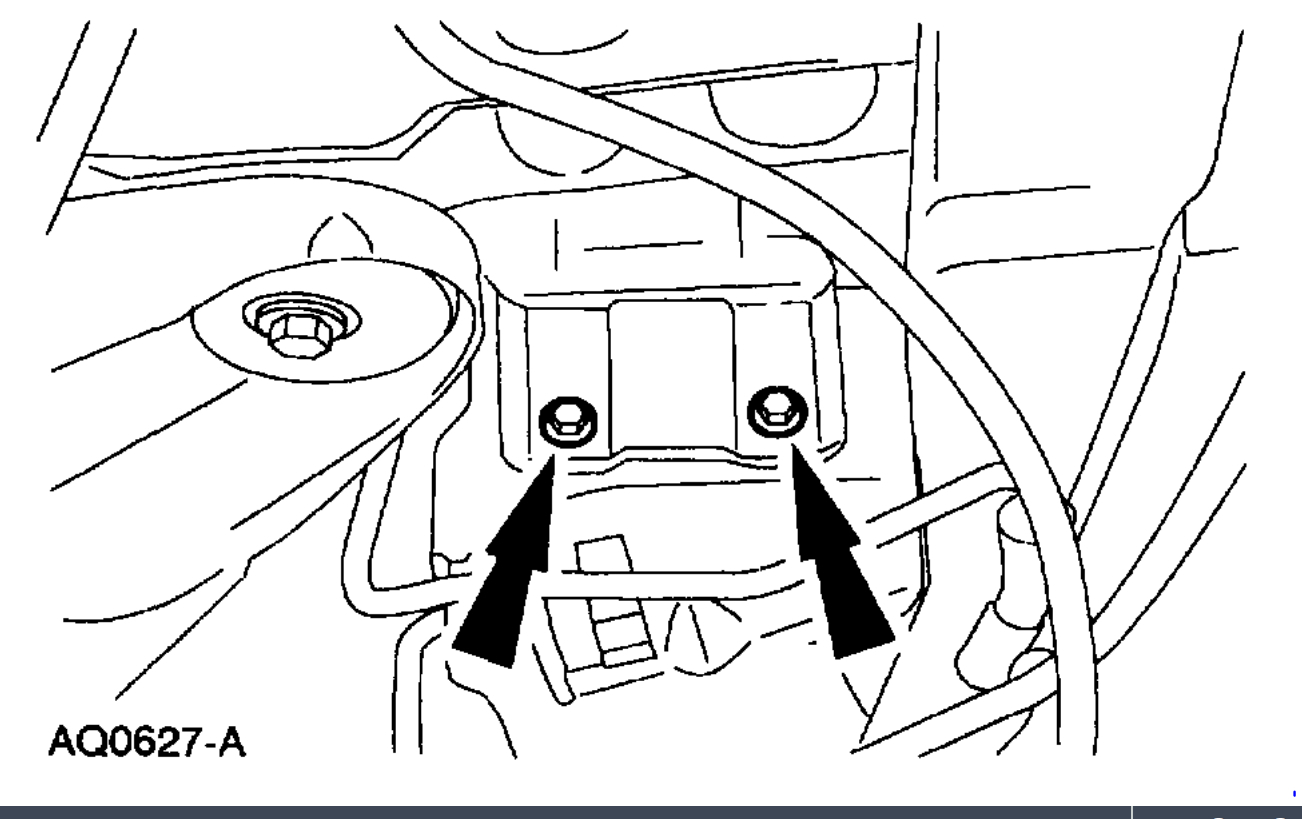

15. Remove the four bolts and the radiator support.

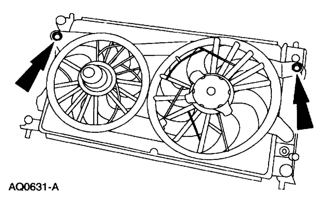

16. Remove the radiator, fan and fan shroud assembly.
17. Disconnect the transmission tubes from the radiator.

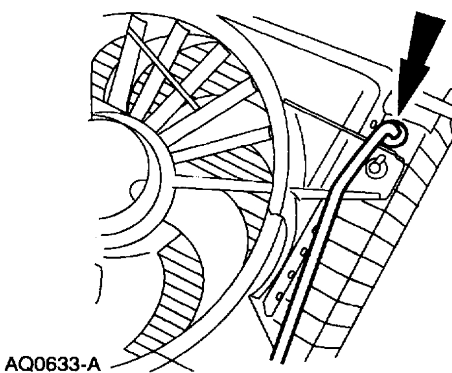

18. Remove the bolts the fan and the shroud assembly from the radiator.

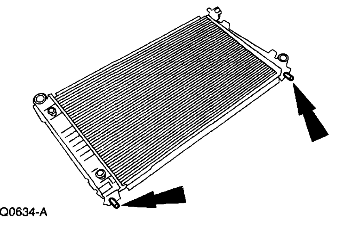

19. Remove the radiator guide pins.
