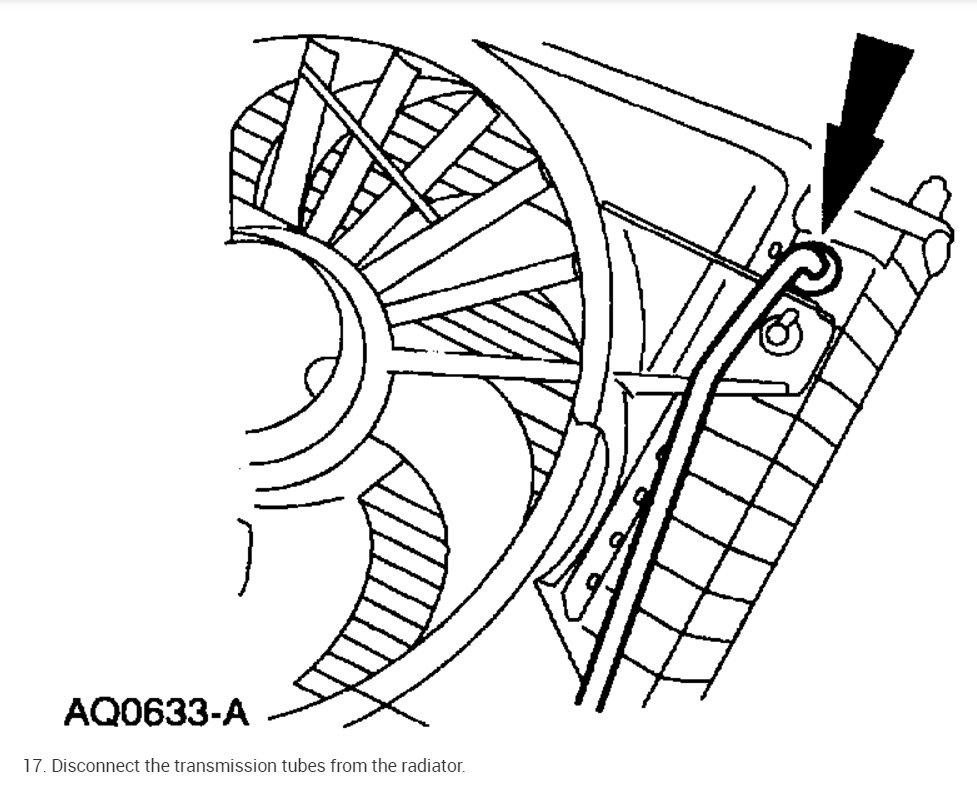

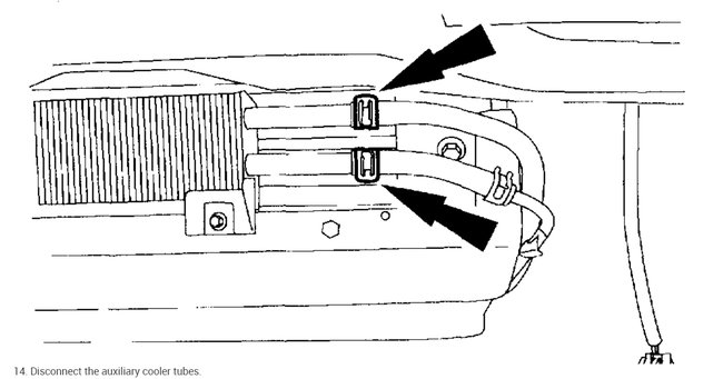

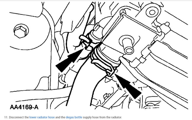

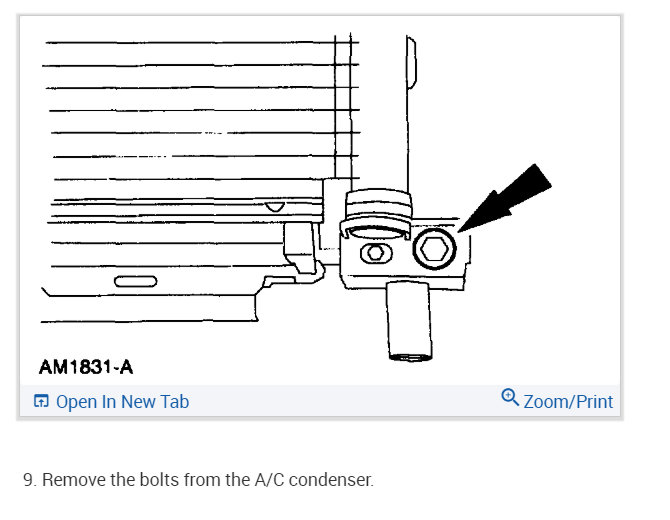

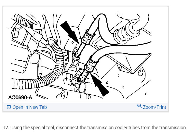

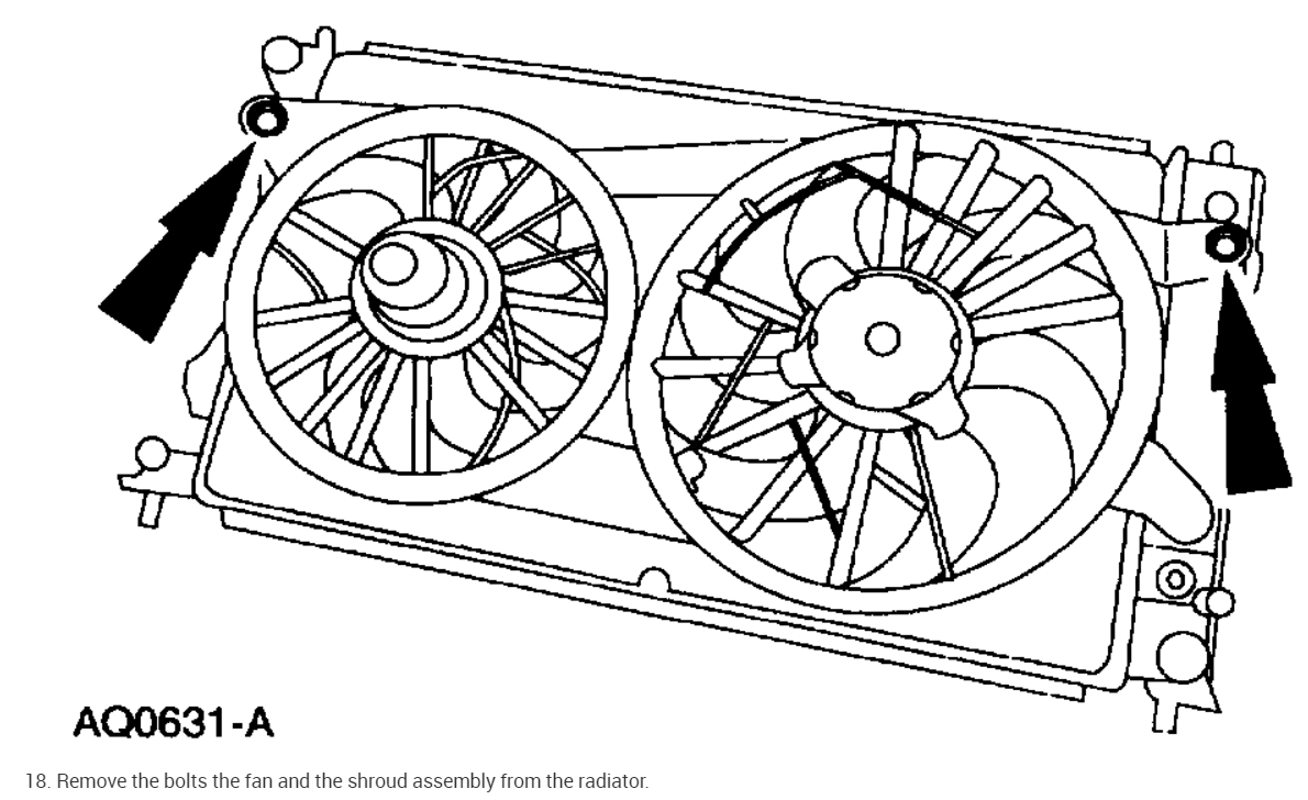

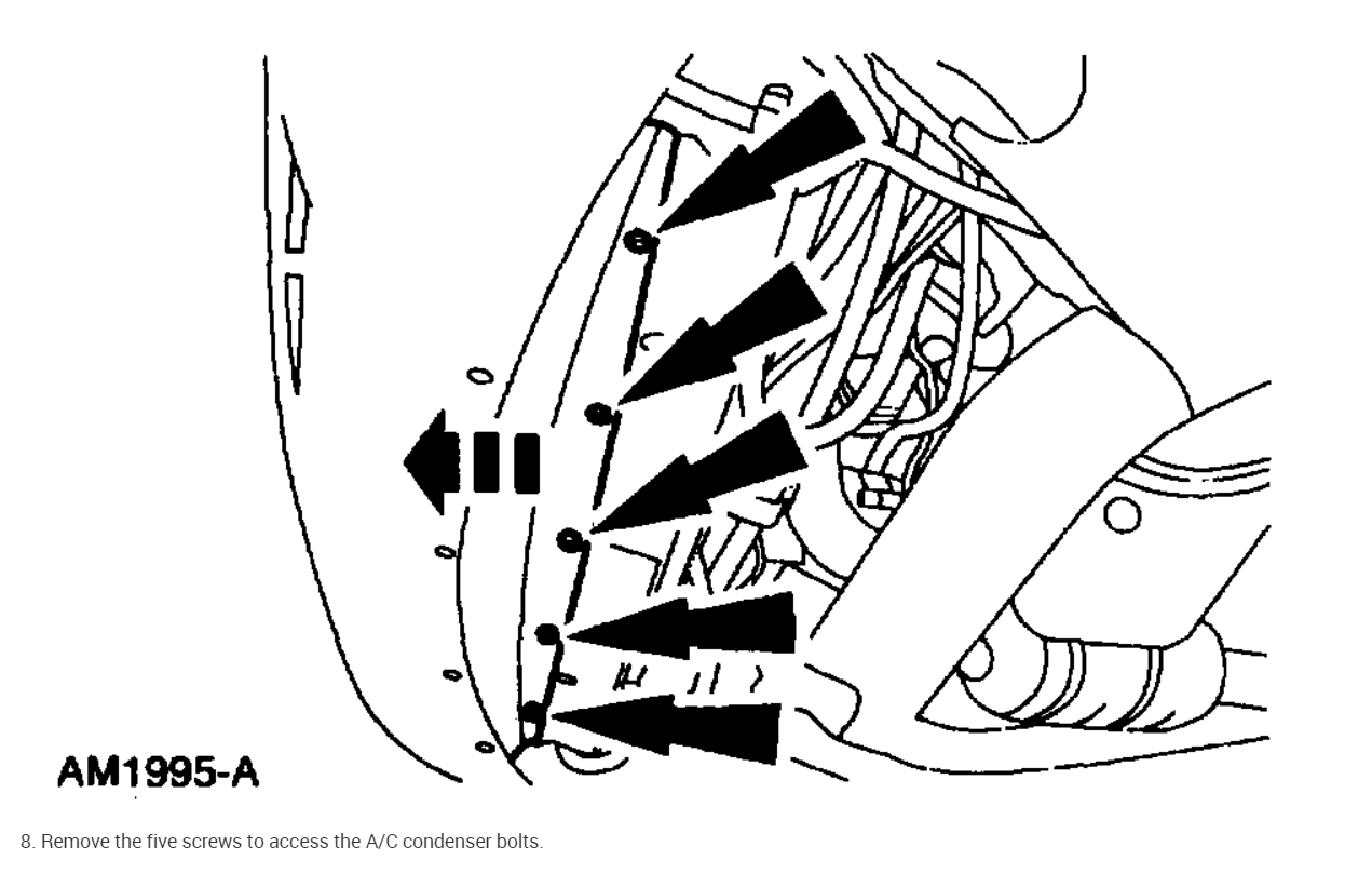

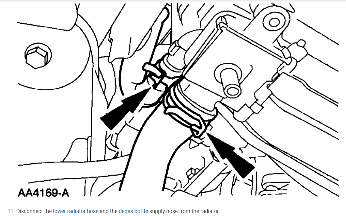

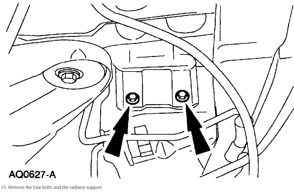

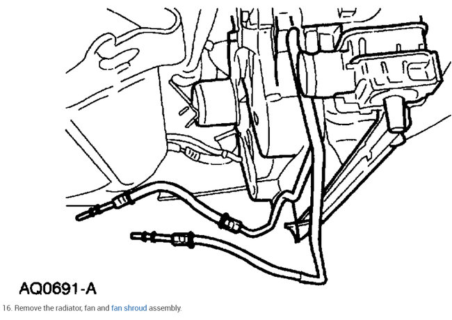

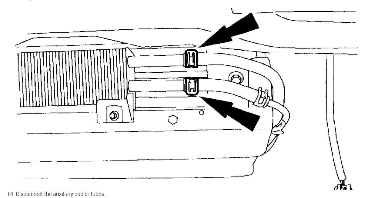

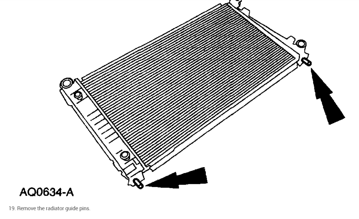

How to remove the radiator?
Tuesday, November 24th, 2009 AT 11:36 AM
BLUELIGHTNIN6
MECHANIC
16,542 POSTS
Here is a guide to help walk you through the steps of doing the job with instructions and diagrams below to show you how to do the job on your car.
https://www.2carpros.com/articles/how-to-replace-a-car-radiator
Images (Click to make bigger)
