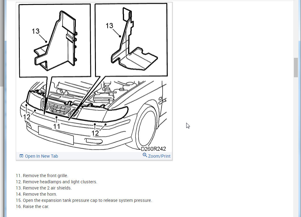

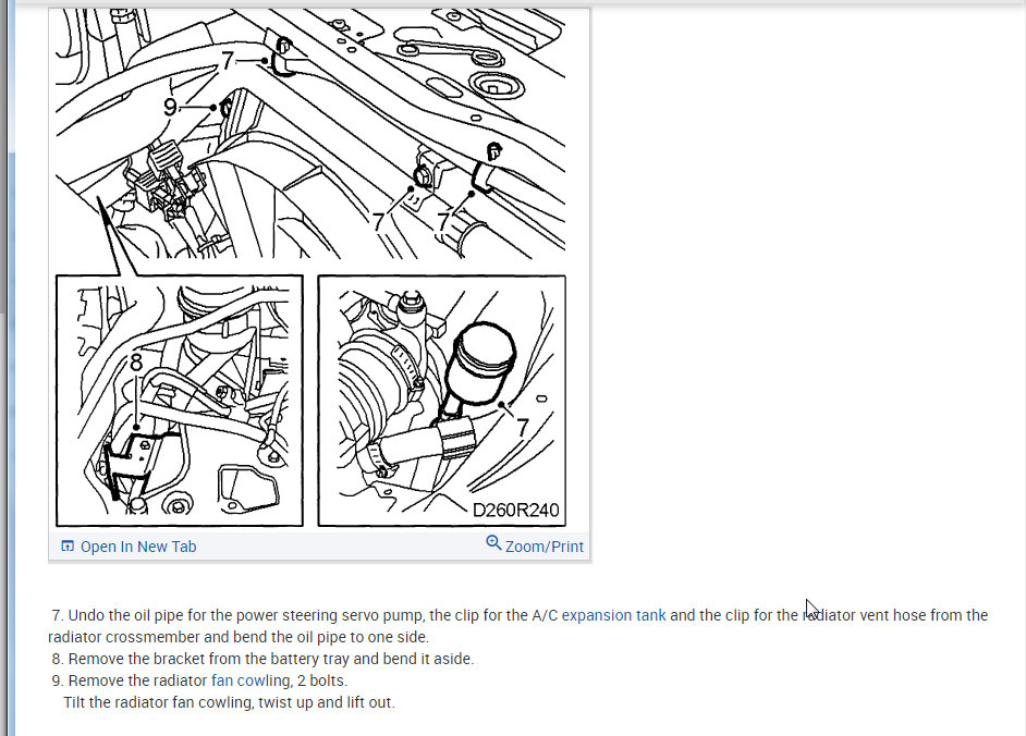

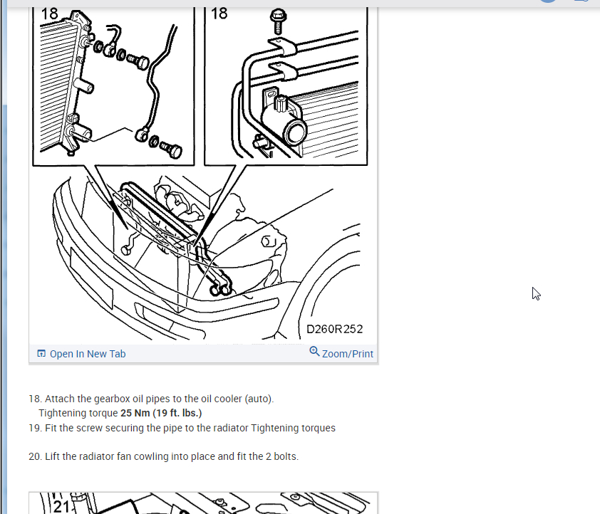

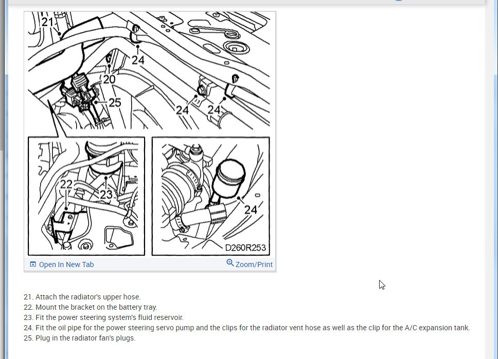

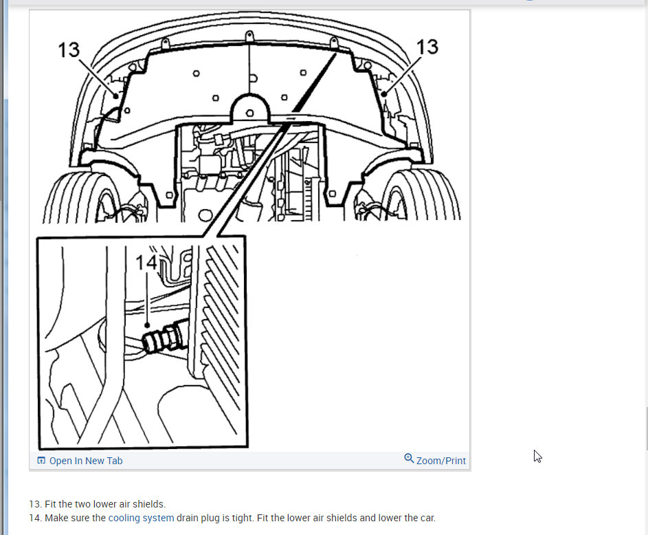

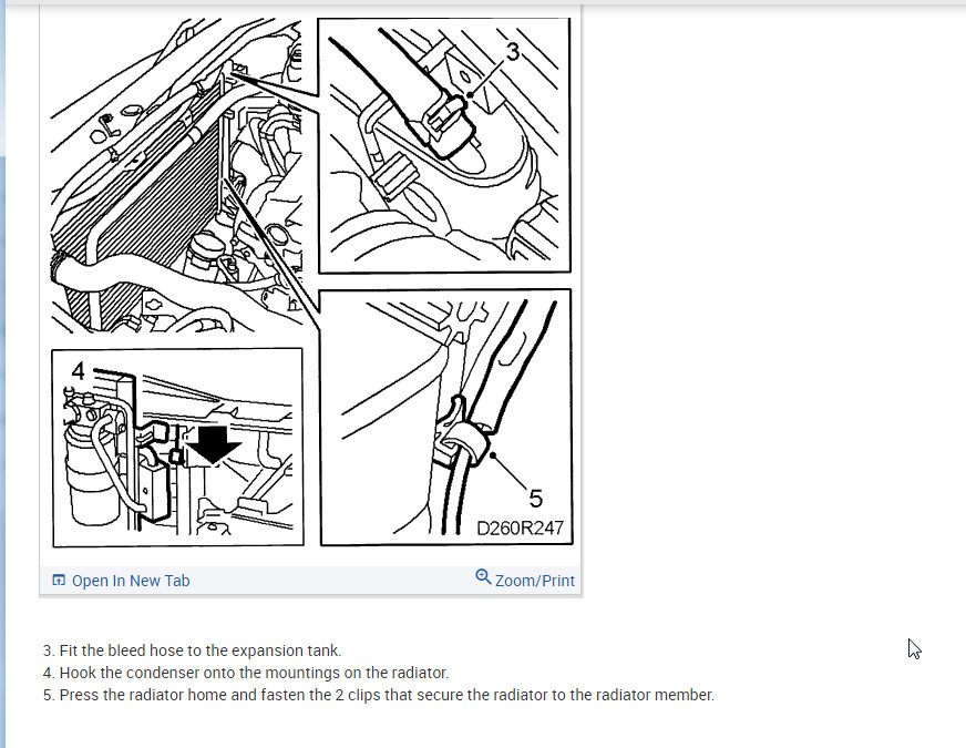

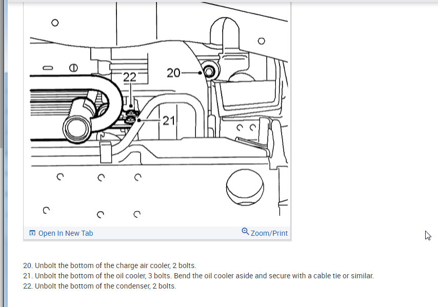

How to remove and replace radiator?
May 14, 2021 at 12:15 AM
Experienced Mechanic
18,907 POSTS

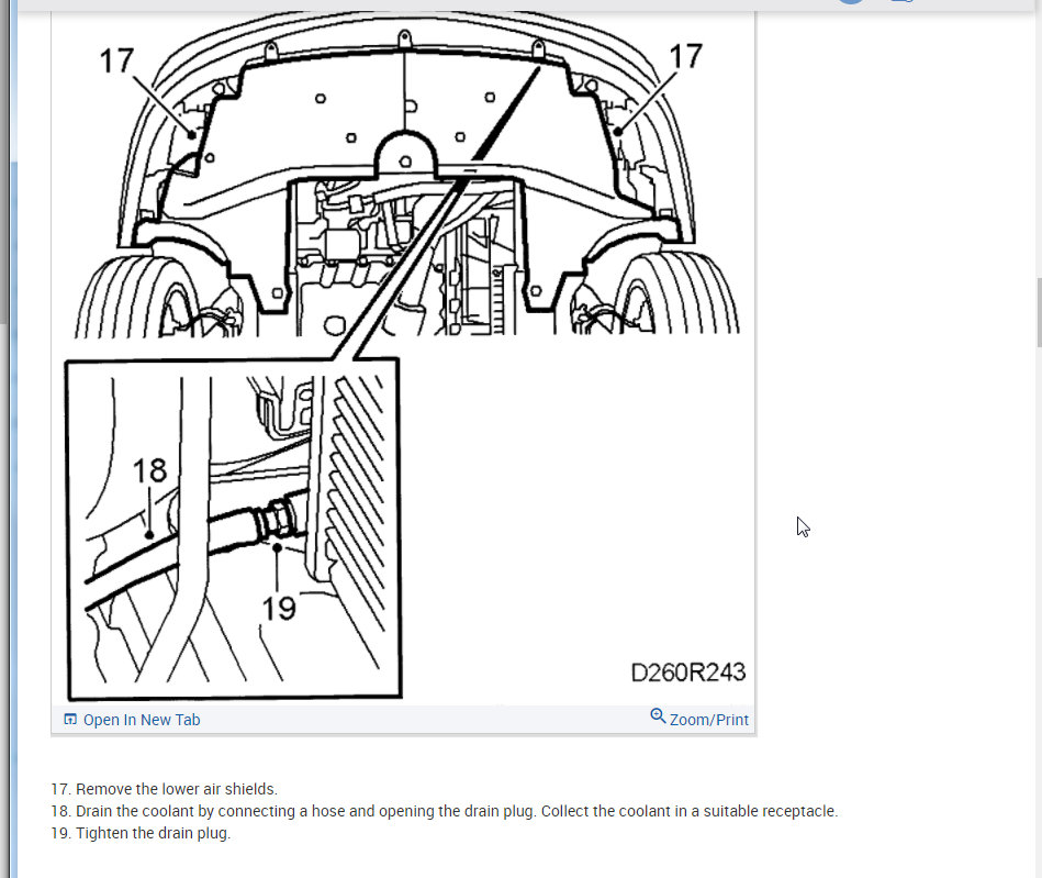

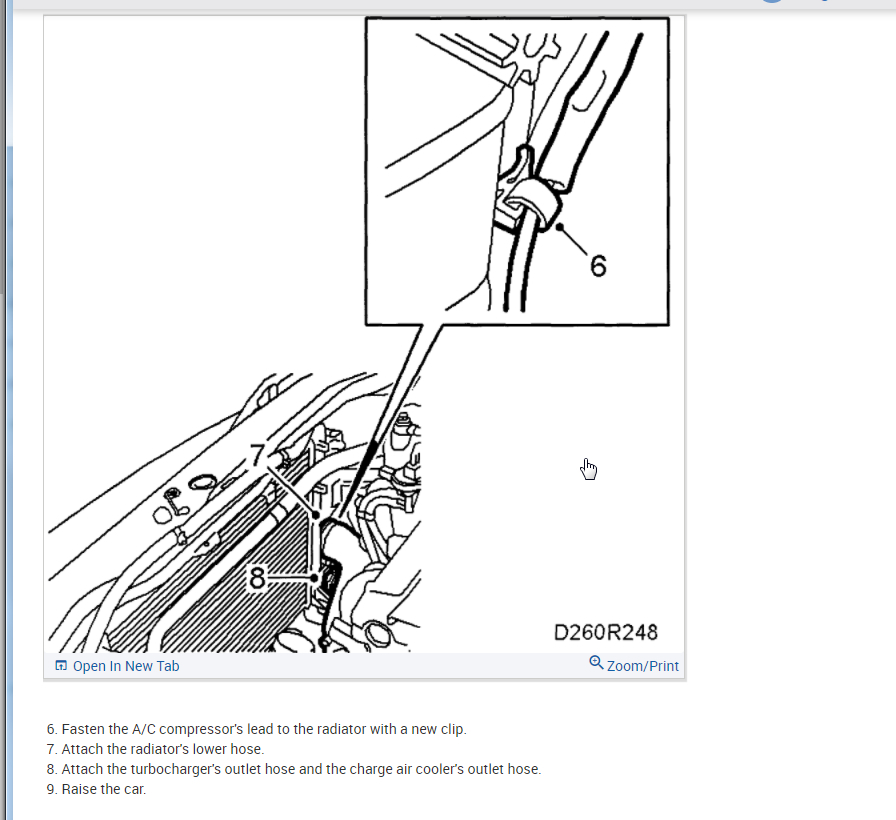

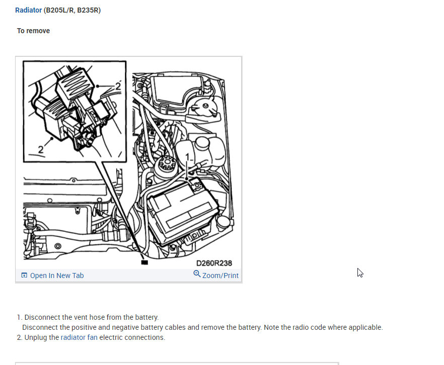

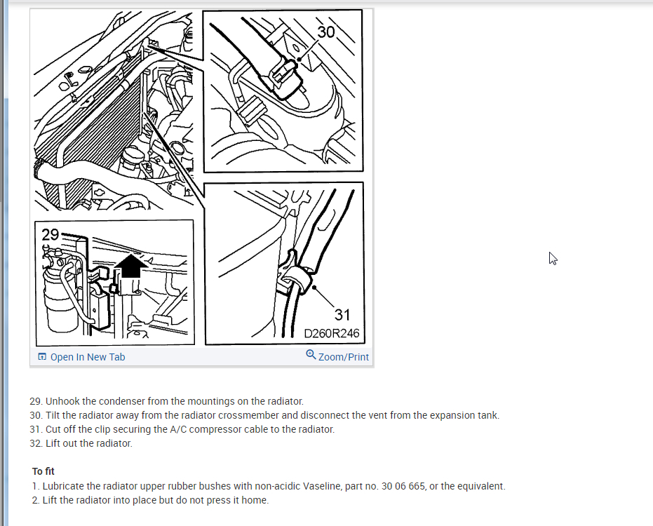

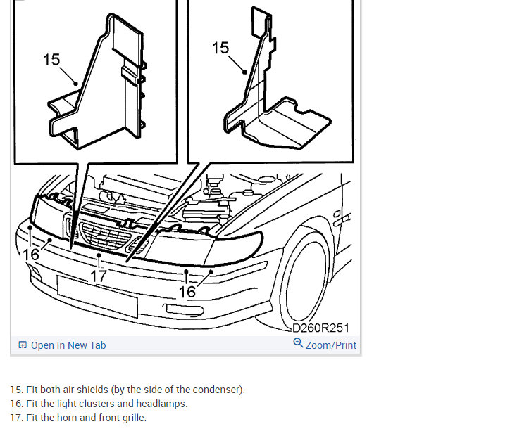

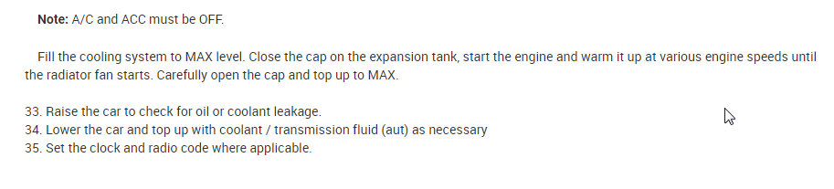

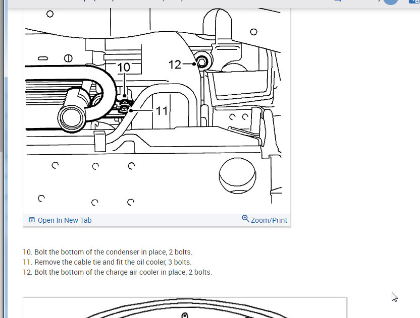

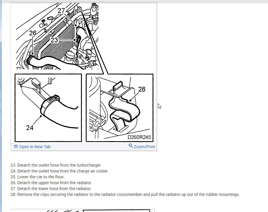

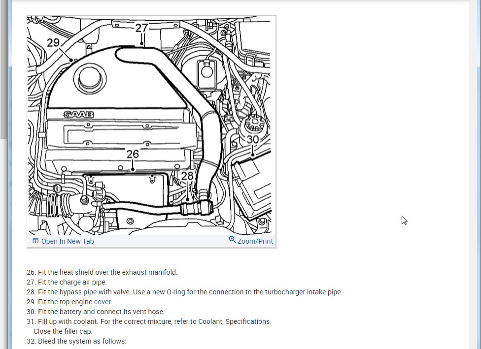

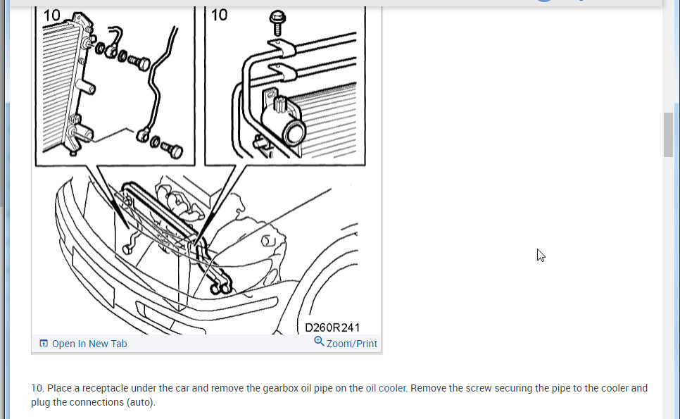

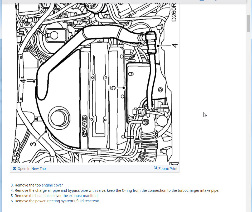

Here is a guide that will help with this:
https://www.2carpros.com/articles/how-to-replace-a-car-radiator
Below is the process from the manual on how to replace this as well.
Please let us know what questions you have and we can go from there. Thanks
