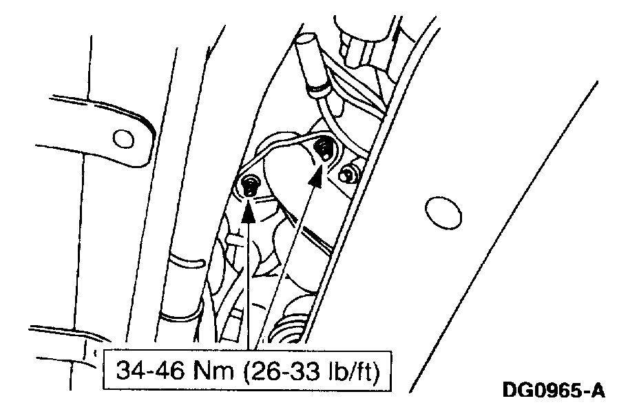

What tools needed to replace rack and pinion? How do I do it?
Jun 22, 2019 at 11:34 AM
  • 110,194 POSTS
Welcome to 2CarPros.
On this vehicle, this is a big job. Many tools will be required. Unfortunately we don't have sizes of tools, sockets, or bolts as they are not included in the manual. Basically they leave that to the tech to figure out the best tool for the job. Not all are going to have the same tools so they don't try to list that. Most all these jobs can be done with hand tools like socket sets and wrenches but it will just take longer.
Here are the directions for removal and replacement. All of the pictures correlate with the directions.
_______________________________________________________
REMOVAL AND INSTALLATION

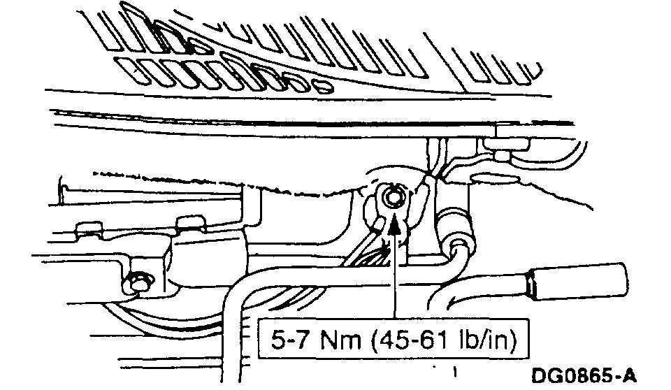

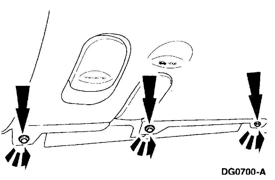

1. Remove the instrument panel lower trim cover.
pic 3
2. Remove the steering column lower trim panel.

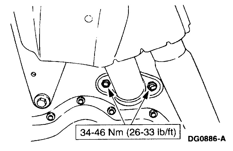

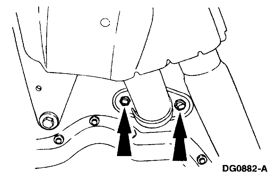

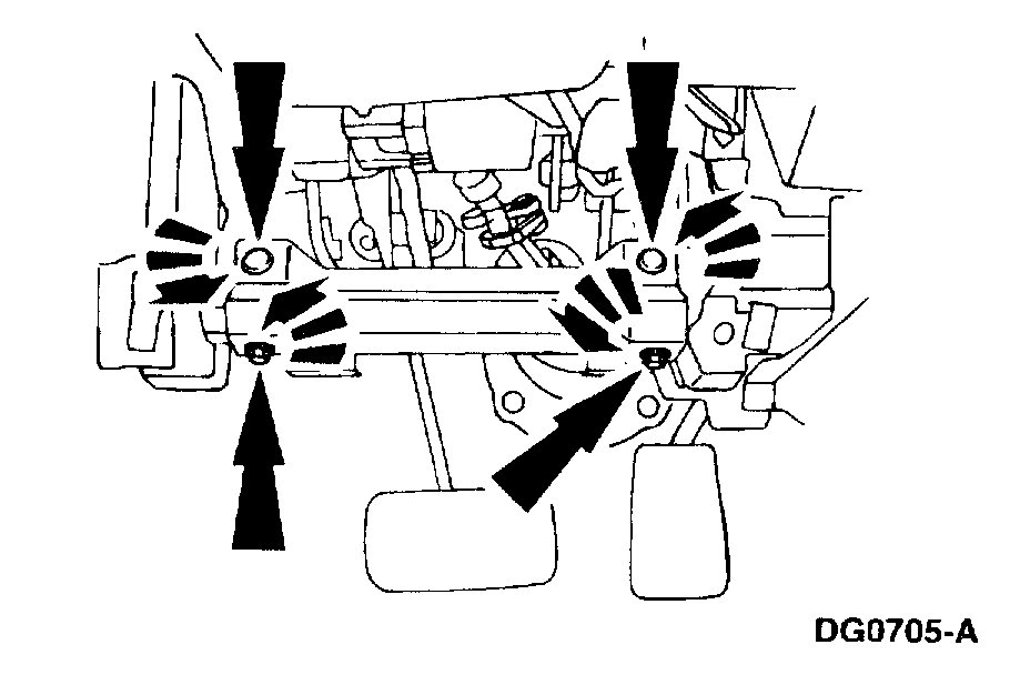

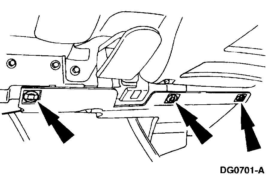

3. Remove the steering column reinforcement panel.
pic 5

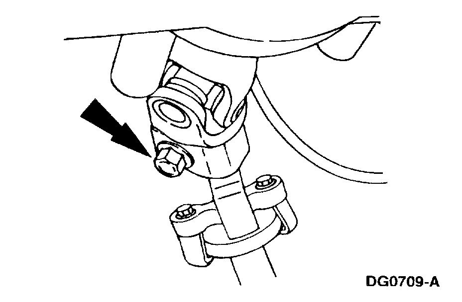

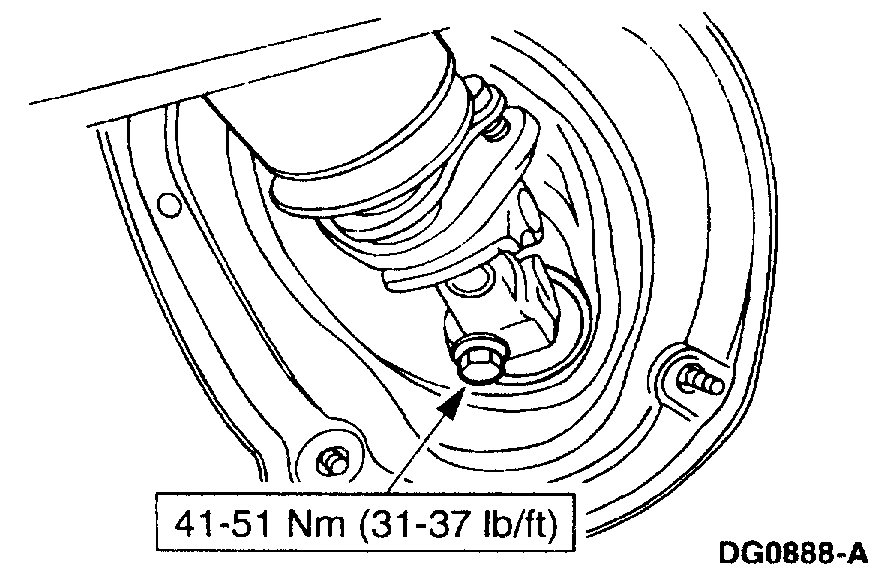

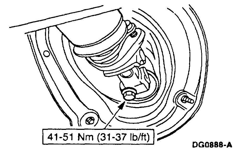

4. Remove the universal joint pinch bolt.
pic 6

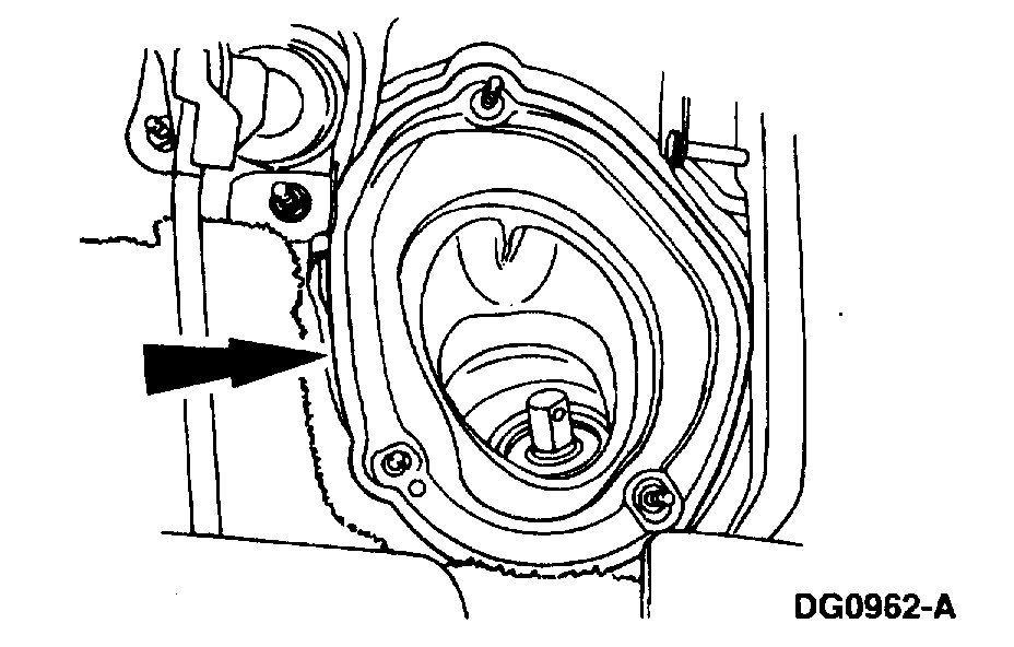

5. CAUTION: Do not rotate the steering wheel when the lower steering column shaft is disconnected, or damage to the air bag sliding contact will result.
Remove the bolt at the intermediate shaft-to-steering gear coupling. Slide the shaft upward to remove from the steering gear.
6. Slide the intermediate shaft downward to remove from the steering column.
pic 7
7. Remove the steering column opening weather seal.

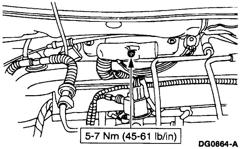

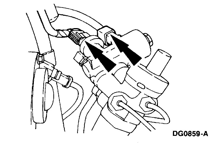

8. Loosen the retaining screw, and disconnect the engine compartment wiring harness.
pic 9

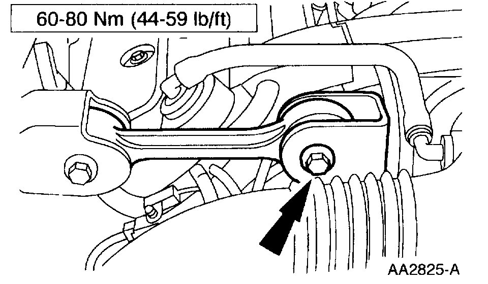

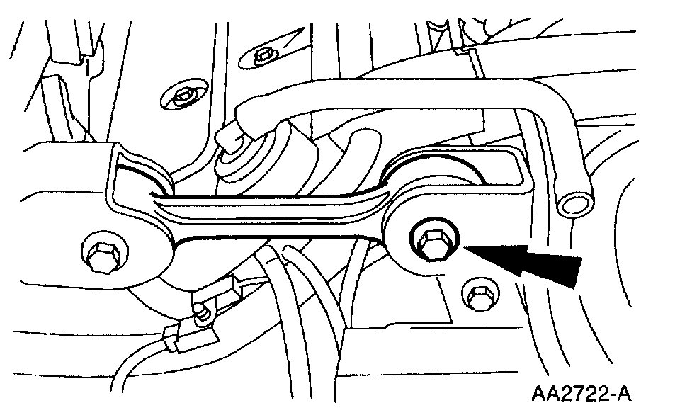

9. Remove the bolt and position the upper motor mount out of the way.
pic 10

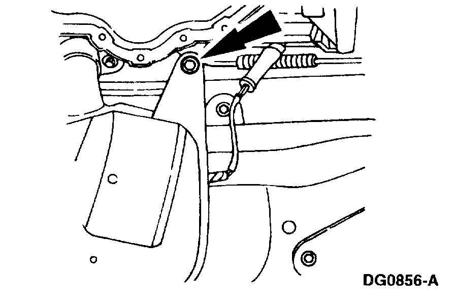

10. Remove the ground strap retaining screw.

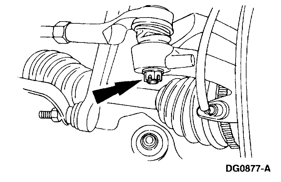

pic 11

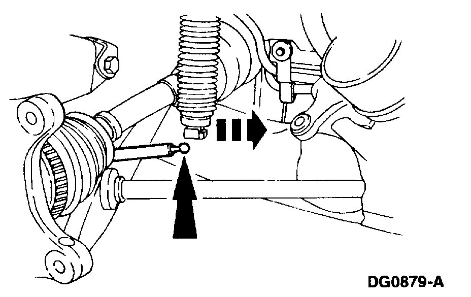

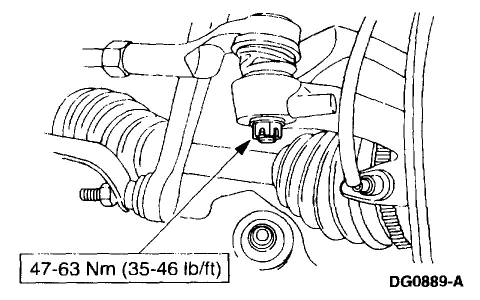

13. Remove the cotter pins and nuts at the tie rod ends.

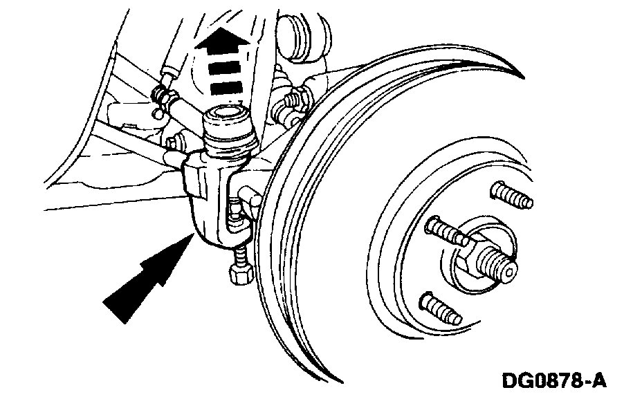

pic 12

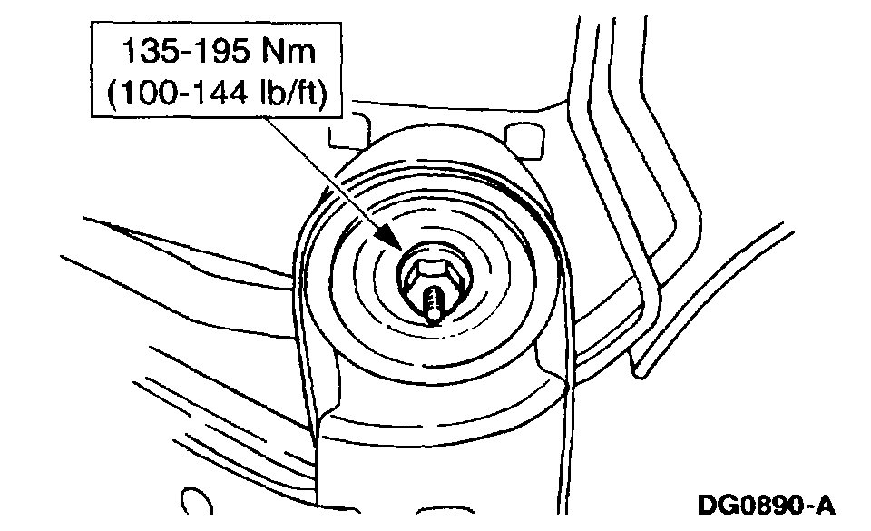

14. Separate the tie rods from the knuckles, using a suitable puller.
pic 13

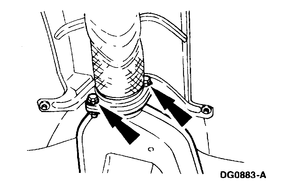

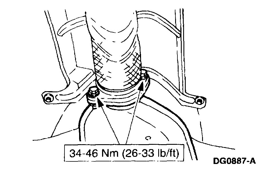

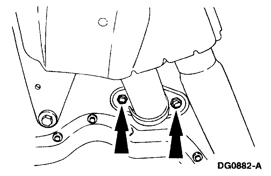

17. Remove the catalytic converter inlet pipe retaining nuts (front).
pic 16
18. Remove the catalytic converter inlet pipe retaining nuts (rear).
pic 17
19. Remove the catalytic converter outlet flange retaining bolts and nuts.
pic 18
20. Remove the support bracket retaining bolt and the catalytic converter.

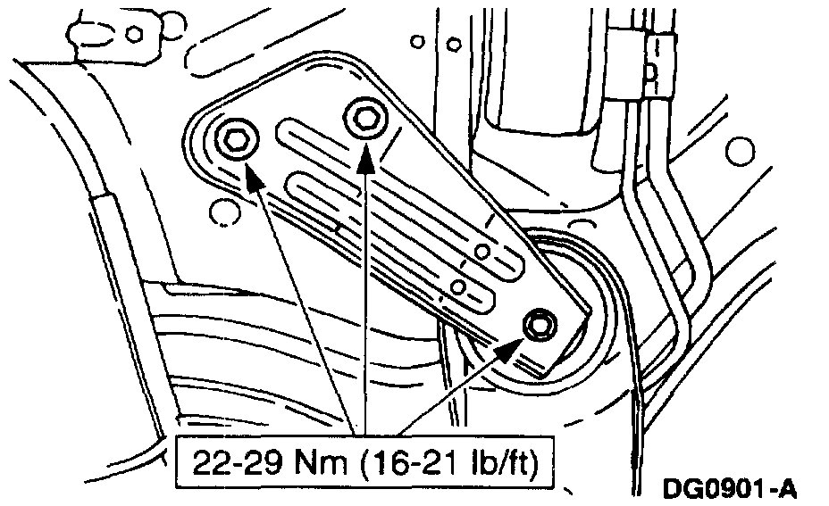

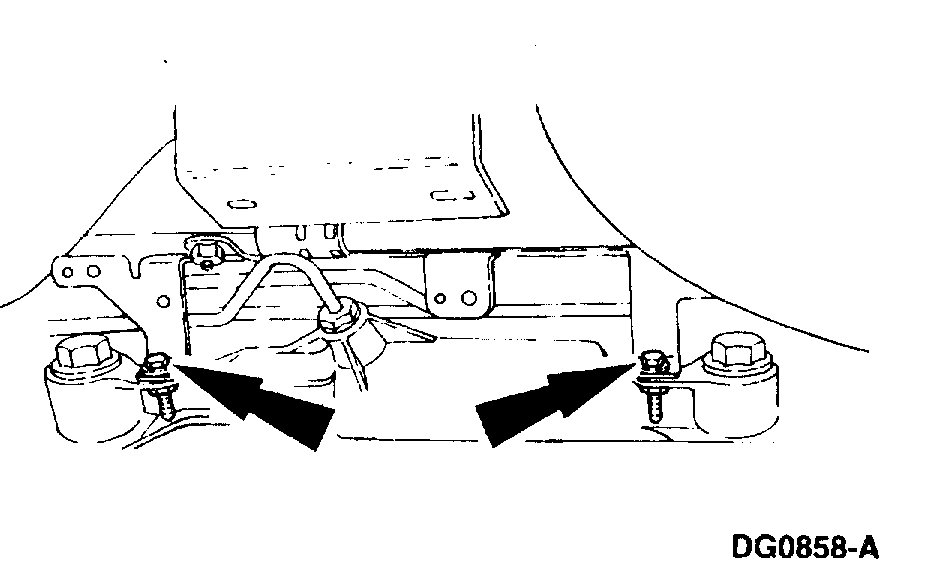

21. Remove the bolts, nuts and subframe insulator braces.
pic 20
22. Remove the steering gear nuts.
23. Support the subframe, using a suitable jack.

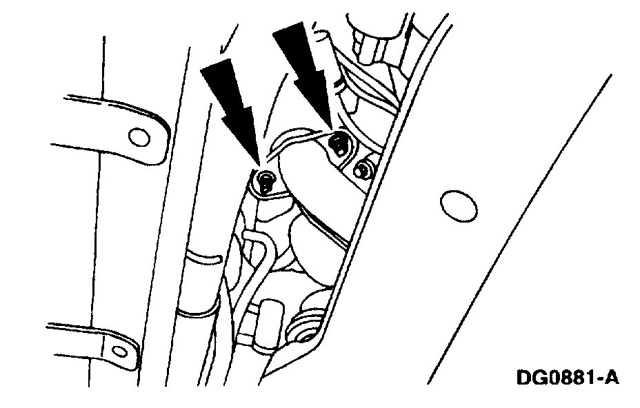

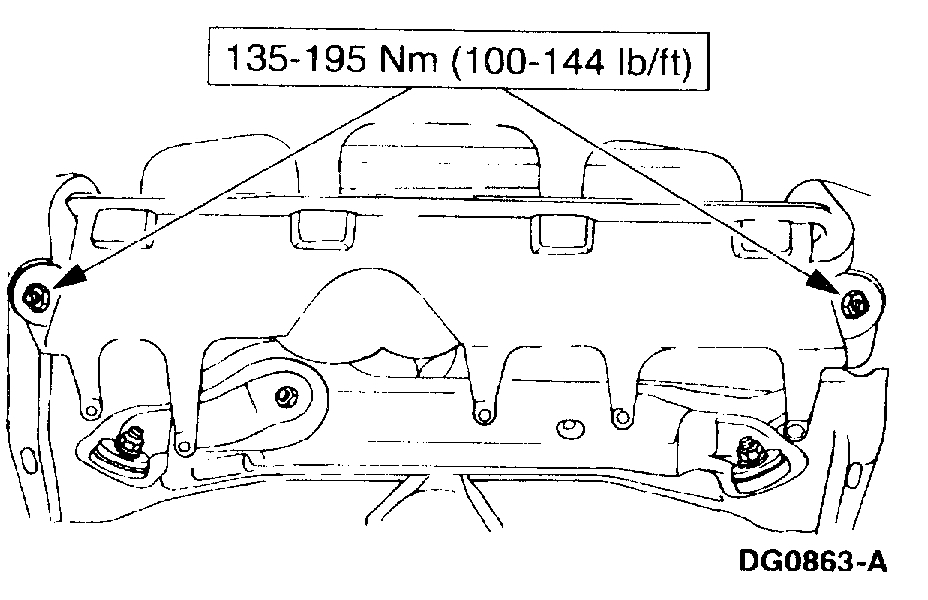

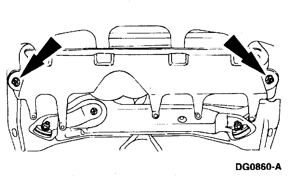

pic 21

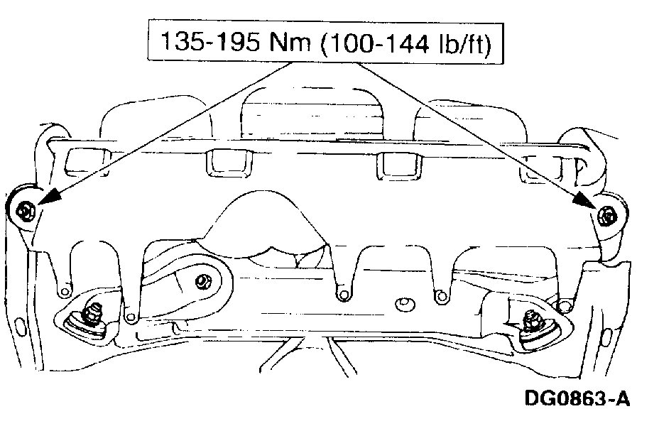

24. Remove the subframe retaining bolts (rear).
pic 22
25. Loosen the subframe bolts (front).
26. Lower the lift.

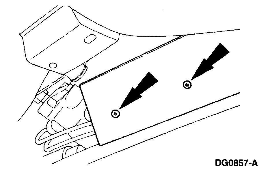

27. Remove the pushpins and the heat shield.
pic 24
28. Remove the screws and the heat shield bracket.

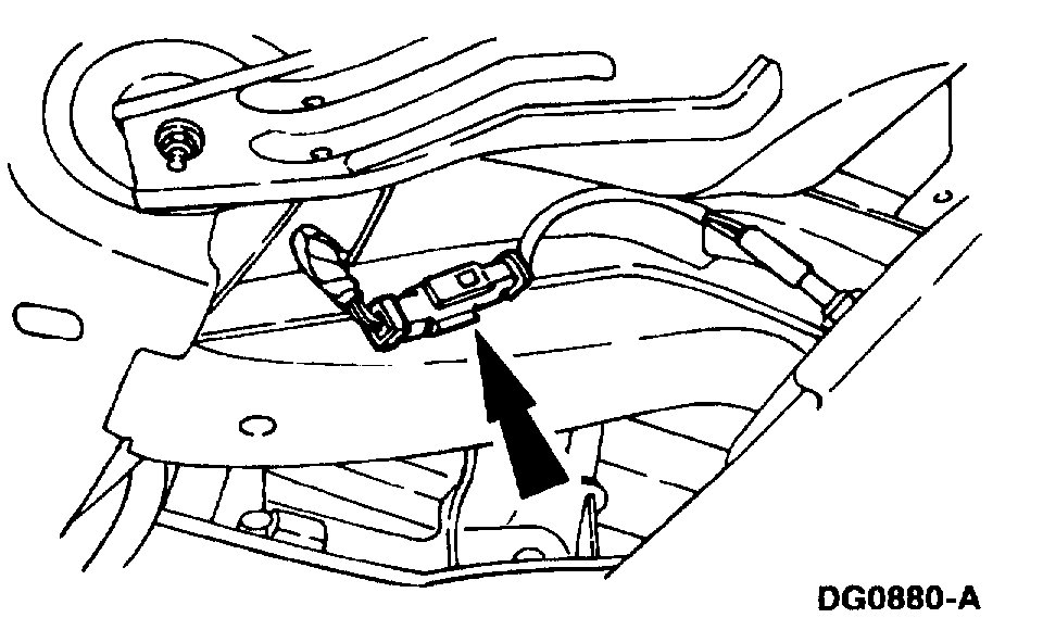

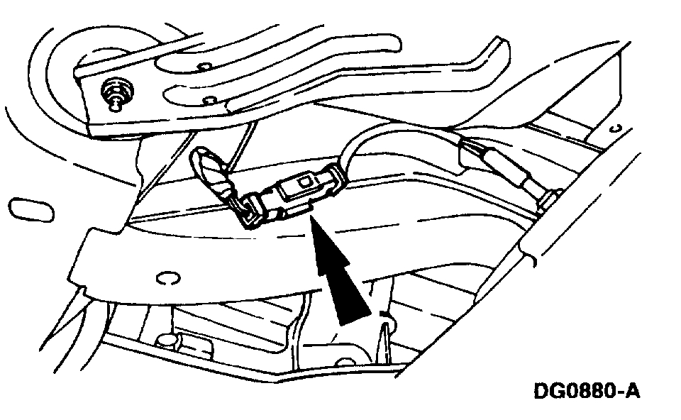

29. Disconnect the wiring at the steering gear.
pic 26

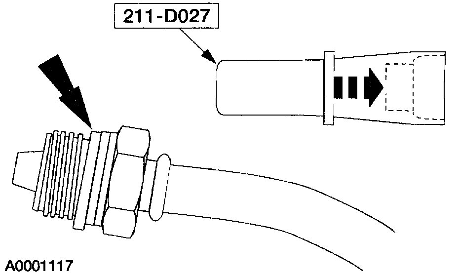

30. Note: The steering gear must be rotated to clear the bolt from subframe and pulled to the left to access the power steering lines.

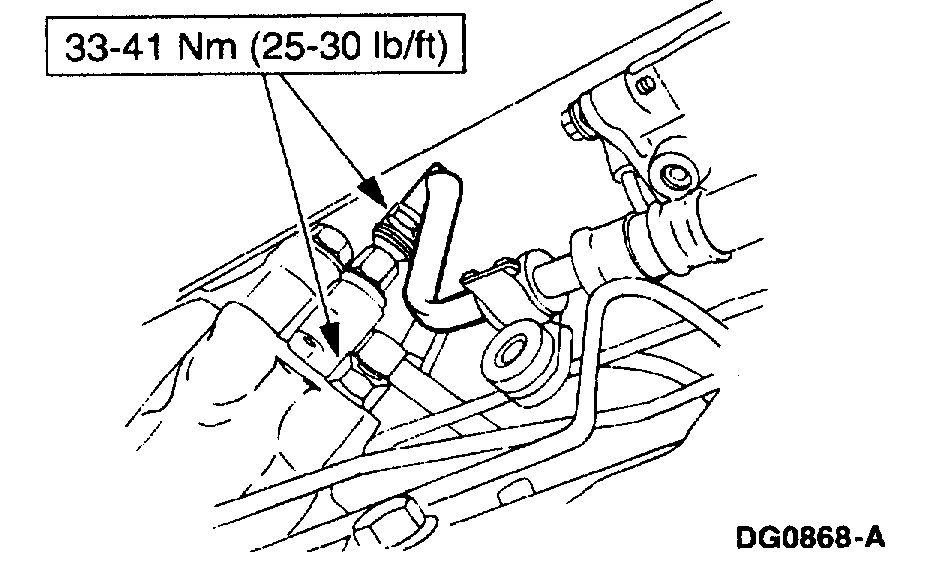

Disconnect the pressure and return lines at the steering gear.

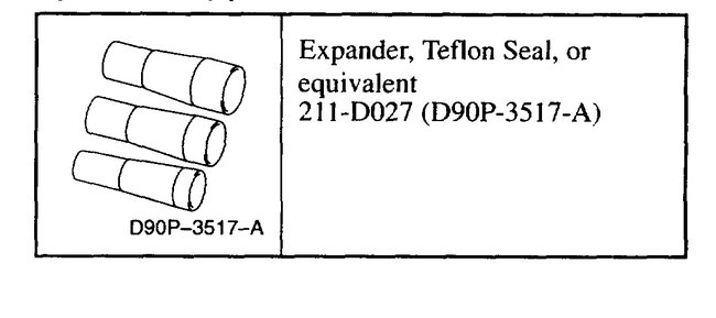

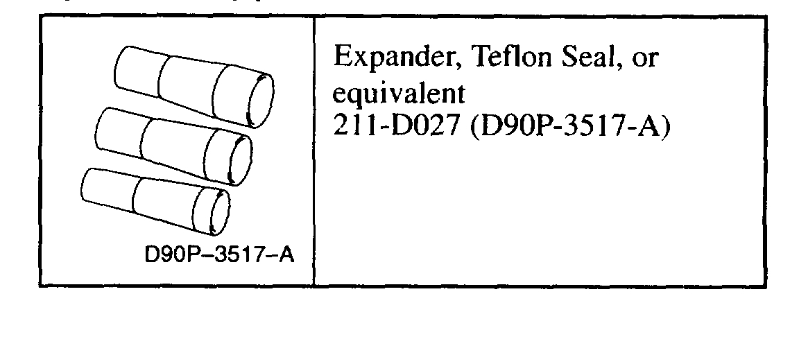

2. Replace the return line connector seal and the pressure line connector seal.
^ Use the Seal Replacer to install the seals over the fittings.

3. Connect the pressure and return lines.
pic 29

5. Connect the wiring at the steering gear.

6. Position the heat shield bracket, and install the retaining screws.
7. Position the heat shield, and install the pushpins.

pic 31
9. Install the subframe bolts (front).

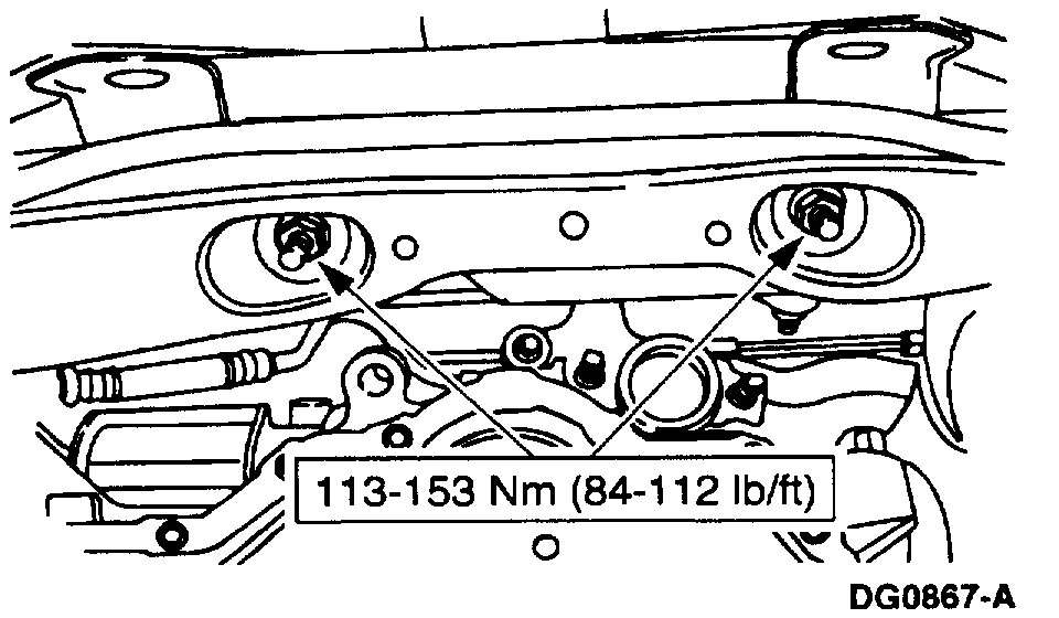

pic 32
10. Install the subframe bolts (rear).
11. Remove the lift.

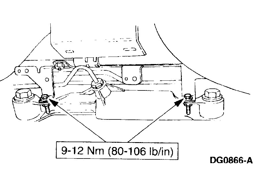

pic 33
12. Position the subframe insulator braces, and install the retaining bolts.
pic 34
13. Position the catalytic converter, and install the support bracket retaining bolt.
pic 35
14. Install the nuts at the exhaust inlet pipe (rear).
pic 36
15. Install the nuts at the exhaust inlet pipe (front).
pic 37
16. Install the exhaust flange bolts and nuts.

pic 38
19. Connect the tie rods, and install the retaining nuts.
20. Install the tie rod end cotter pins.
21. Install the wheels.
22. Lower the vehicle.

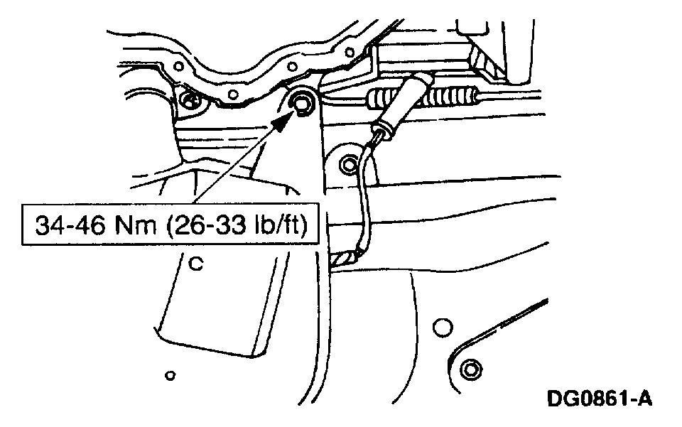

pic 39
23. Position the ground strap, and install the retaining screw.
pic 40
24. Connect the wiring harness.

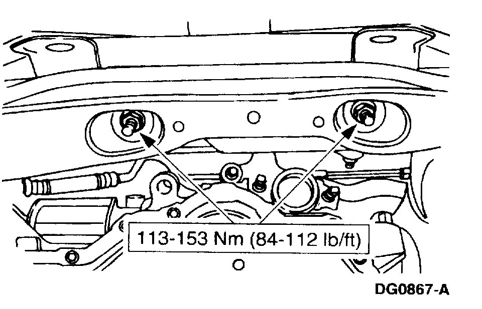

pic 41
25. install the upper motor mount.
26. Install the weather seal.
27. Install the steering column intermediate shaft.
pic 42
28. Install the pinch bolt in the intermediate shaft to gear coupling.
29. Install the pinch bolt in the intermediate shaft to column coupling.
30. Install the steering column reinforcement panel.
31. Install the steering column lower trim panel.
32. Install the instrument panel lower trim cover.
33. Fill and leak check the system.
34. Check and, if necessary, adjust the wheel alignment.

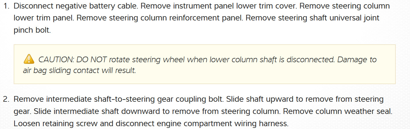

1. Disconnect negative battery cable. Remove instrument panel lower trim cover. Remove
steering column lower trim panel. Remove steering column reinforcement panel. Remove
steering shaft universal joint pinch bolt.
2. Remove intermediate shaft-to-steering gear coupling bolt. Slide shaft upward to remove from
steering gear. Slide intermediate shaft downward to remove from steering column. Remove
column weather seal. Loosen retaining screw and disconnect engine compartment wiring

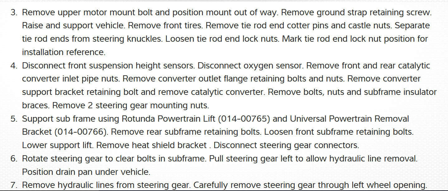

3. Remove upper motor mount bolt and position mount out of way. Remove ground strap
retaining screw. Raise and support vehicle. Remove front tires. Remove tie rod end cotter pins
and castle nuts. Separate tie rod ends from steering knuckles. Loosen tie rod end lock nuts.
Mark tie rod end lock nut position for installation reference.
4. Disconnect front suspension height sensors. Disconnect oxygen sensor. Remove front and rear
catalytic converter inlet pipe nuts. Remove converter outlet flange retaining bolts and nuts.
Remove converter support bracket retaining bolt and remove catalytic converter. Remove
bolts, nuts and subframe insulator braces. Remove 2 steering gear mounting nuts.
5. Support sub frame using Rotunda Powertrain Lift (014-00765) and Universal Powertrain
Removal Bracket (014-00766). Remove rear subframe retaining bolts. Loosen front subframe
retaining bolts. Lower support lift. Remove heat shield bracket . Disconnect steering gear
connectors.
6. Rotate steering gear to clear bolts in subframe. Pull steering gear left to allow hydraulic line
removal. Position drain pan under vehicle.
7. Remove hydraulic lines from steering gear. Carefully remove steering gear through left wheel
opening.

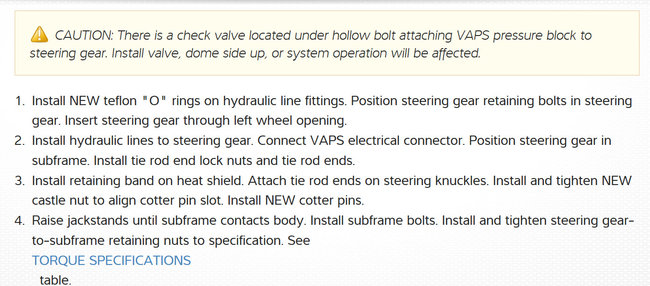

Installation
1. Install NEW teflon "O" rings on hydraulic line fittings. Position steering gear retaining bolts in
steering gear. Insert steering gear through left wheel opening.
2. Install hydraulic lines to steering gear. Connect VAPS electrical connector. Position steering
gear in subframe. Install tie rod end lock nuts and tie rod ends.
3. Install retaining band on heat shield. Attach tie rod ends on steering knuckles. Install and
tighten NEW castle nut to align cotter pin slot. Install NEW cotter pins.
4. Raise jackstands until subframe contacts body. Install subframe bolts. Install and tighten
steering gear-to-subframe retaining nuts to specification. See TORQUE SPECIFICATIONS
table.

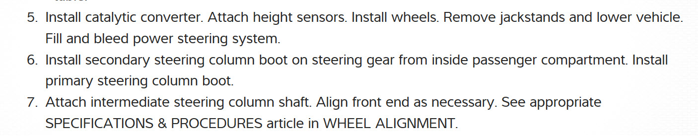

5. Install catalytic converter. Attach height sensors. Install wheels. Remove jackstands and lower
vehicle. Fill and bleed power steering system.
6. Install secondary steering column boot on steering gear from inside passenger compartment.
Install primary steering column boot.
7. Attach intermediate steering column shaft. Align front end as necessary. See appropriate
SPECIFICATIONS & PROCEDURES article in WHEEL ALIGNMENT.

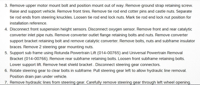

3. Remove upper motor mount bolt and position mount out of way. Remove ground strap retaining screw. Raise and support vehicle. Remove front tires. Remove tie rod end cotter pins and castle nuts. Separate tie rod ends from steering knuckles. Loosen tie rod end lock nuts. Mark tie rod end lock nut position for installation reference.
4. Disconnect front suspension height sensors. Disconnect oxygen sensor. Remove front and rear catalytic converter inlet pipe nuts. Remove converter outlet flange retaining bolts and nuts. Remove converter support bracket retaining bolt and remove catalytic converter. Remove bolts, nuts and subframe insulator braces. Remove 2 steering gear mounting nuts.
5. Support sub frame using Rotunda Powertrain Lift (014-00765) and Universal Powertrain Removal Bracket (014-00766). Remove rear subframe retaining bolts. Loosen front subframe retaining bolts. Lower support lift. Remove heat shield bracket . Disconnect steering gear connectors.
6. Rotate steering gear to clear bolts in subframe. Pull steering gear left to allow hydraulic line removal. Position drain pan under vehicle.
7. Remove hydraulic lines from steering gear. Carefully remove steering gear through left wheel opening.
7.
Installation
CAUTION:There is a check valve located under hollow bolt attaching VAPS pressure block to steering gear. Install valve, dome side up, or
system operation will be affected.
1. Install NEW teflon "O" rings on hydraulic line fittings. Position steering gear retaining bolts in steering gear. Insert steering gear through left wheel opening.
2. Install hydraulic lines to steering gear. Connect VAPS electrical connector. Position steering gear in subframe. Install tie rod end lock nuts and tie rod ends.
3. Install retaining band on heat shield. Attach tie rod ends on steering knuckles. Install and tighten NEW castle nut to align cotter pin slot. Install NEW cotter pins.
4. Raise jackstands until subframe contacts body. Install subframe bolts. Install and tighten steering gear-to-subframe retaining nuts to specification.
5. Install catalytic converter. Attach height sensors. Install wheels. Remove jackstands and lower vehicle. Fill and bleed power steering system.
6. Install secondary steering column boot on steering gear from inside passenger compartment. Install primary steering column boot.
