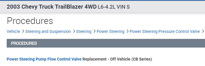

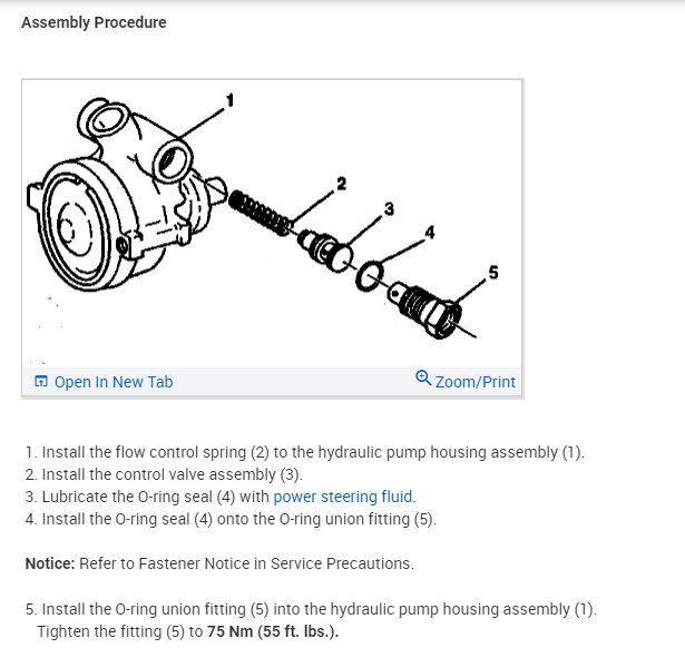

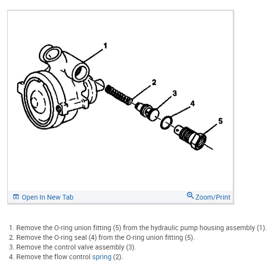

It is odd that both had the same type of failure. The vehicle doesn't have speed-sensitive steering so there shouldn't be a problem with that. The only other thing I can think of would be the power steering control valve.
This valve directs fluid flow based on the direction you turn. If it is not working properly, I guess it could allow pressure to go in two directions and build too much pressure. However, that would be unlikely.
If you look below, I attached the directions for replacing one. I wanted to add this for you to first see what I'm talking about and if you wanted to replace it, you could do it yourself.
