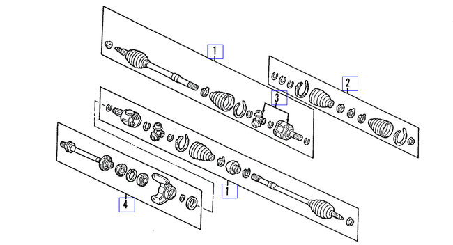

* Clicks when turning right and left often, but not always.
* Right cv boot torn and replaced after adding new grease.
* Left cv boot looks to be in good condition.

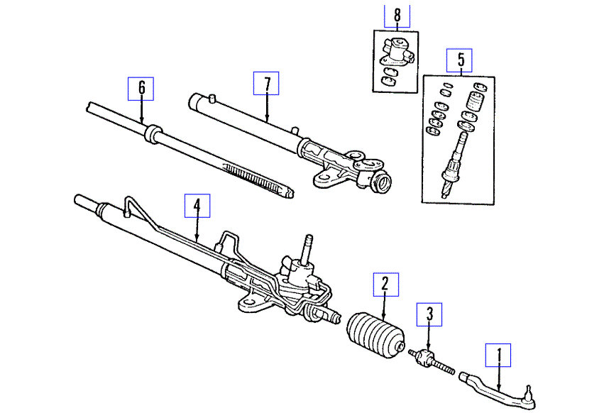

* Slight play in center of steering wheel.
* Steering rack boots torn, but not leaking.
* Steering rack boots' tears patched with self- fusing rubber silicone tape (1" x 10') and duck tape.
* Tread wear indicates needs front alignment.
* Slightly out of alignment, veers to right.
* Dealer can't align front with slight play in left wheel. He states there is slight play in the left steering rack and left wheel.
How can I remove the slight play in the steering wheel?
Can I add more grease to the steering rack teeth? If so, how?
Does the left CV joint need new grease? Would this help stop the clicking?

The play may be an inner tie rod end in the steering. That is part of the rack itself.
If the CV joint is making noise already, adding grease will not fix it. The damage has already been done and it needs to be replaced.

If the boots on the rack are torn, they need to be replaced but if there is play in the rack, then the rack is no good.
From your descriptions, you need the rack and pinion replaced along with the axles.

Does the clicking noise from the CV joint when turning right and left indicate one or both CV axles need work?
How do you determine if the inner tie rod end and/or rack must be replaced?

When it clicks both ways, yes, it could be both sides. When one is just bad, it will click to one side only.
You will need to lift the car and then grab the wheel at the 3 and 9 o'clock position and see if there is play. If there is have someone look behind the tire for the play.

If you are turning right when it clicks, does that indicate it is the right or left CV joint?

The side that the boot ripped and you replaced is definitely one that needs to be replaced.
