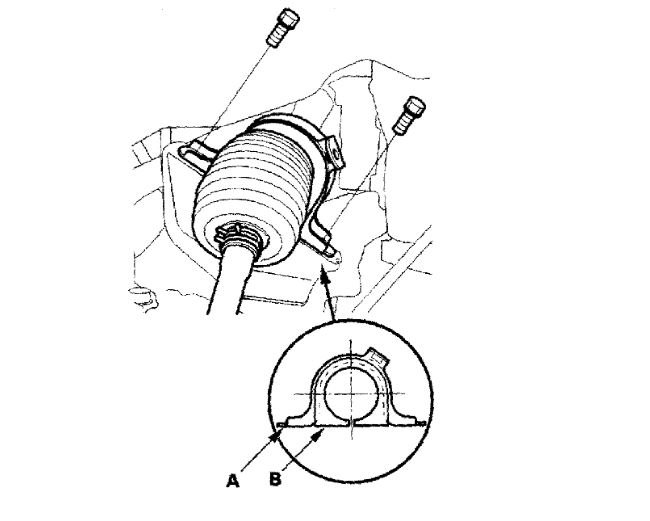

Lots if play when i move the rack and pinion by hand. where are the bushings on it and how it can be replaced?

Good afternoon,
There are bushings that secure the rack to the firewall.
You can reach them one at a time from each side with the car up and the wheels off.
I attached a picture for you of the bushings.
