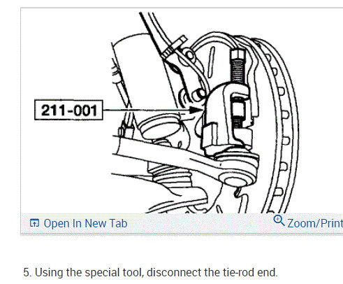

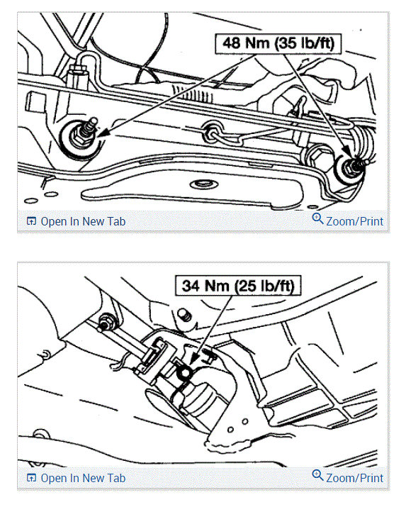

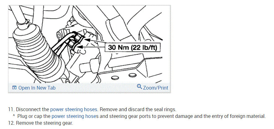

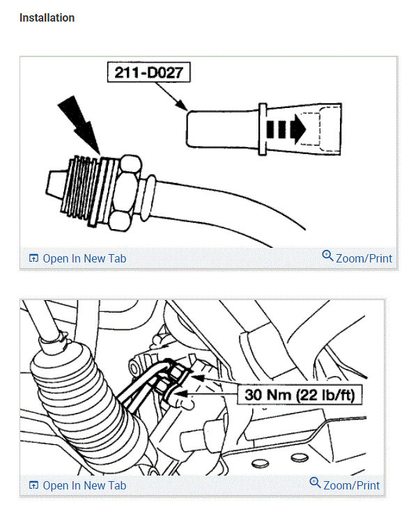

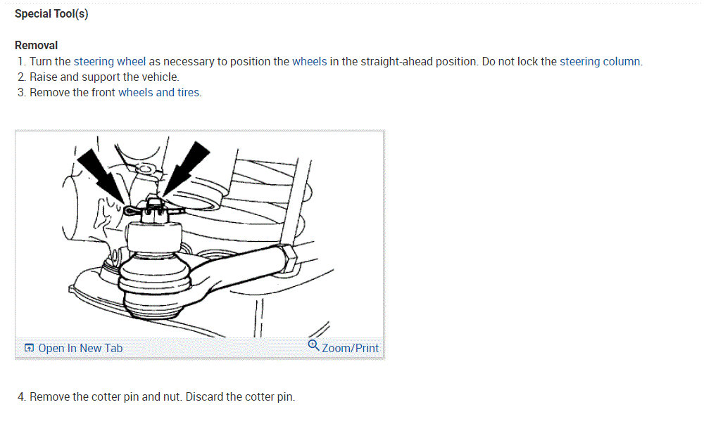

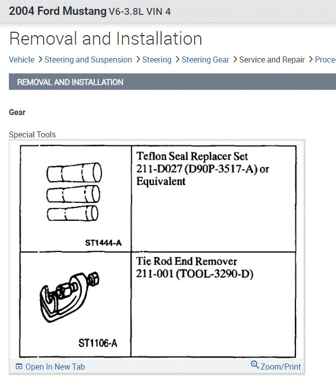

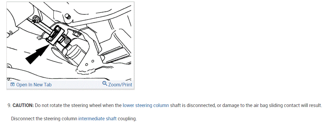

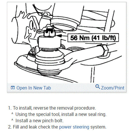

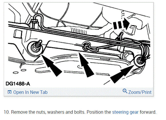

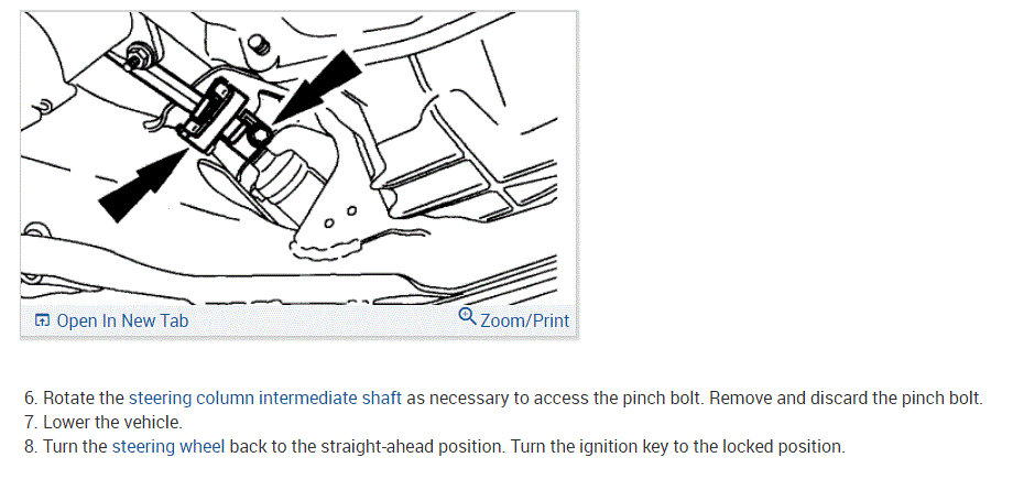

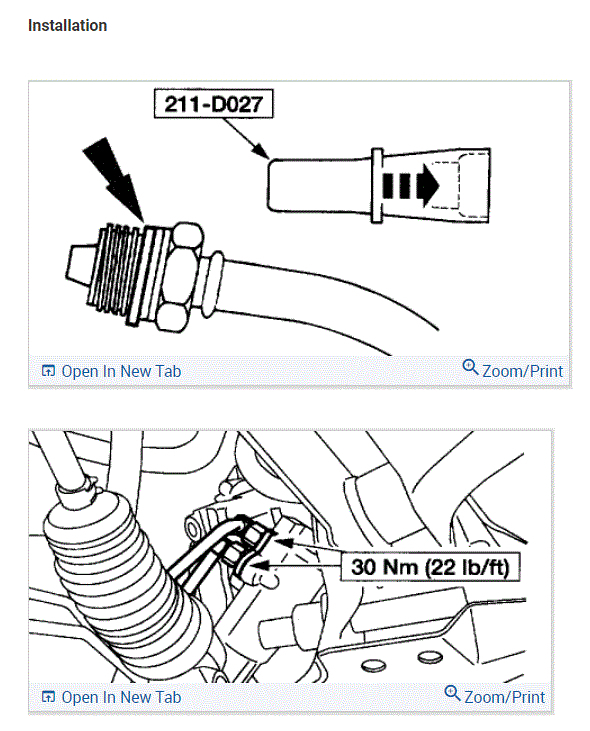

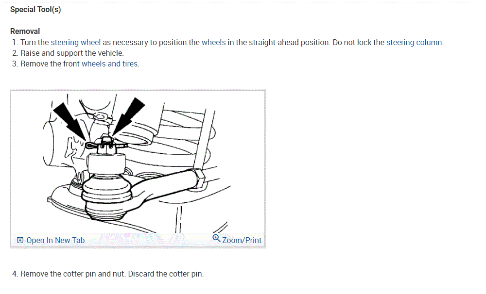

I want to remove the rack off the 2000 and take off the rack on the 2004 and put it on the 2000.
Aug 25, 2021 at 9:09 PM
  • 110,244 POSTS
I looked up the part number for both model years. They are the same, so it should be straightforward. I attached the part numbers below
2000 Mustang 3.8L 2R3Z3504CARM
2004 Mustang 3.8L 2R3Z3504CARM
I attached the directions for removal and replacement for the rack below. Let me know if that helps or if you have other questions.
