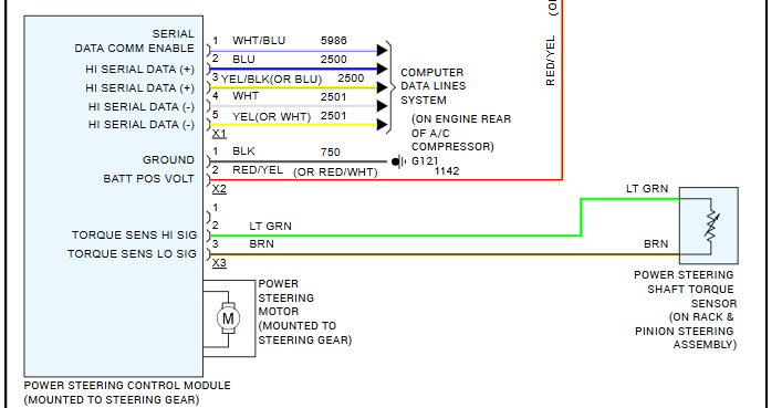

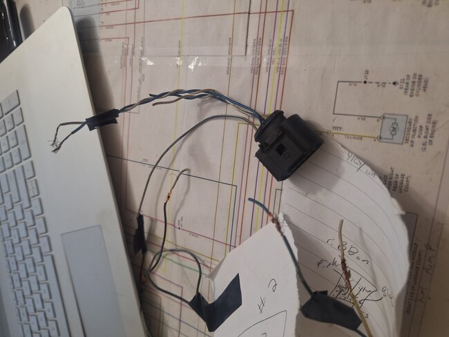

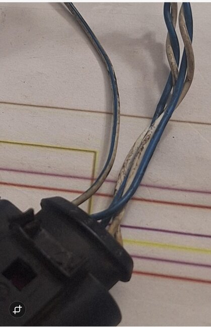

I cut the rack and pinion harness wires by accident. i have the engine wire harness diagram, but the diagram doesnt show the rack and pinion wire figuration. which blue and white wire goes with each other?
Dec 6, 2025 at 3:25 PM
  • 55,433 POSTS
The wires should be blue, white and blu/wht so there is no wires the same color you need to know where they go. But here are the wiring diagrams to avoid confusion. Check out the images (below). Let us know if you need anything else.

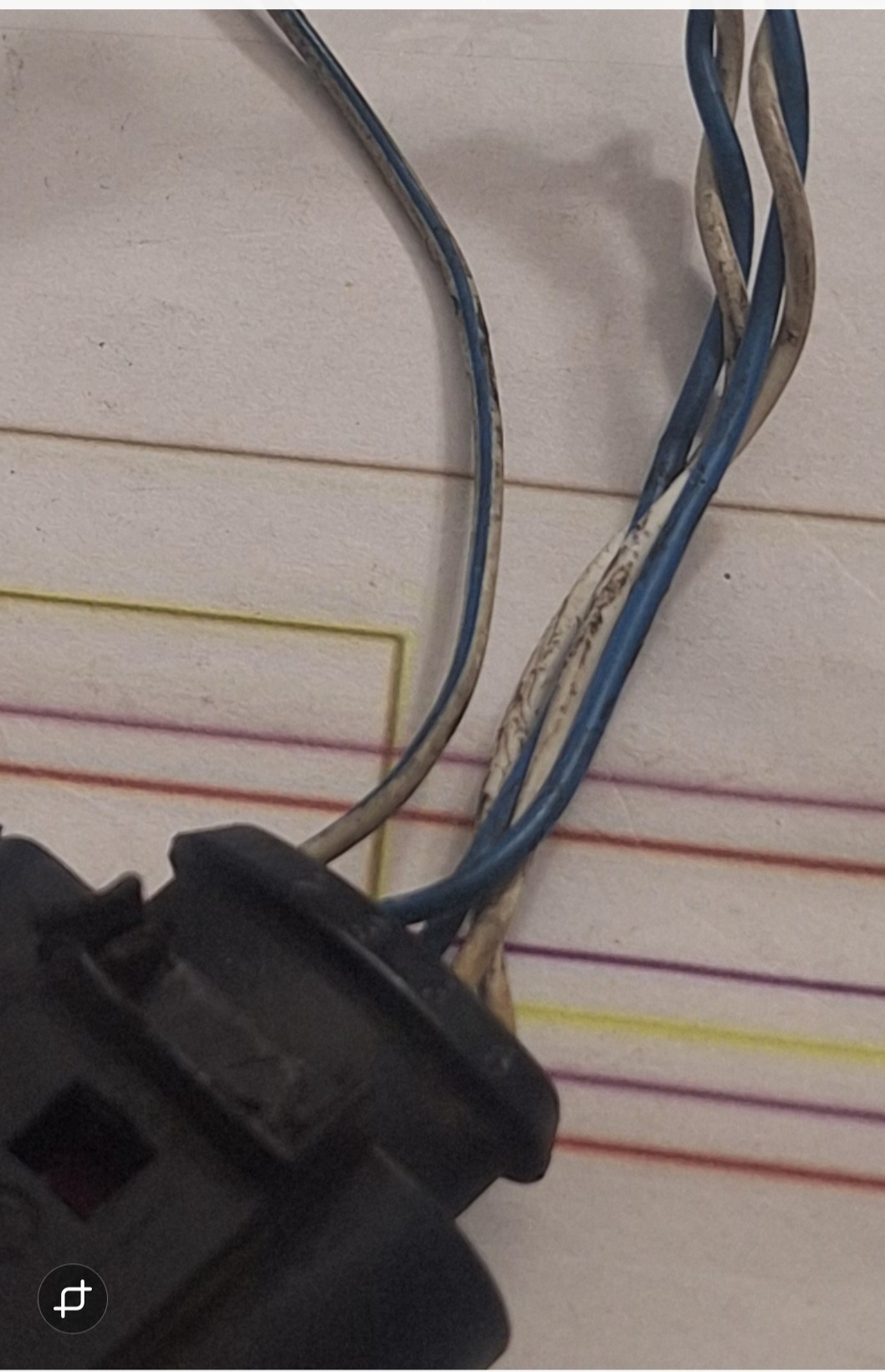

Slot(s) 1, white/blue wire; 2, blue wire; 3 blue wire; 4, white wire and slot 5, white wire. This came on the like that, no modifications.

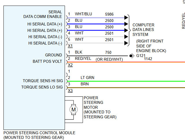

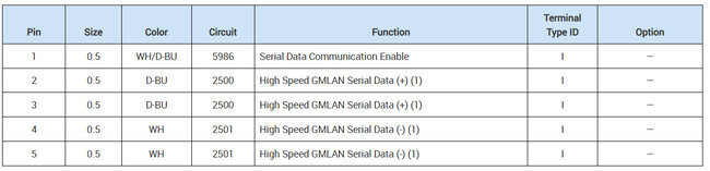

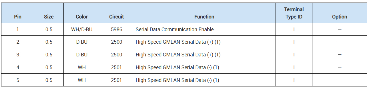

Okay, I found it, this car is actually a 2015 here is the wiring diagrams and connector view showing it doe not matter which white to white and blue to blue so you are good to go. Check out the images (below). Let us know if you need anything else.

I've been getting alot of my engine products based on the vehicle title, which states that it is a 2014. I recently got a harness diagram that was 2014 to rewire the harness, is there slight variations to the 2014 to 2015 diagram?

Yes, there are, when the factory starts changing over from year to year they can install parts from the next year which has happened here.
