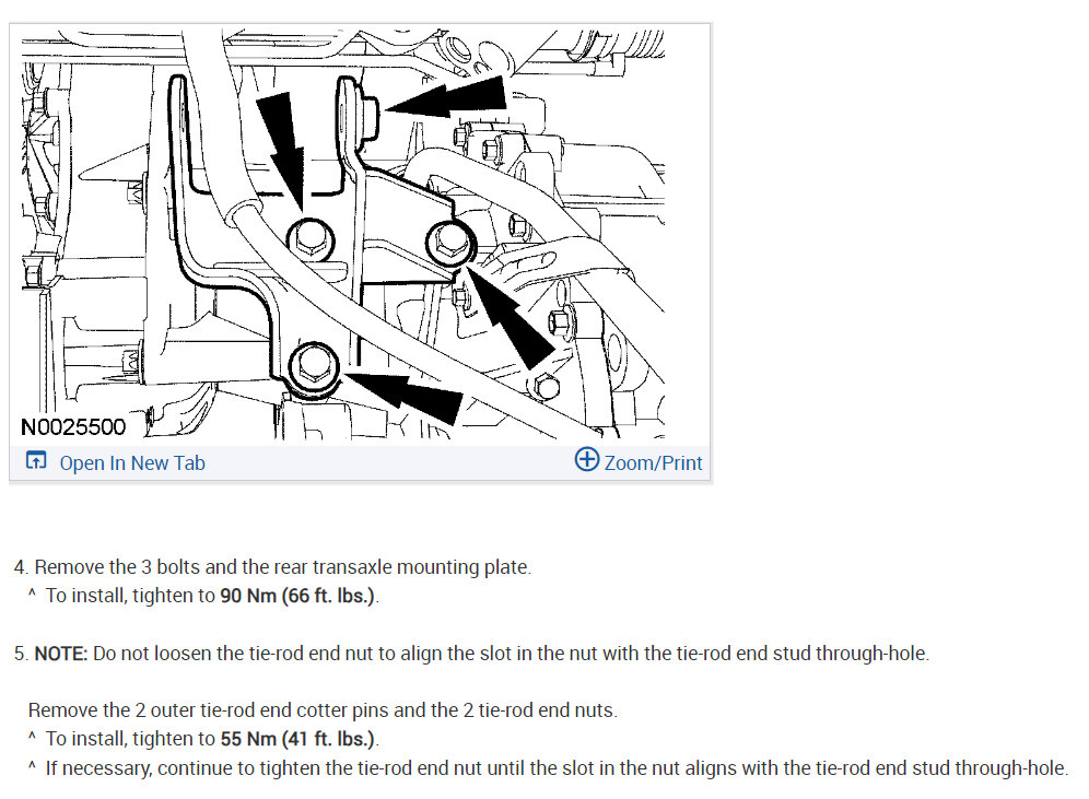

What tools do I need to change the rack and pinion?
2005 FORD ESCAPE
243,000 MILES • 3.0L • V6 • 2WD • AUTOMATIC
PINGPONG1981

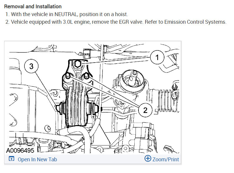

What size wrenches and what tools do I need to change the rack and pinion out on my vehicle listed above Limited model.

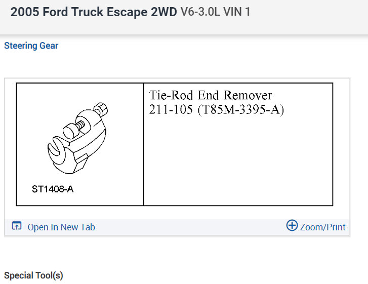

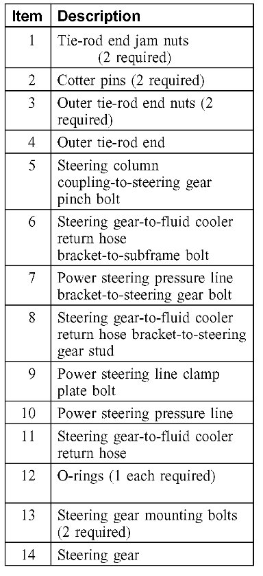

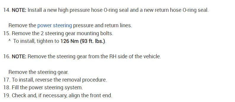

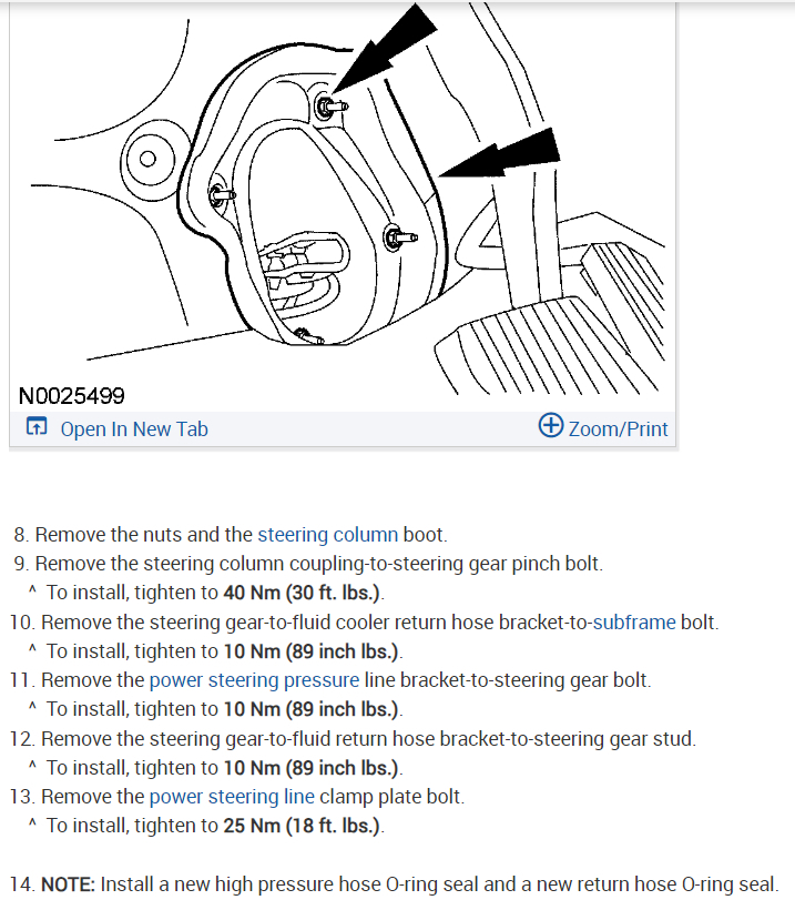

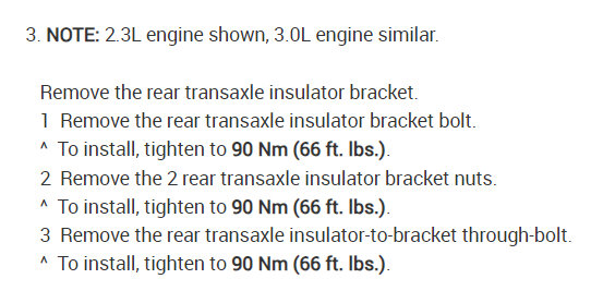

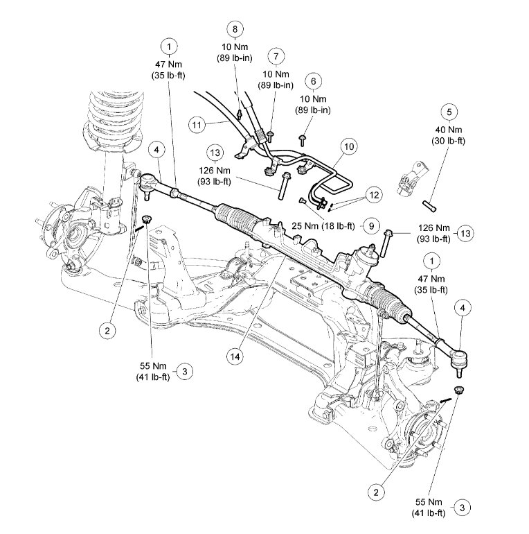

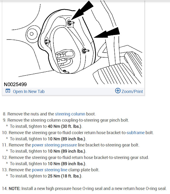

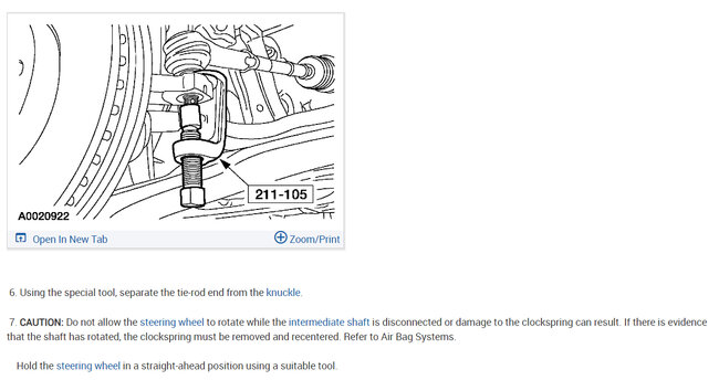

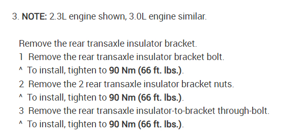

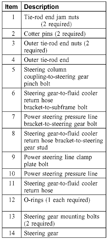

Here is how the rack and pinion is changed out correctly in the images below. The car will need to be aligned when completed and you will need to remove the tie rods from the spindles which a special tool is used for, and you will need a torque wrench as well. Check out the images (below). Please upload pictures or videos in your response of any problems so we can see what to help you with.
