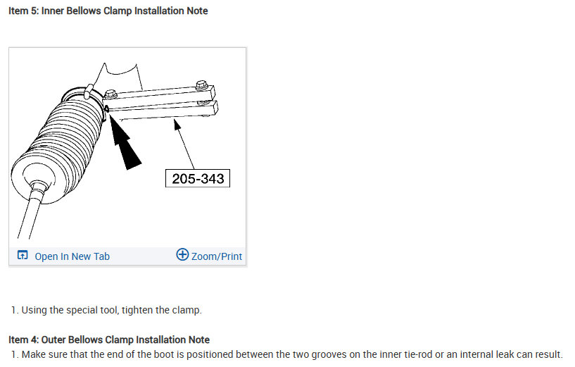

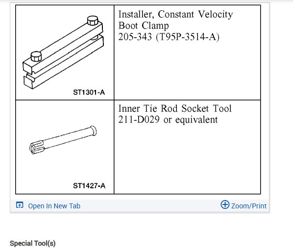

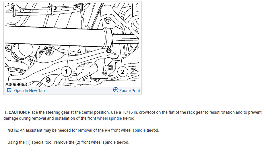

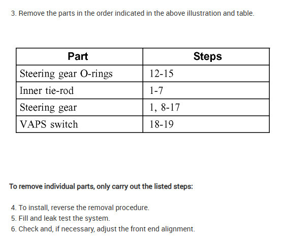

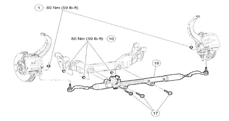

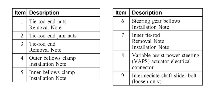

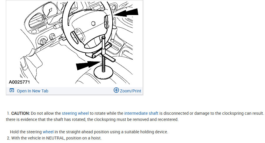

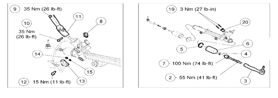

Looking for removal and replacement videos
Mar 5, 2025 at 6:48 AM
  • 110,240 POSTS

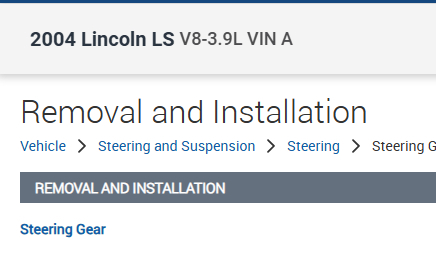

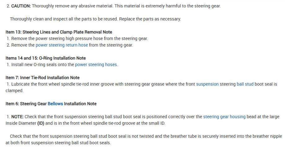

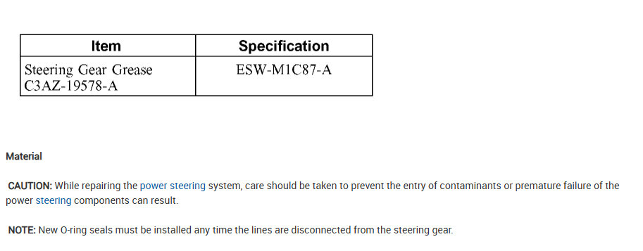

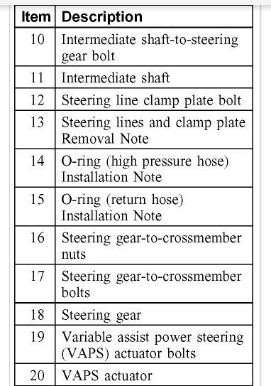

Unfortunately, I don't have a video specific to this vehicle. However, I have attached the directions from my manual below.
Take a look through them and let me know if you have questions.
I hope this helps.
