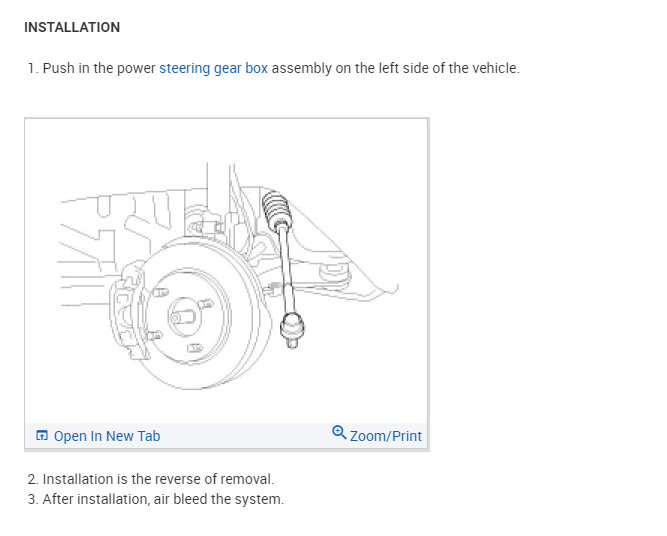

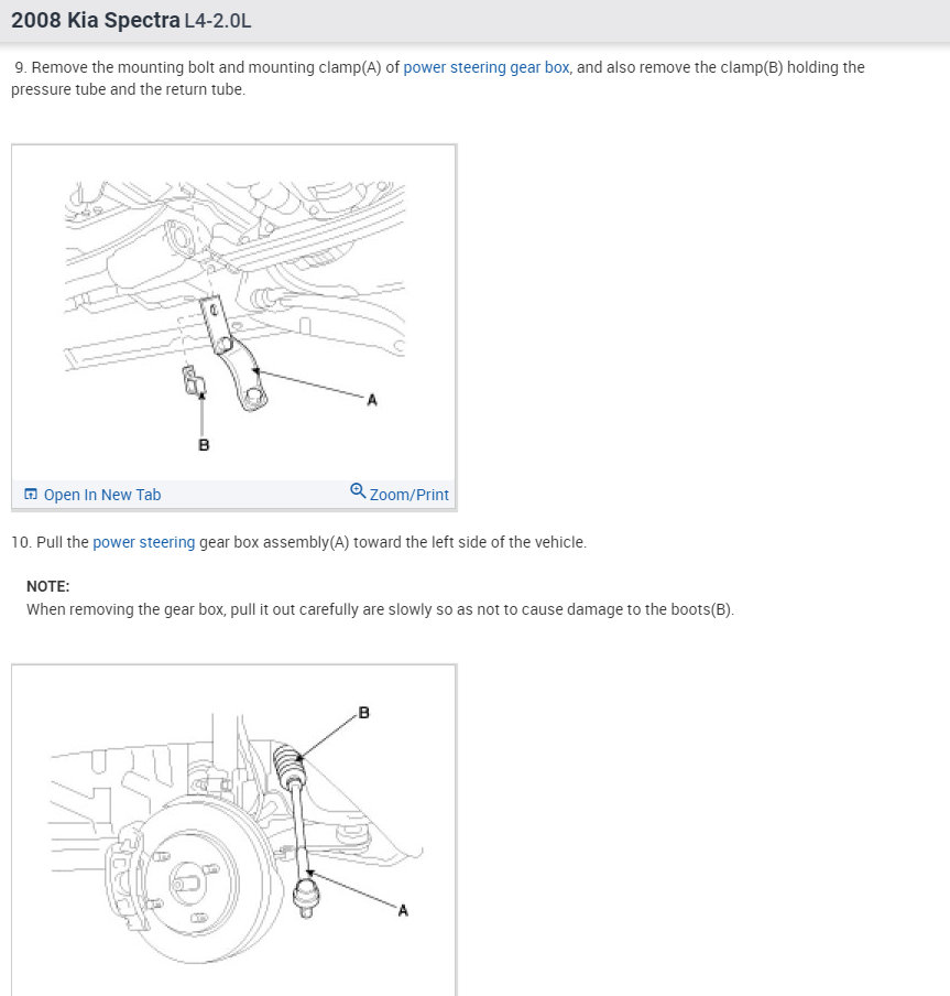

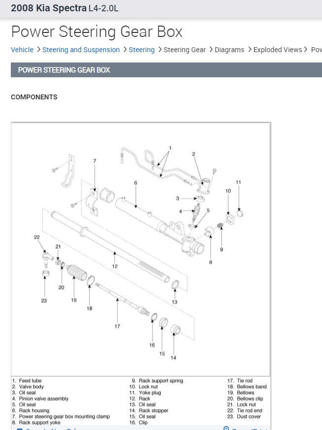

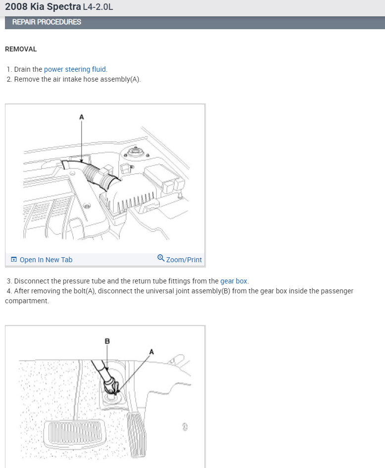

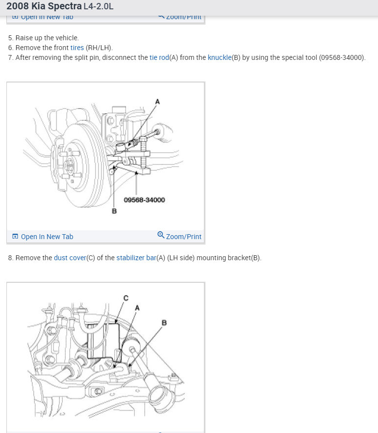

Replacing the rack does not require the removal of the subframe.
I have attached the replacement procedure below for your reference.
Let me know of any questions.

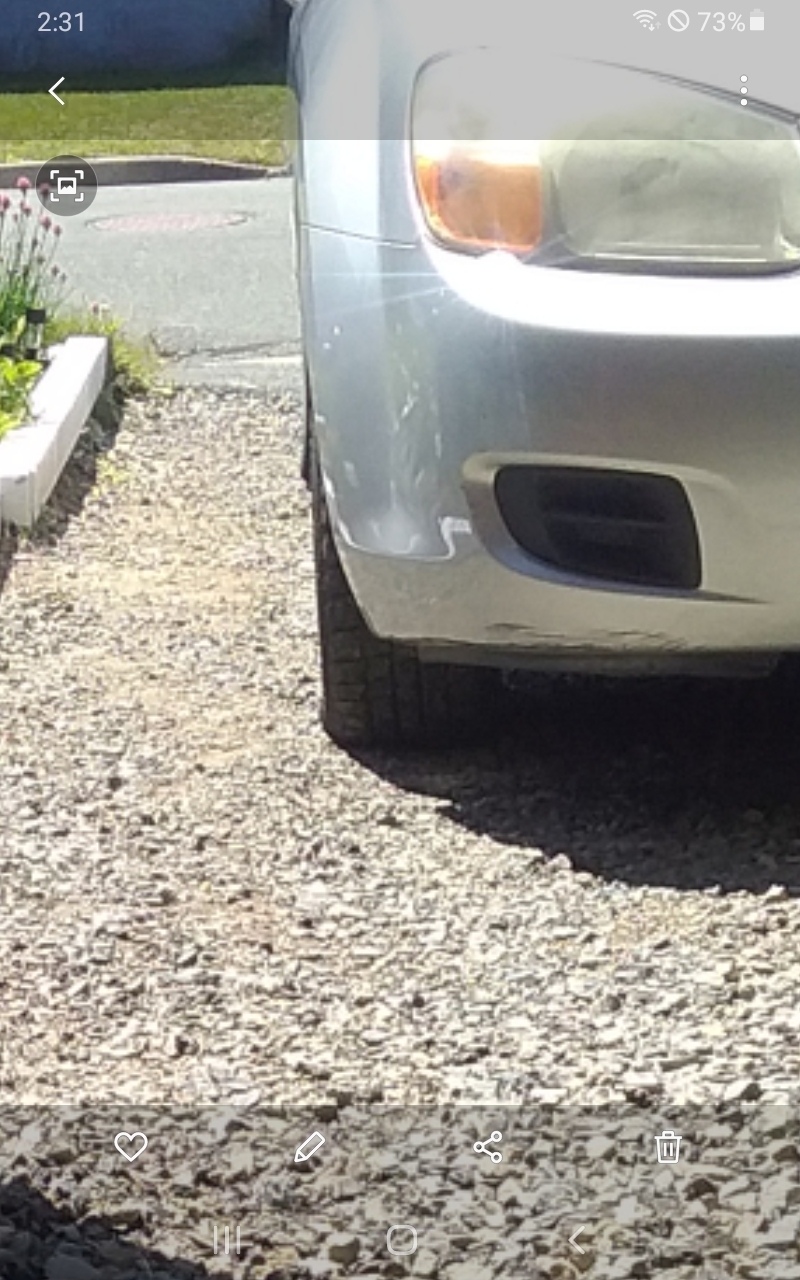

I'm not sure that I mentioned that I installed a used rack with tie rods attached from salvage yard. Before I installed the rack, the steering wheel was a fraction to the right not by much. After I installed the rack, the steering wheel is off 1/4 turn to the left. I included a pic of the right front tire with the steering wheel straight and it seems to point out as you can see a bit of the back tire. The left side seems to be pointed in. this tire seems pointed out to me with the steering wheel straight which is what is confusing me.
Jul 13, 2022 at 10:14 AM
SQM
  • 6,383 POSTS
Since the replacement components already have the tie rod ends, it will need to be adjusted. Likely you will have to get this aligned as the components are not matched with your car. You will likely have to get it aligned even if you are able to adjust the rack while the steering wheel is straight.
