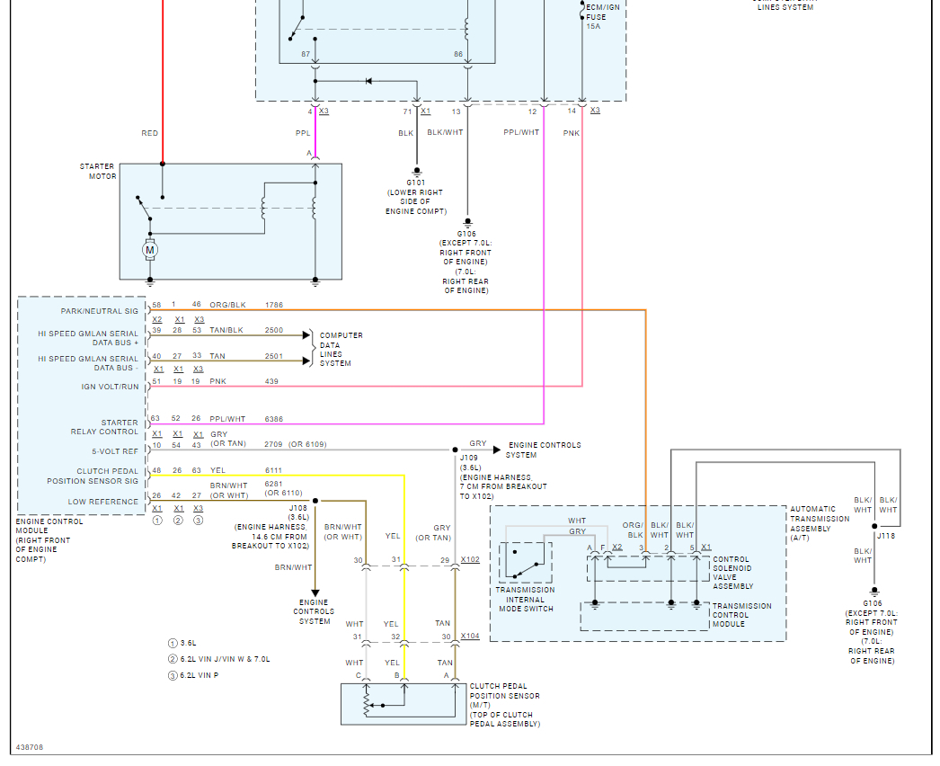

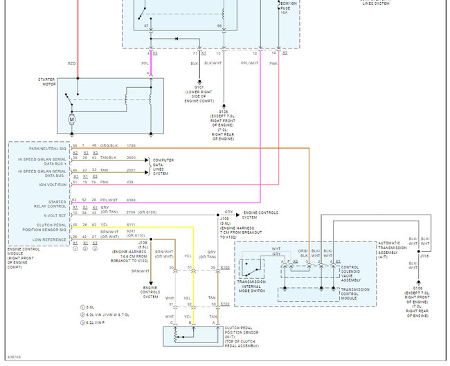

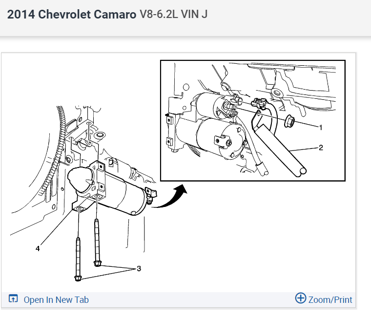

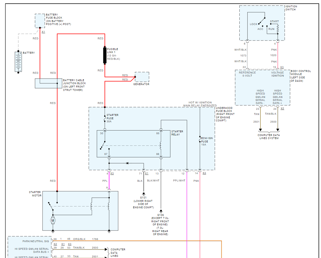

Probably broke the starter housing, which is difficult to see, can you upload a short video of the noise or what is it doing so I can see? If the starter solenoid is getting power in the crank position the starter is bad.
This guide can help us:
Here is the starter wiring diagrams so you can see how the system works as well. Please go over this video as well. Can I ask if the security light is flashing?
https://youtu.be/6YRW8fyNudY?si=hFtpKkNi2siiVc83

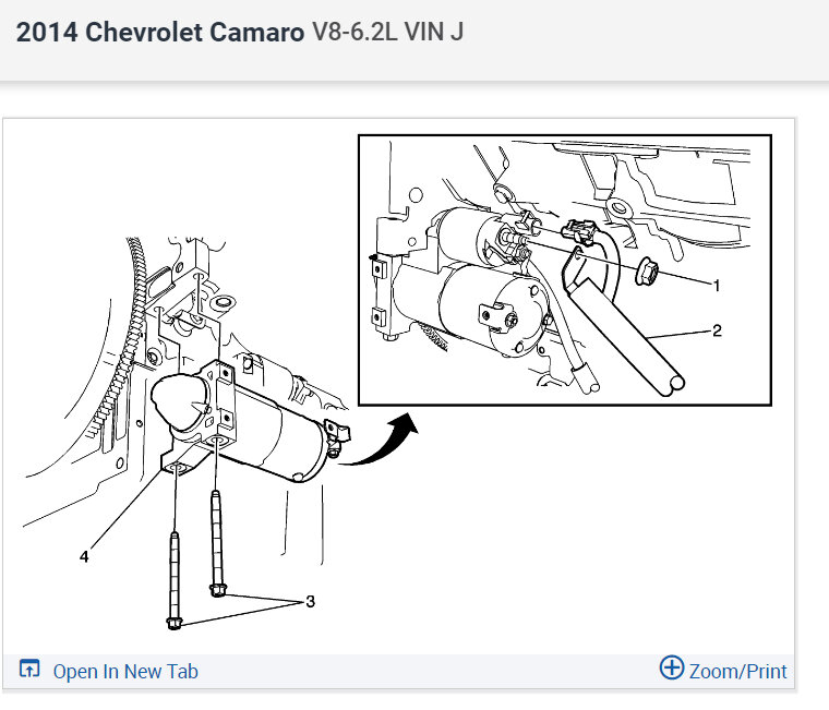

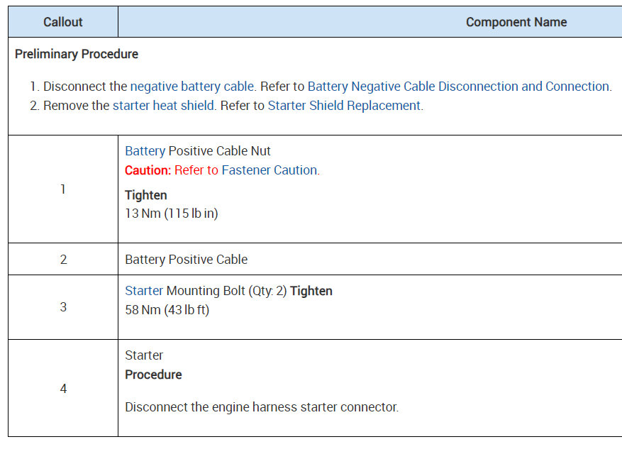

Here is how to change out the starter motor, start by disconnecting the battery. Check out the images (below). Please let us know what happens.

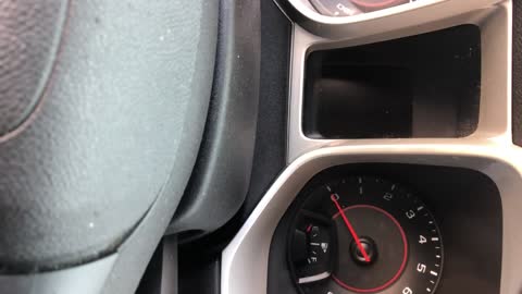

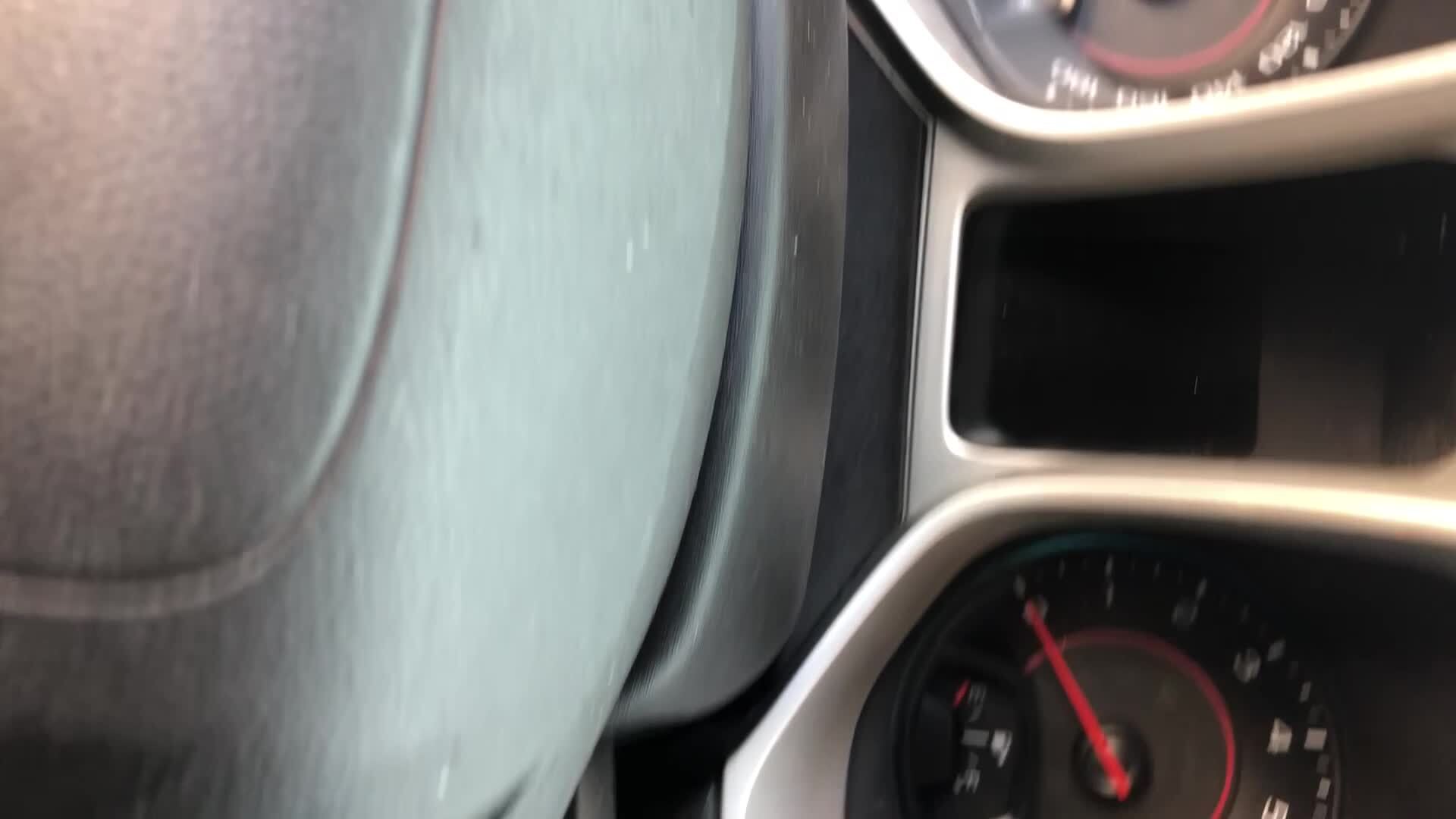

Thanks for the video, are you leaving the key on when the dash lights go out? I can't tell what the key is doing? Nor could I see the security light.
Sep 10, 2024 at 2:37 AM
AMERCHANT031
  • 8 POSTS
Yes, I’m leaving the key on when the dash light goes out. When the jack slipped the alarm did go off multiple times I forgot to add.

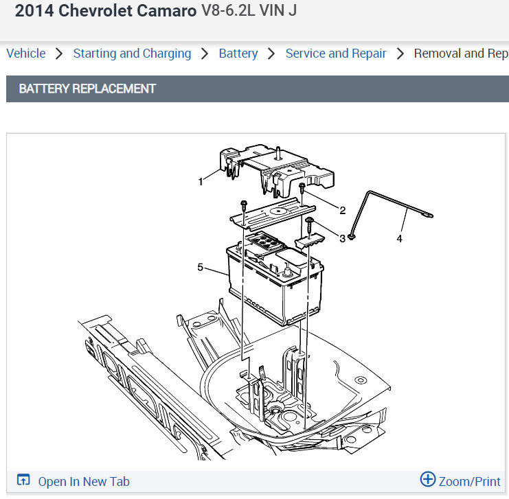

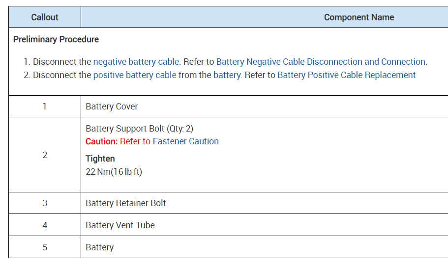

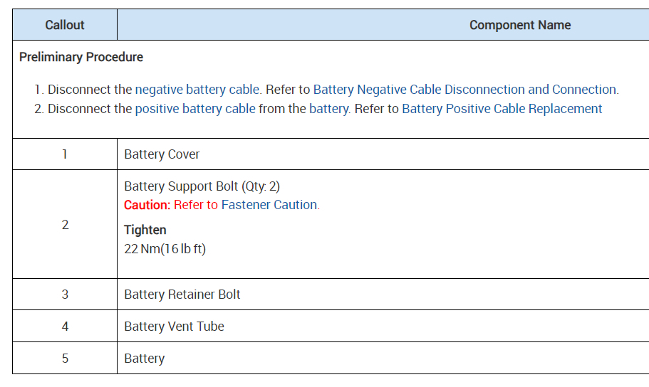

Hmm, it sounds like the battery could be bad, I would remove it and take it to the auto parts store for testing. Check out the images (below). Please let us know what happens.
Sep 10, 2024 at 9:58 AM
AMERCHANT031
  • 8 POSTS
The battery is new no older than 3 weeks but I tested it it’s good the starters good also.

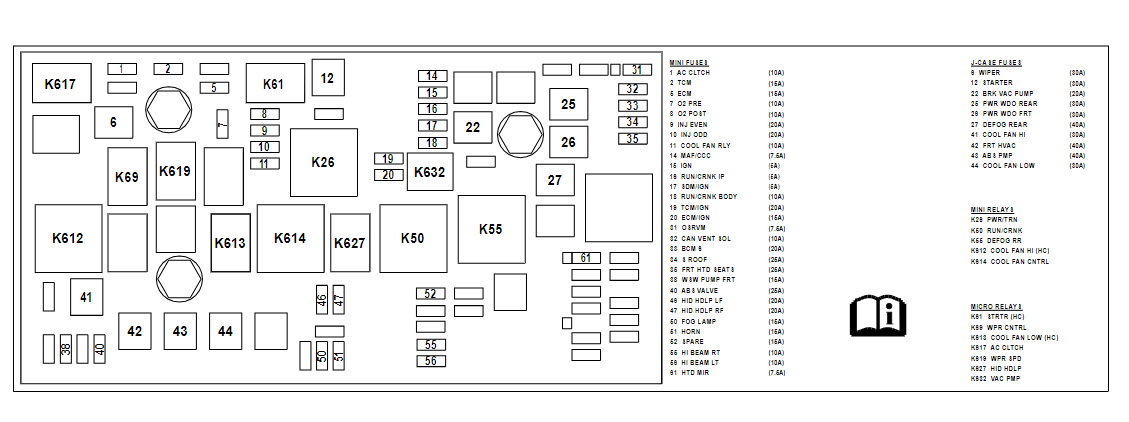

Let's try a hard system reboot, this guide can help you:
https://www.2carpros.com/articles/step-by-step-guide-performing-a-hard-system-reboot-for-your-vehicles-electronics-systems

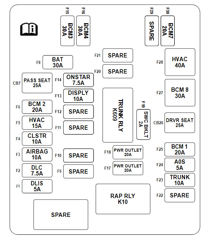

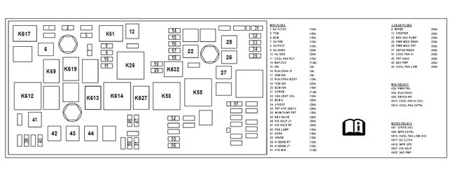

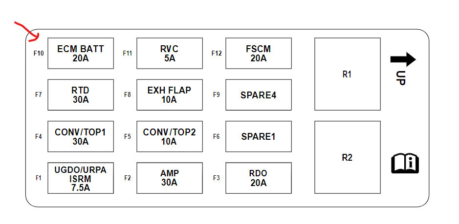

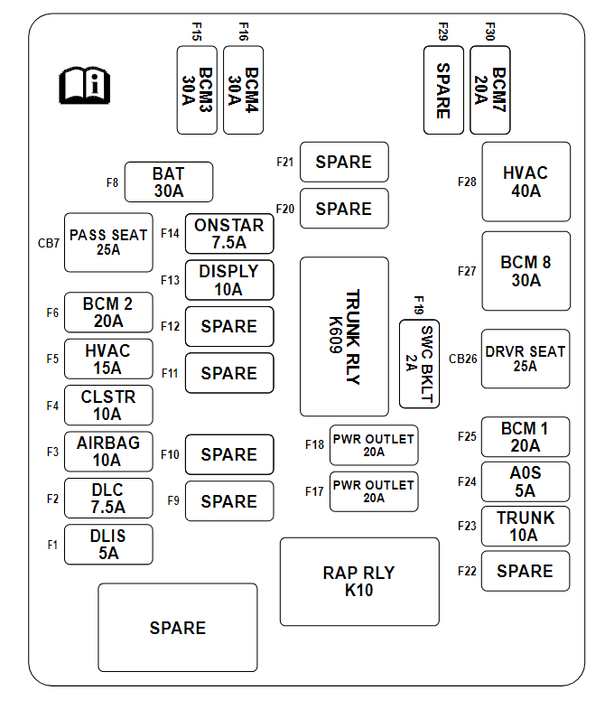

Also, have you checked all of the fuses? This guide can help, and I have included the fuse locations, please check the fuses with the ignition system on. Check out the images (below). Please let us know what happens.
