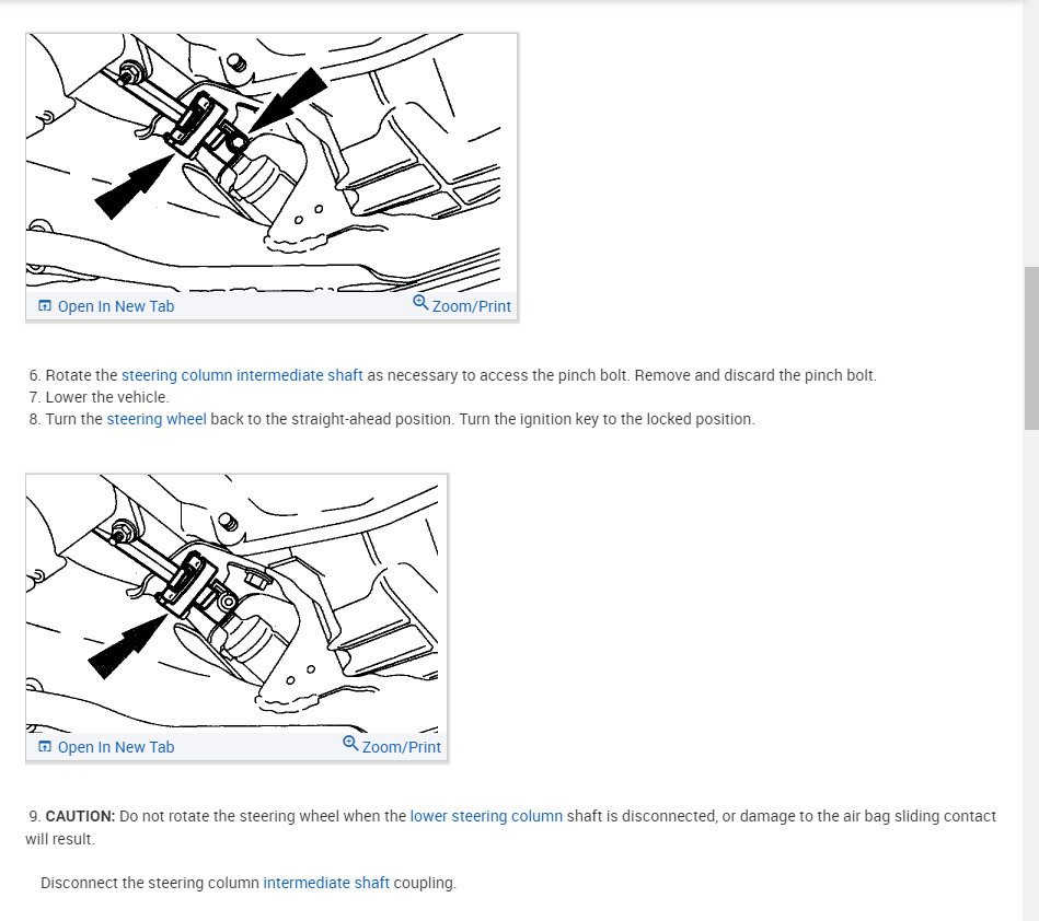

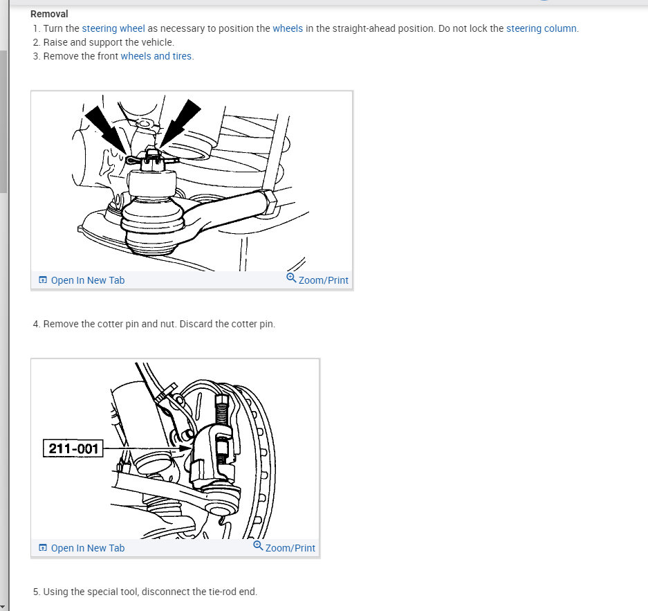

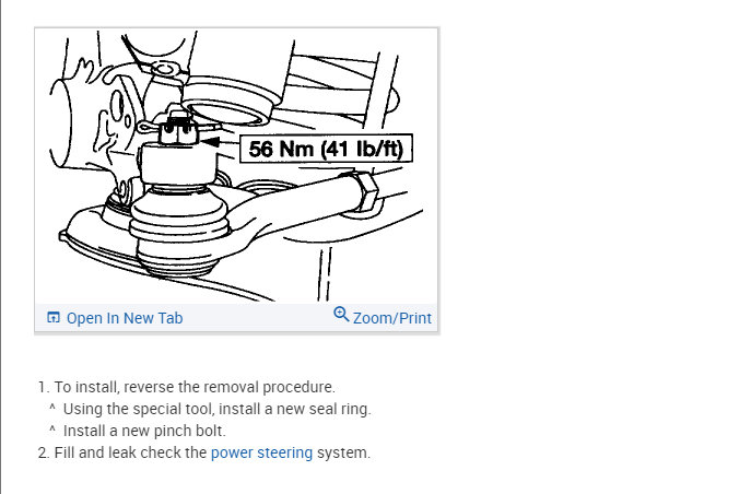

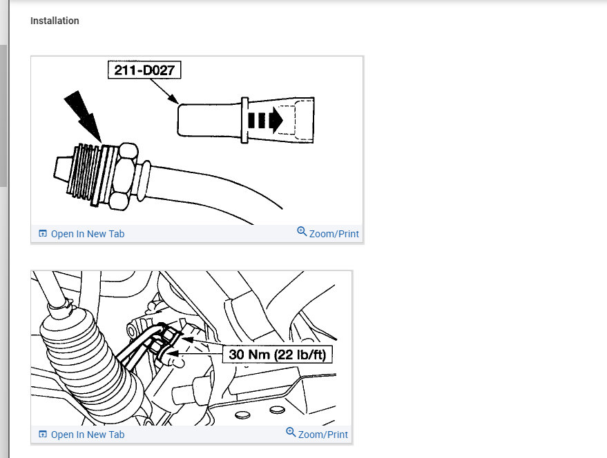

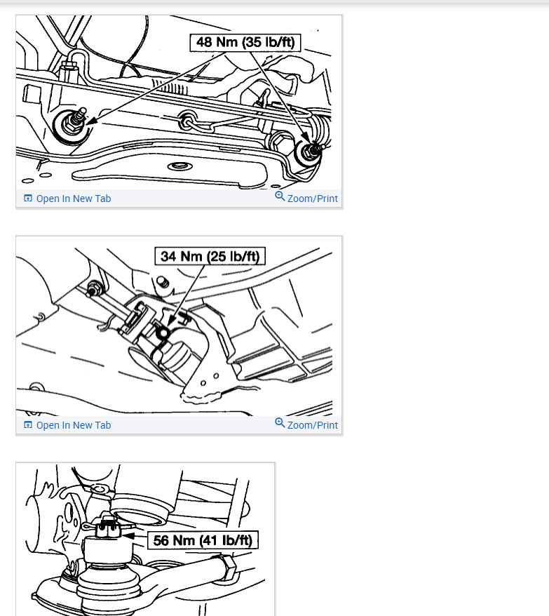

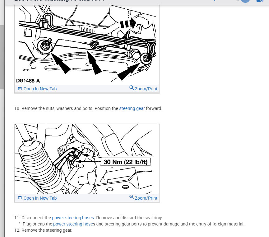

Okay I have a 2004 Mustang rack and pinion taking that off and I want to put that on my 2000 Mustang what are the steps I need to know to do that?
Nov 27, 2021 at 4:31 PM
Experienced Mechanic
18,907 POSTS
The process is the same in both vehicles so it should be pretty straight forward.
I am attaching the info from the manual below.
However, if you are changing this with another used part then I would suggest flushing the fluid.
Here is a guide that will show how to do that:
https://www.2carpros.com/articles/power-steering-fluid-flush
Below is the info from the manual.
Please let us know if you need more info. Thanks
