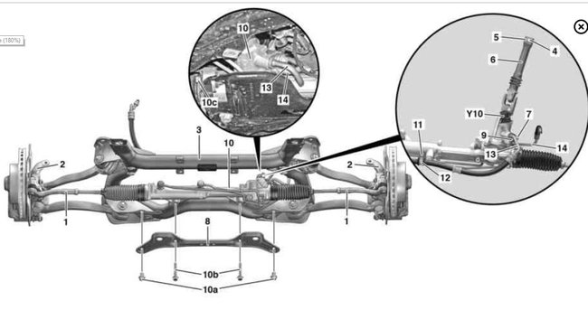

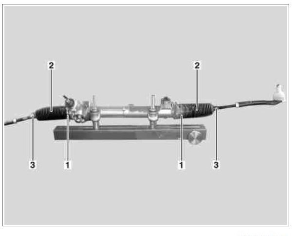

Replacing rack and pinion. How to remove old and how to flush and fill new unit?
Jul 9, 2017 at 7:21 AM
Experienced Mechanic
55,616 POSTS
I start by flushing the system first. This will get all of the old fluid out so you don't contaminate the new rack.
https://www.2carpros.com/articles/power-steering-fluid-flush
You will need to jack the car up
Make sure you use a line wrench
https://youtu.be/HNlvgp_YfQ0
and to undo the tie rod ends
https://www.2carpros.com/articles/tie-rod-end-replacement
Diagrams on how to do the job are below. You will need an alignment when done.
