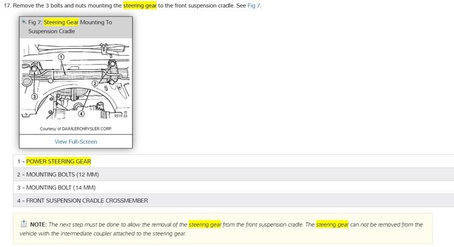

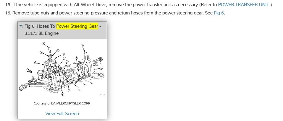

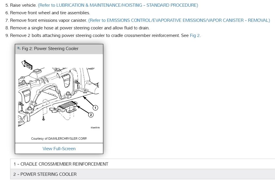

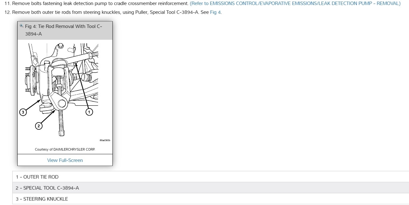

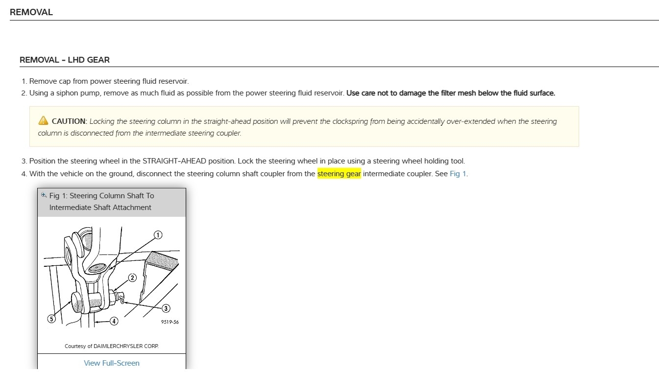

How do I replace the rack and pinion on the vehicle listed above?
Mar 18, 2023 at 5:21 PM
BRENDON S
  • 653 POSTS
Good morning, ARIANADANIELLE5345,

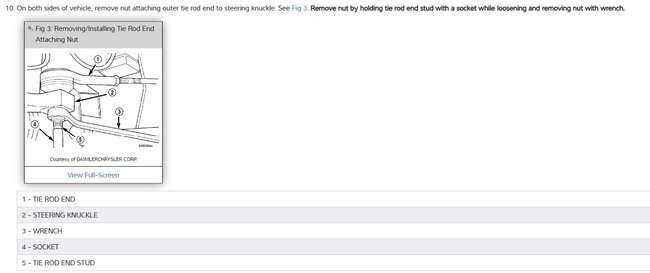

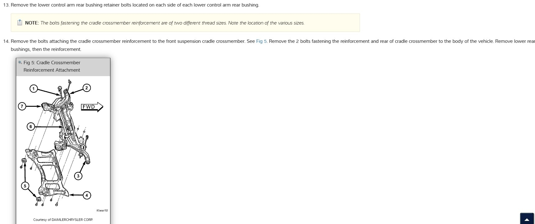

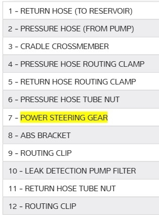

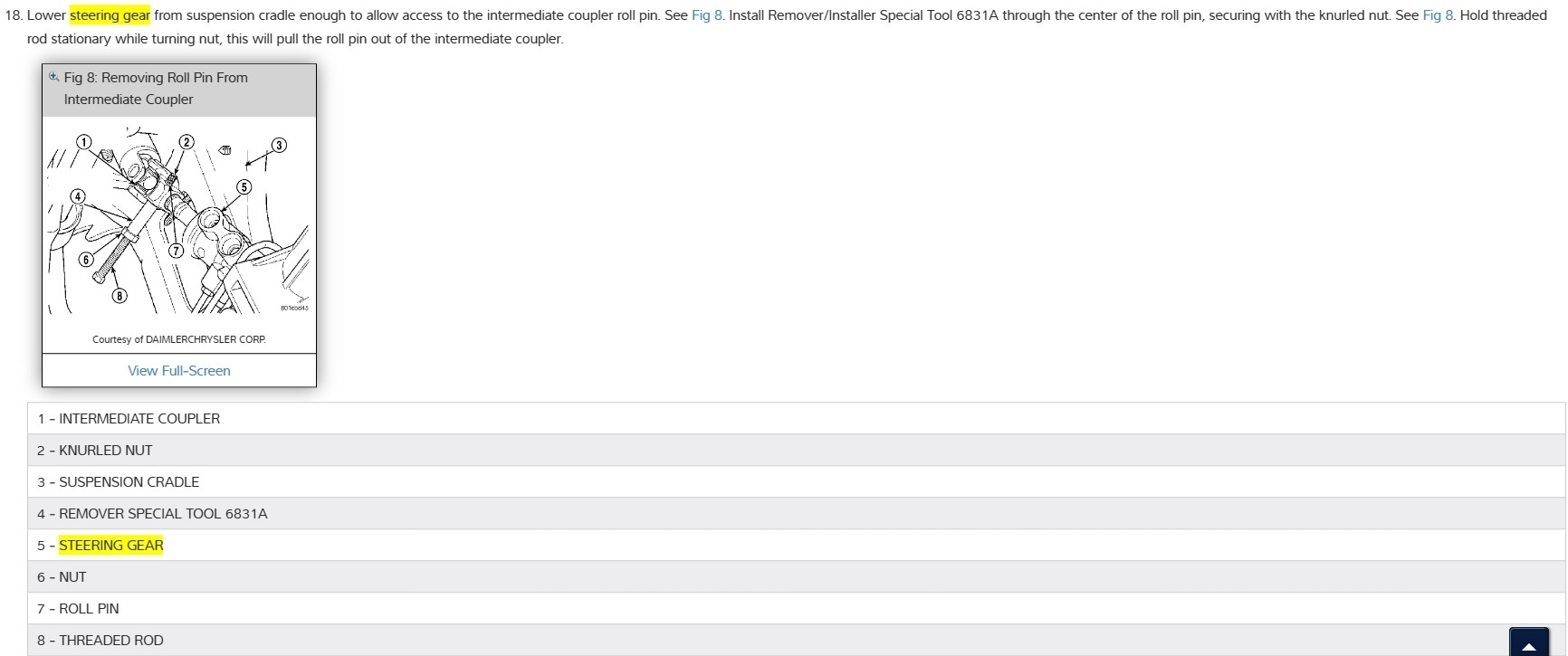

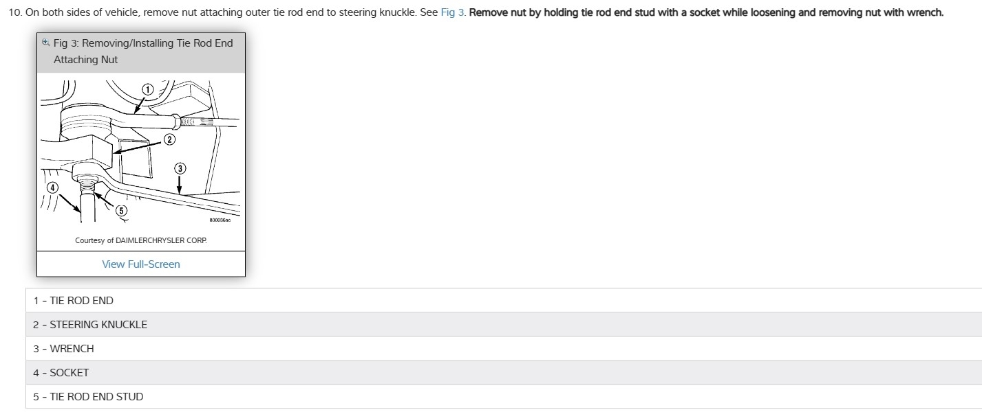

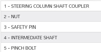

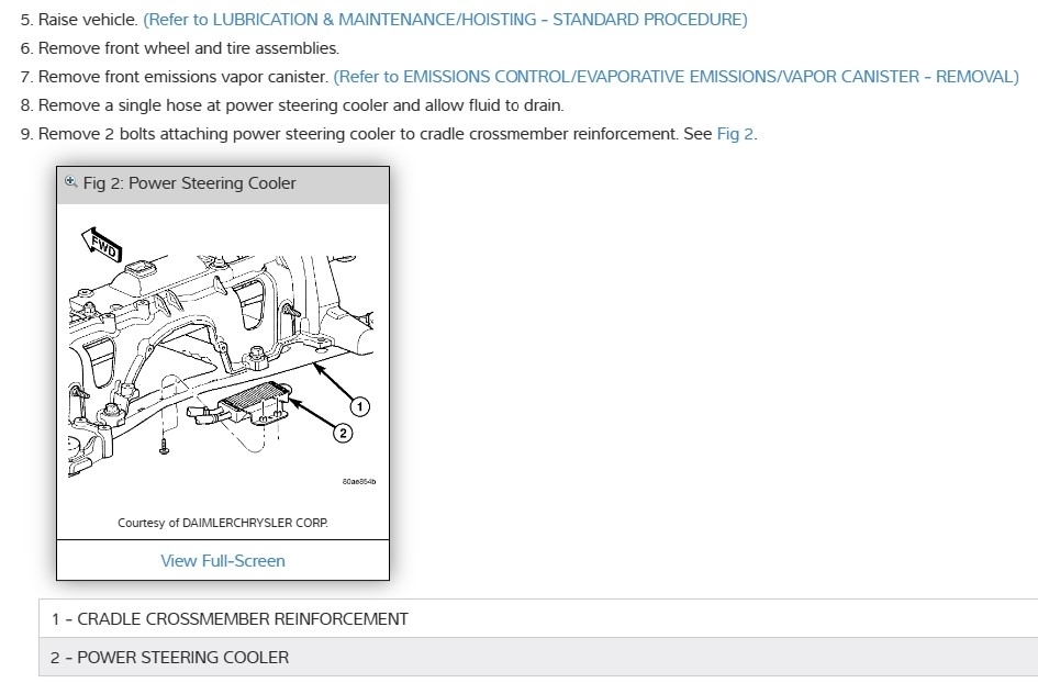

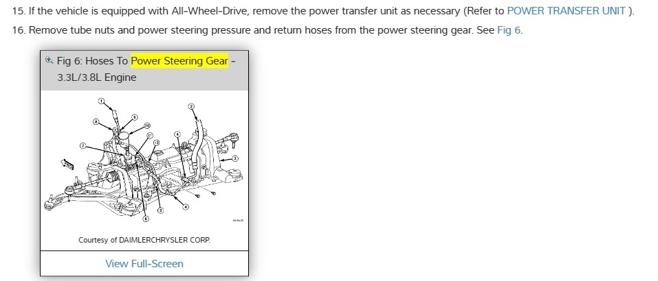

I am adding the entire removal procedure for you. Everything is in order. Some images only contain a legend and, in that case, will be for the image that is right before it. Unfortunately, I couldn't fit some things in the same image.

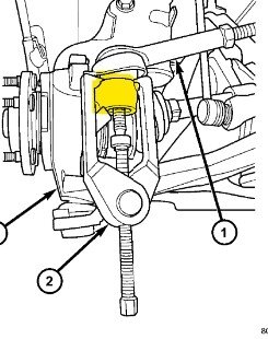

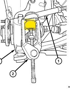

For the tie rod ends, once the nut is removed you can whack the spot the tie rod end connects to on the knuckle with a good heavy hammer and it should pop it loose rather than having to use a puller or special tool. The last image will show you this. I highlighted the area to hit with a hammer.
If you need any other information just message me back.
