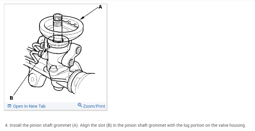

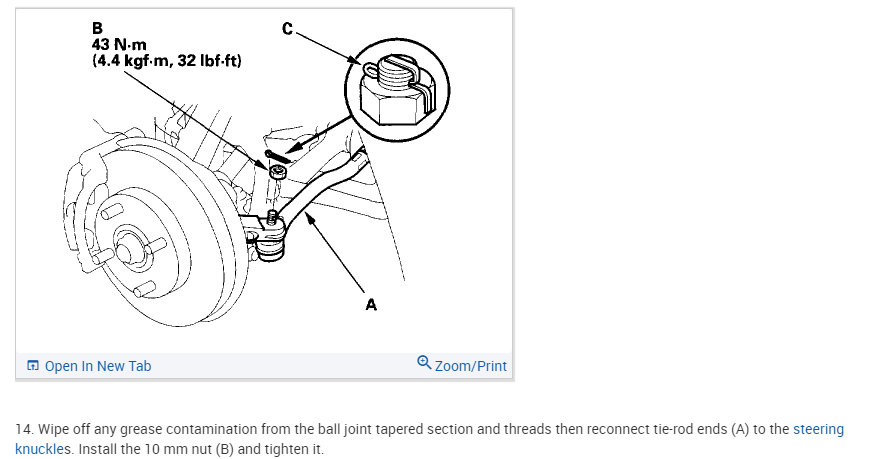

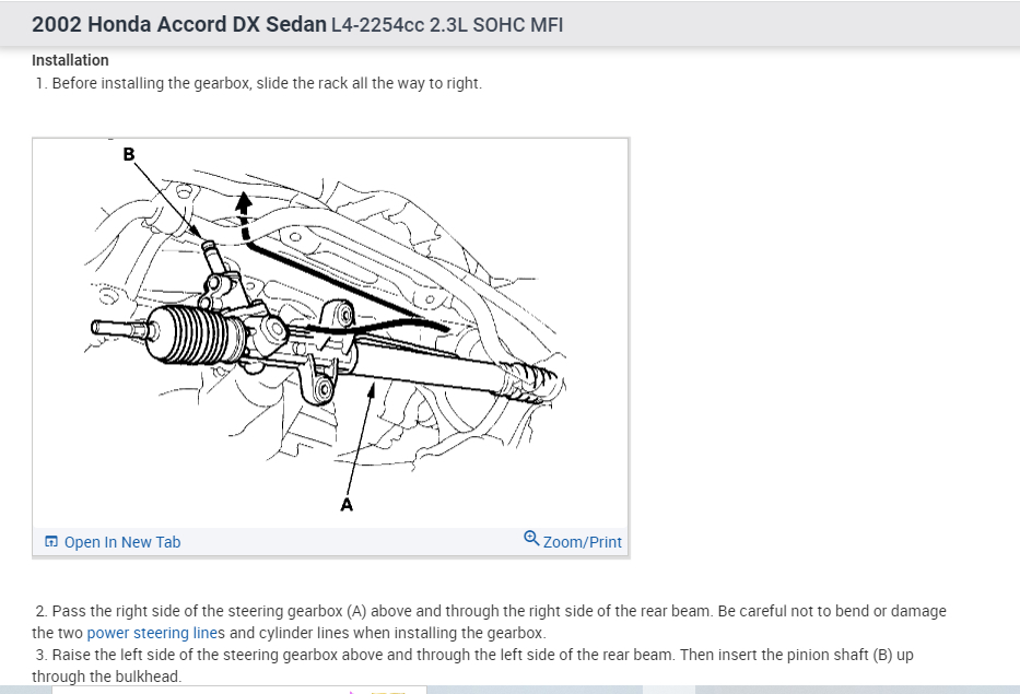

Just changed my rack and pinion when I took it for the alignment, they said it’s due to the rack and pinion not being center. Why would the rack and pinion make a rubbing noise for not being on center. How would I fix it?
Sep 17, 2022 at 12:48 PM
  • 110,248 POSTS

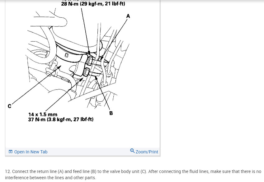

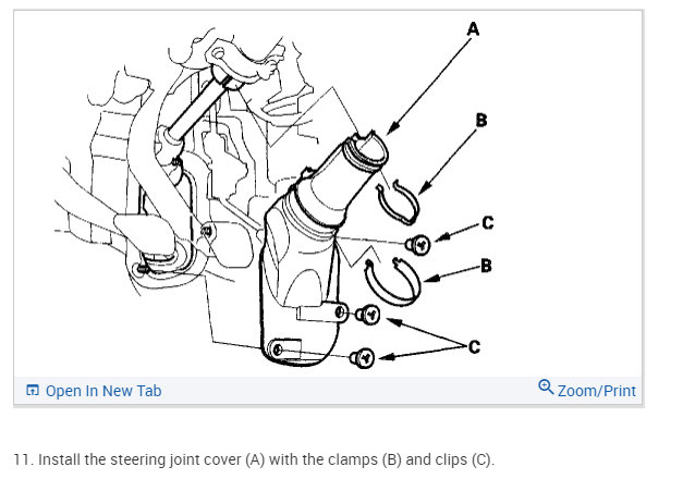

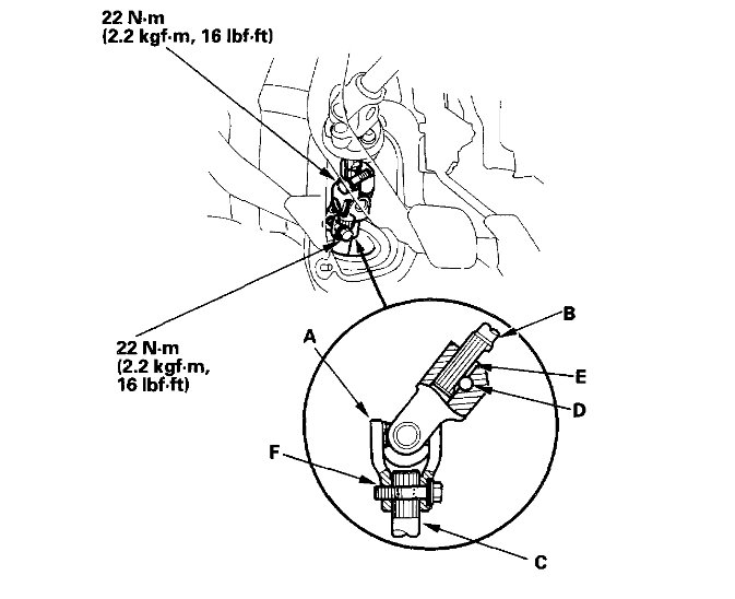

I'm not when you hear the noise and its sound. I can say the steering joint could be hitting, the steering shaft cover could be misaligned, and so on.

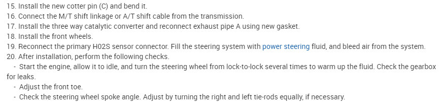

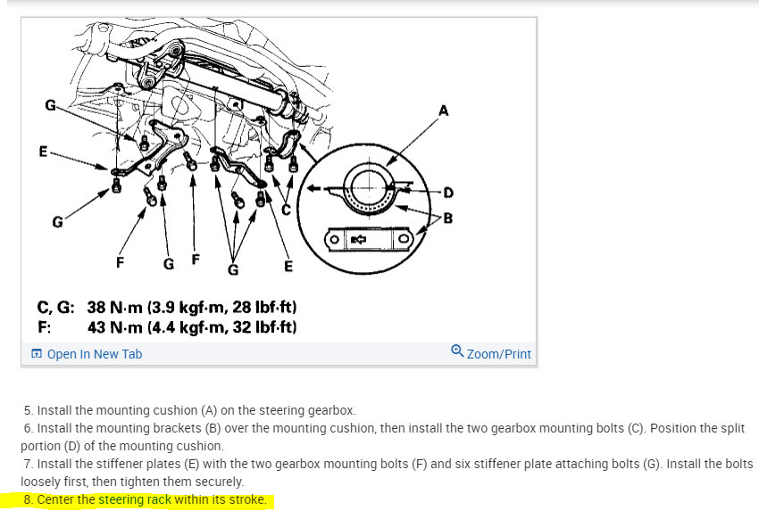

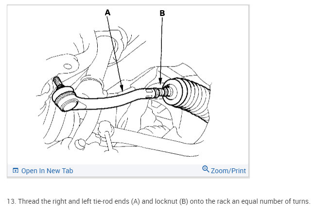

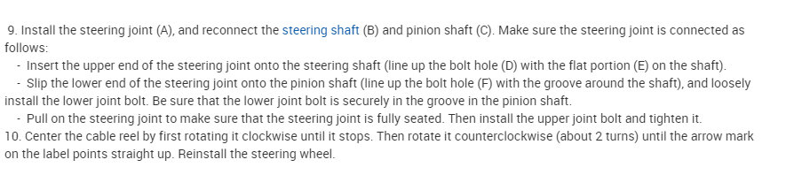

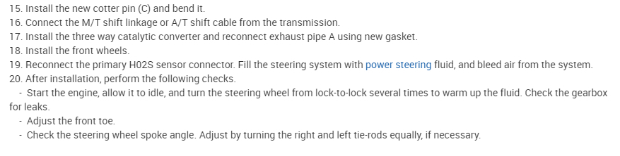

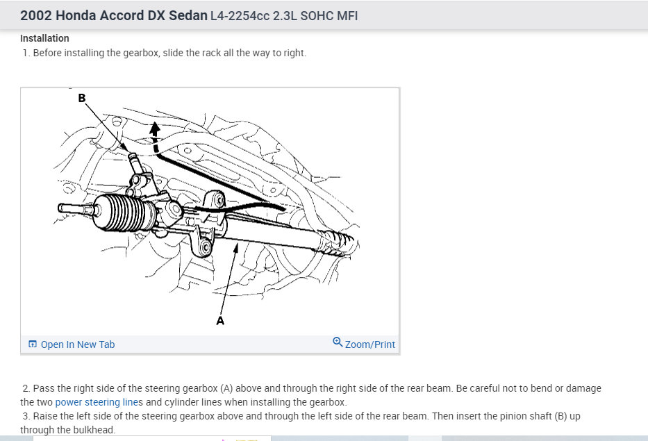

I attached the installation directions below for the rack and pinion. Take a look through them and see if there is anything that may have been missed.
see pics below.
