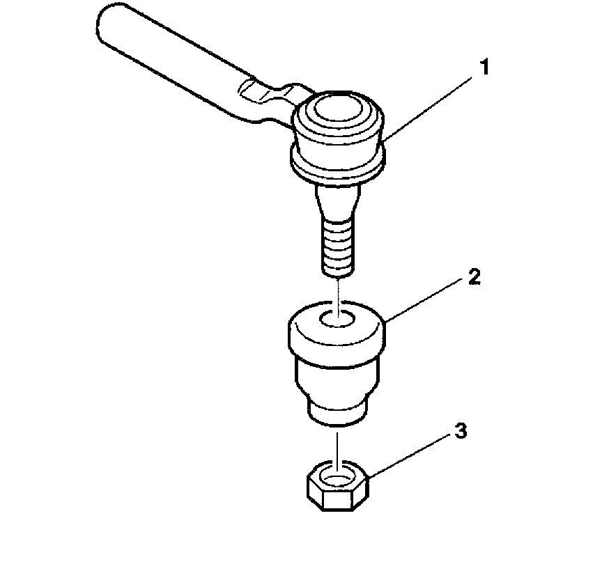

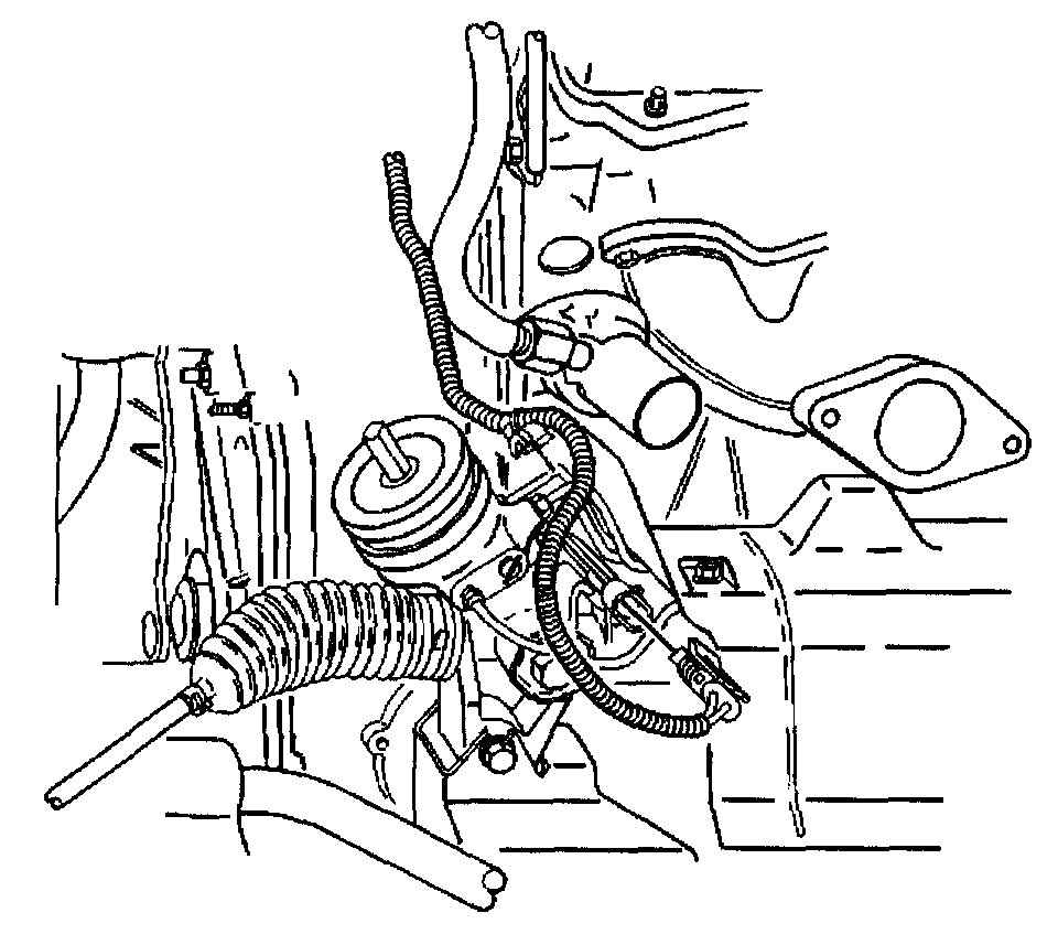

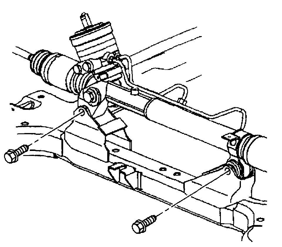

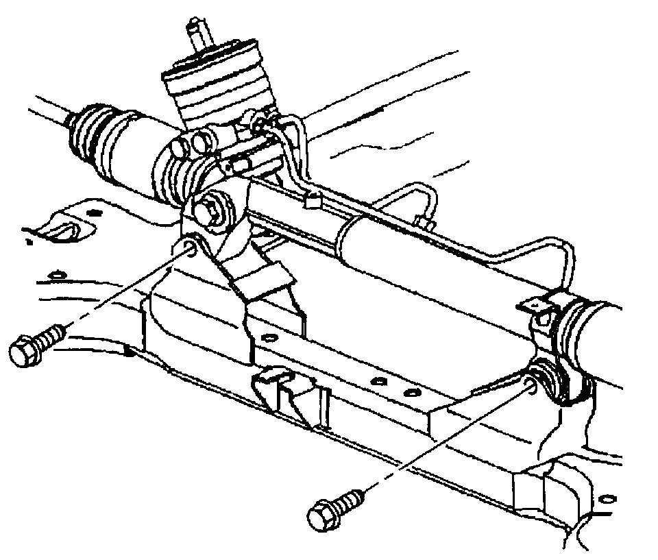

Here are the directions for replacement. The attached pics correlate with the directions.

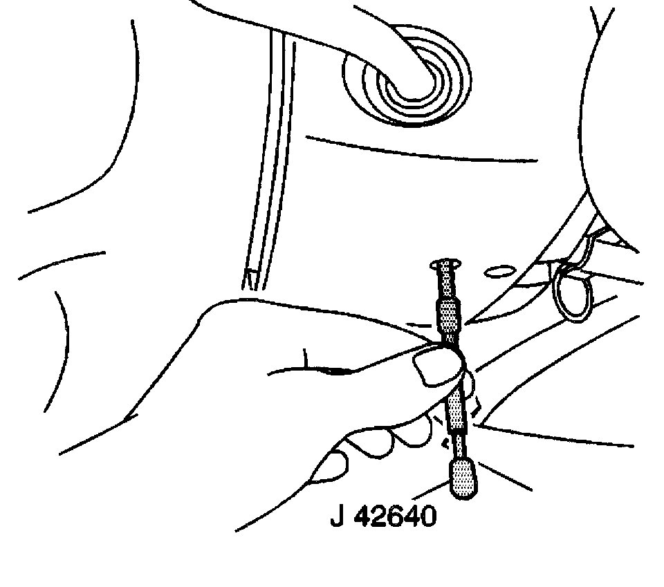

1. Lock the steering column by installing the J 42640 into the underside of the steering column.

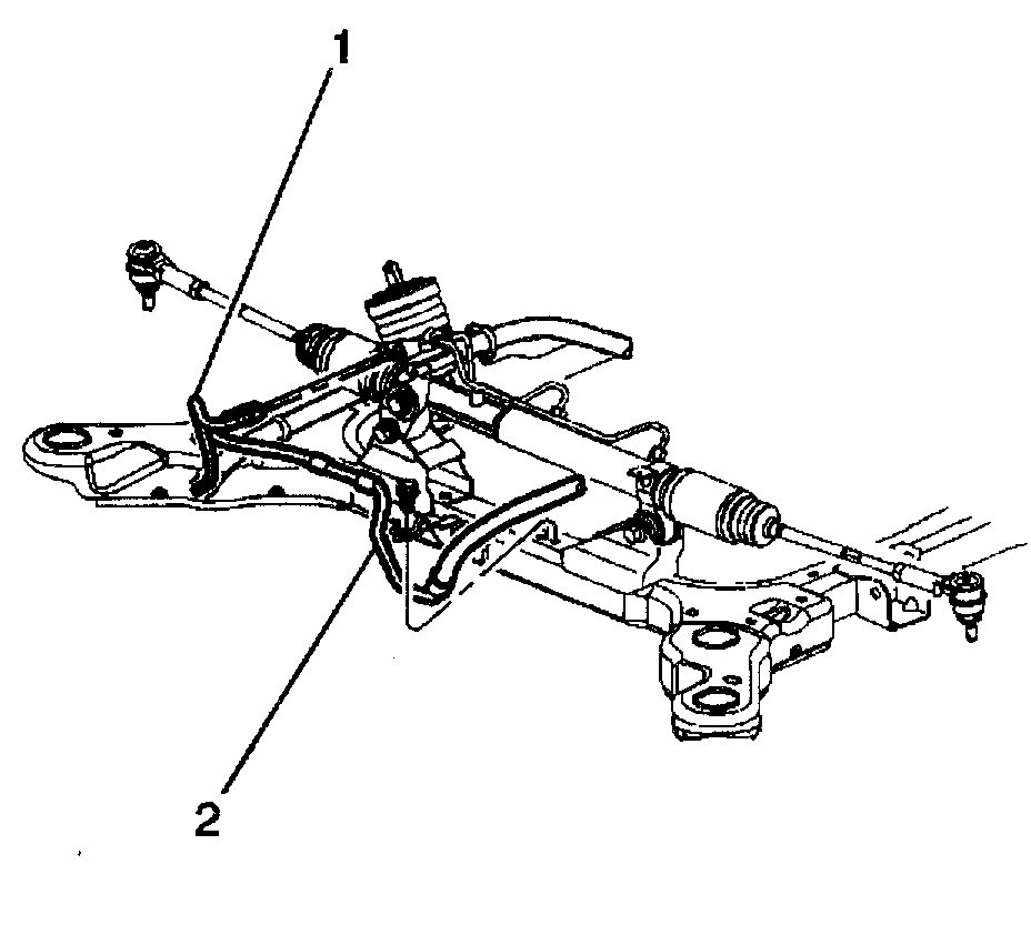

4. Remove the power steering gear heat shield. See: Steering Gear > Procedures > Power Steering Gear Heat Shield Replacement

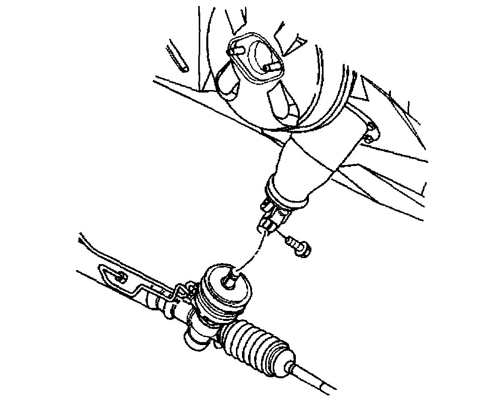

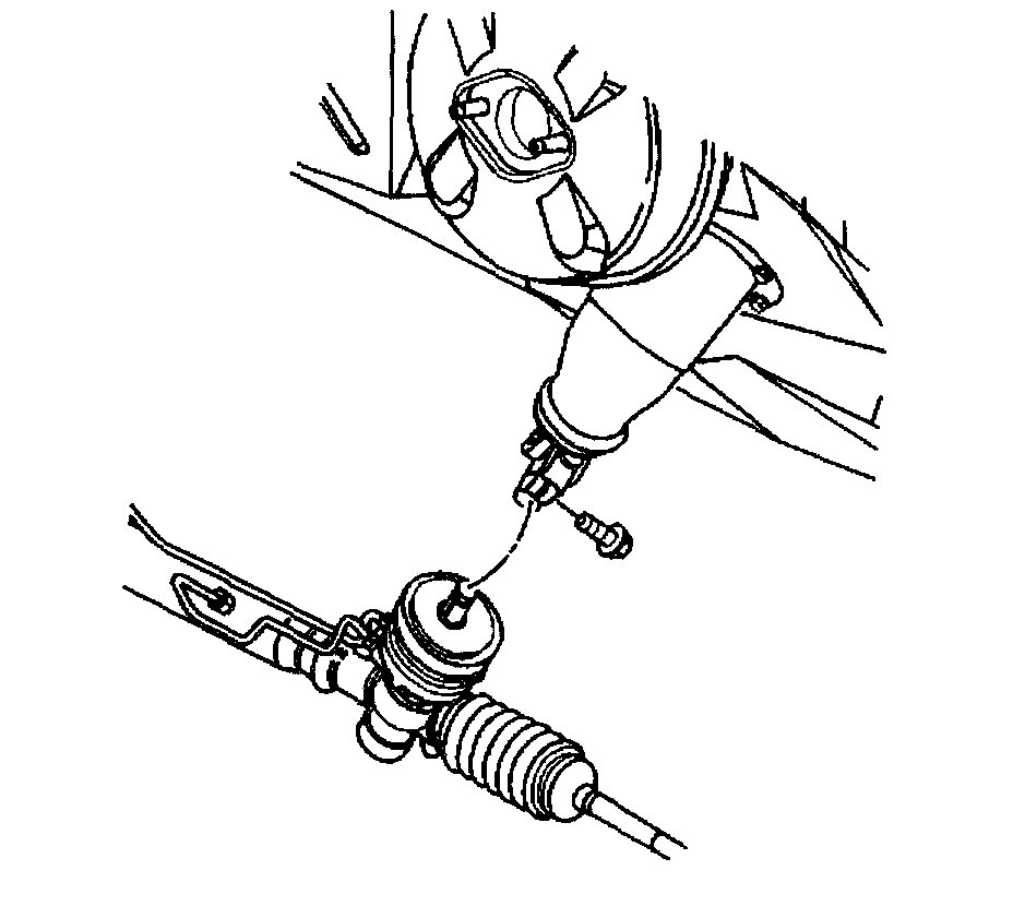

5. Remove the intermediate shaft lower pinch bolt.
6. Separate the intermediate shaft from the power steering gear.

7. Remove the outer tie rod retaining nuts.

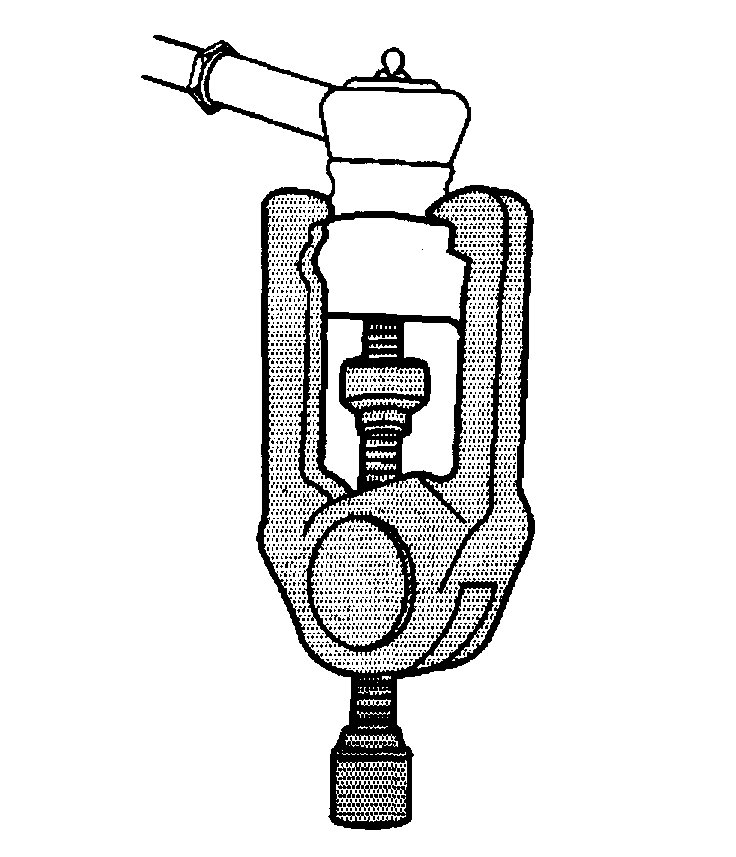

8. Using J 24319-B separate the outer tie rods from the steering knuckles.

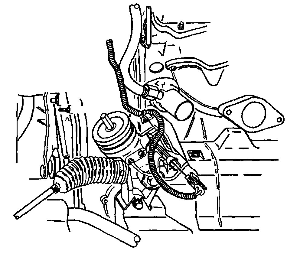

9. Remove the power steering pressure hose (2) from the power steering gear.
10. Remove the power steering return hose (1) from the power steering gear.
pic 5
11. If equipped, disconnect the variable effort steering electrical connector.

13. Remove the power steering gear mounting bolts.
14. Remove the power steering gear through the left wheel opening.
15. Transfer the outer tie rods if replacing the power steering gear.

1. Install the power steering gear through the left wheel opening.
Notice: Refer to Fastener Notice in Service Precautions.
2. Install the power steering gear mounting bolts.
Tighten the power steering gear mounting bolts to 95 Nm (70 lb ft).

8. Install the outer tie rods to the steering knuckles.
9. Install the outer tie rods retaining nuts.
Tighten the nuts to 30 Nm (22 lb ft) plus an additional 180 degrees.

14. Remove the J 42640 from the steering column.
