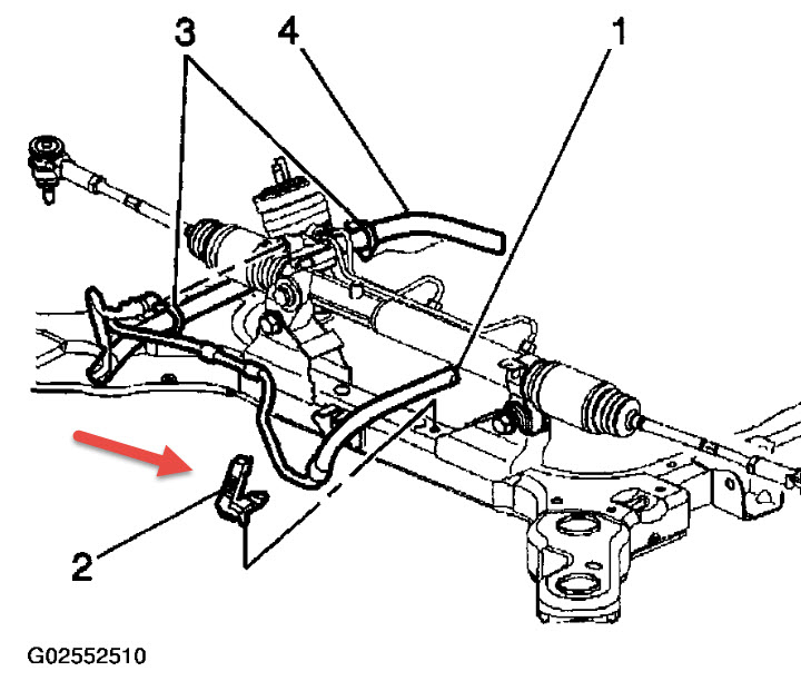

Can't get the line out
Mar 13, 2016 at 7:50 AM
HMAC300
  • 48,601 POSTS

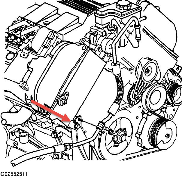

lift vehicle use jack stand to support, remove shield and bracket remove bolt holding line to engine see pictures this is for a 4.0L, but yours will be similar.
Mar 14, 2016 at 12:49 AM
HMAC300
  • 48,601 POSTS
Here's the other picture. Please let me know how it goes.
