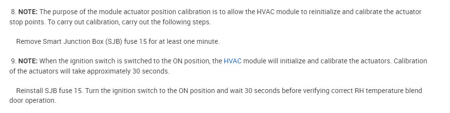

It sounds like the actuator motor itself. You can remove it and see if it responds when you change the temp request. Also, you can check to see if it is getting power.
As far as calibration, I attached that portion of the directions below. Take a look at them and let me know if that is what you are doing.
I feel bad asking, but which one isn't working? The right was replaced but you also remove the left that doesn't have a gear issue. Is it working? Is the new one on the right side not working?
See pic below.
