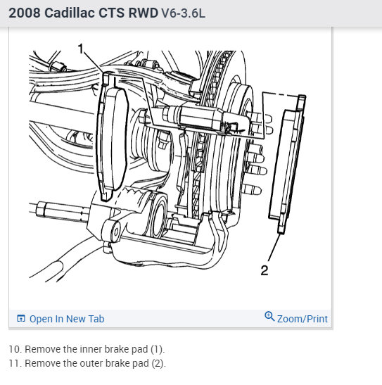

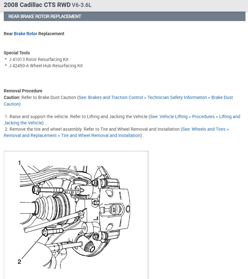

Looking for approximate estimate / pricing on 2008 cts manual trans. 3.6 L. Getting all brake pads/ rotors done as well as right rear wheel bearing. looking for the low - high range that it would cost.
May 12, 2014 at 1:49 AM
SQM
  • 6,383 POSTS

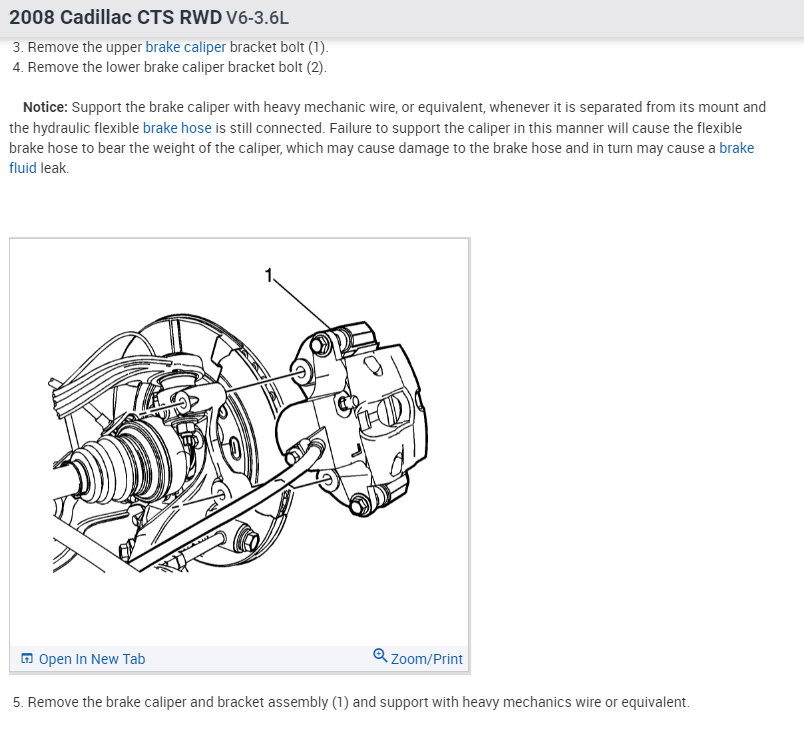

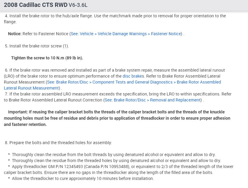

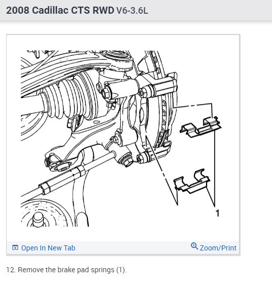

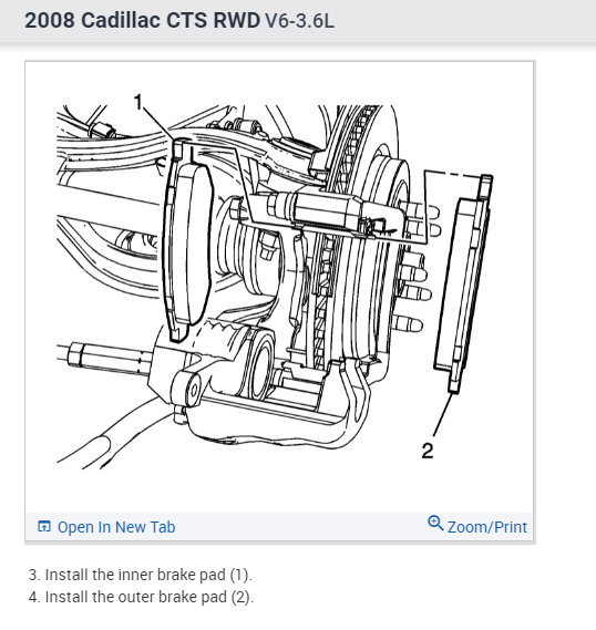

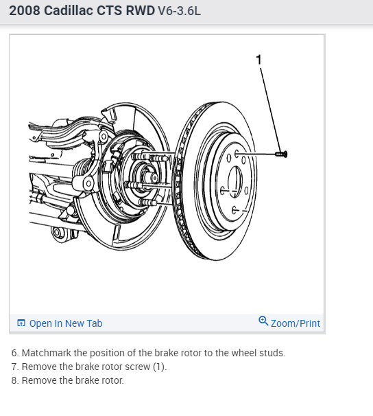

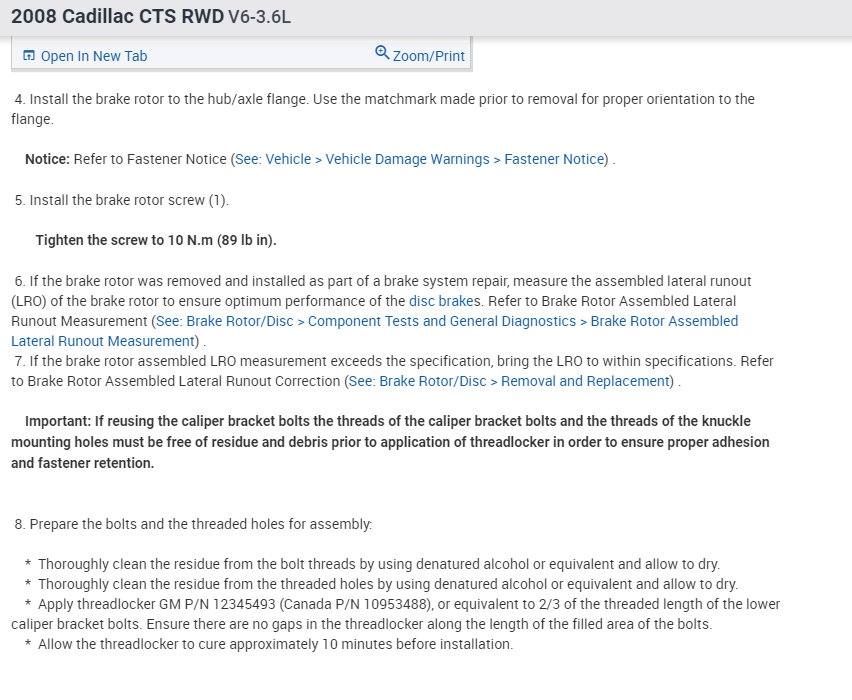

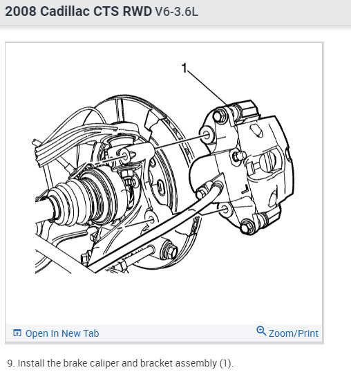

On this vehicle the brake pads and rotors can cost anywhere from $180.00 - $400.00, depending on the brand and quality of the product.
As for the labor it will depend on where you take it to get completed. It does take 3-4 hours to complete. So, depending on the labor rate for a given shop it will vary.
Here are a couple of helpful guides:
https://www.2carpros.com/articles/how-to-replace-rear-brake-pads-and-rotors

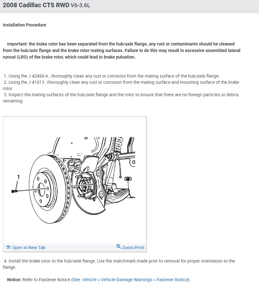

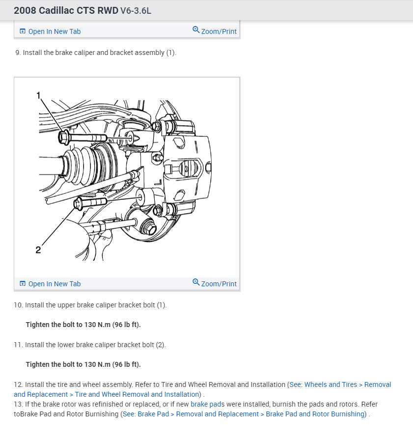

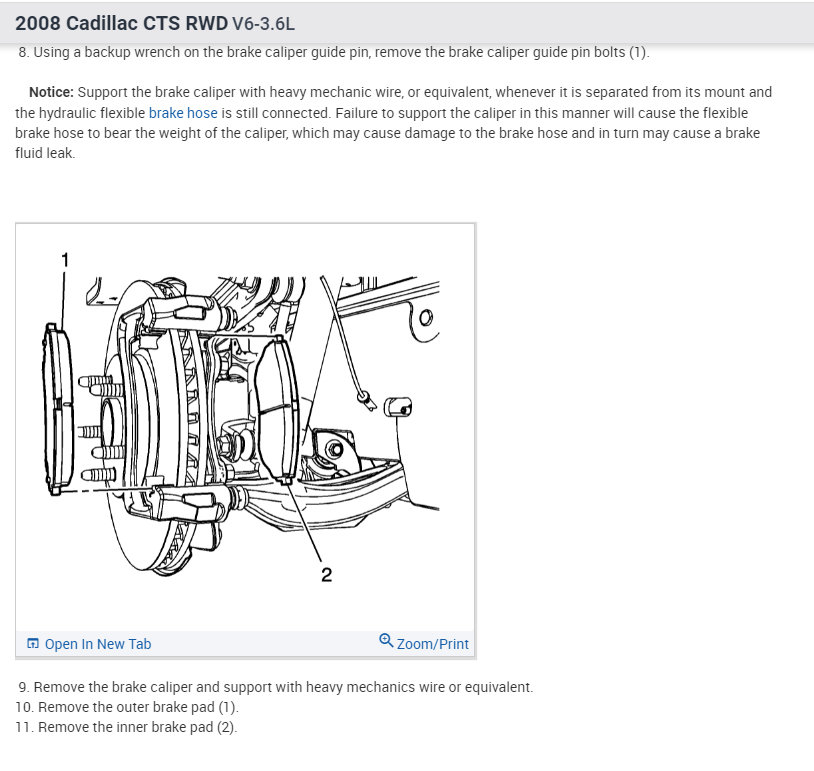

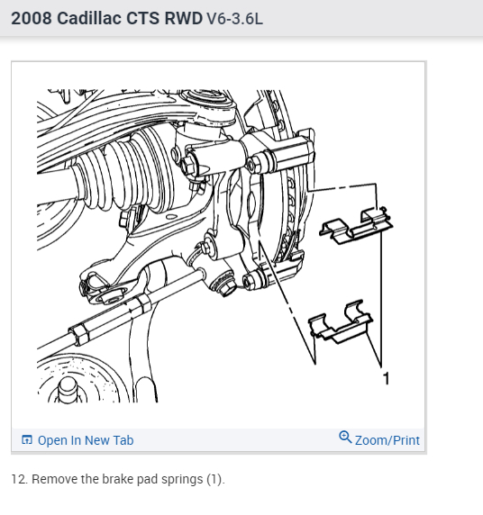

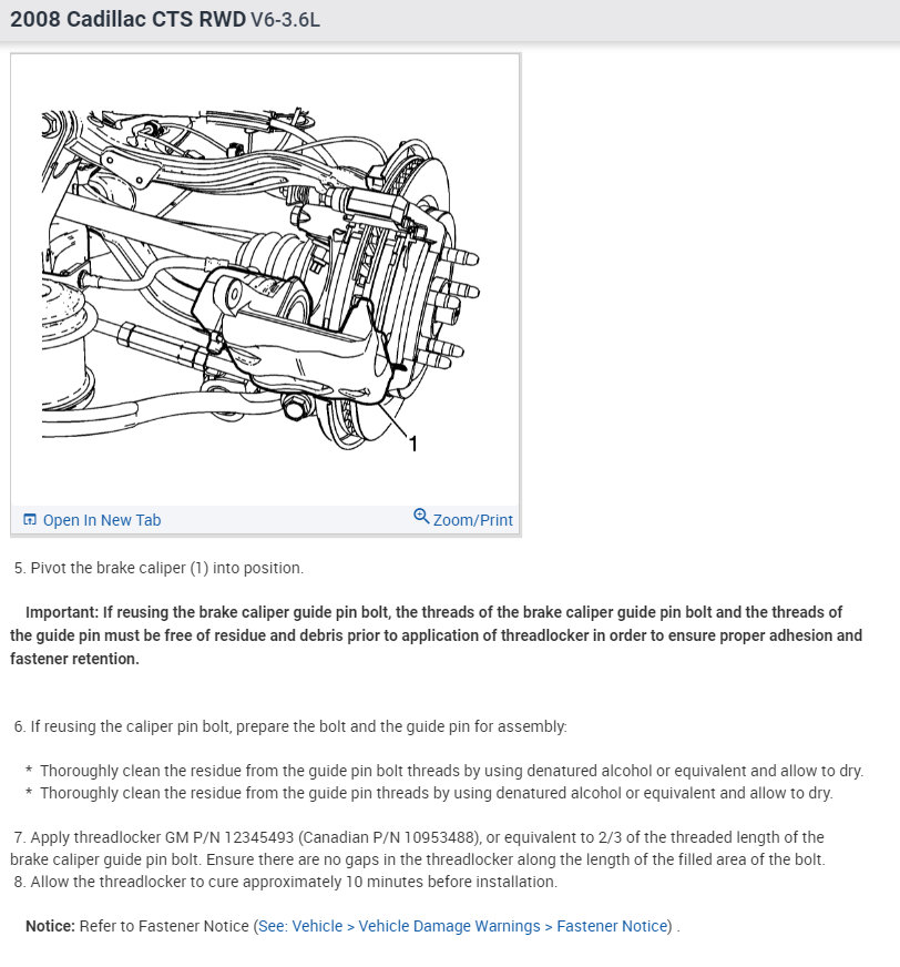

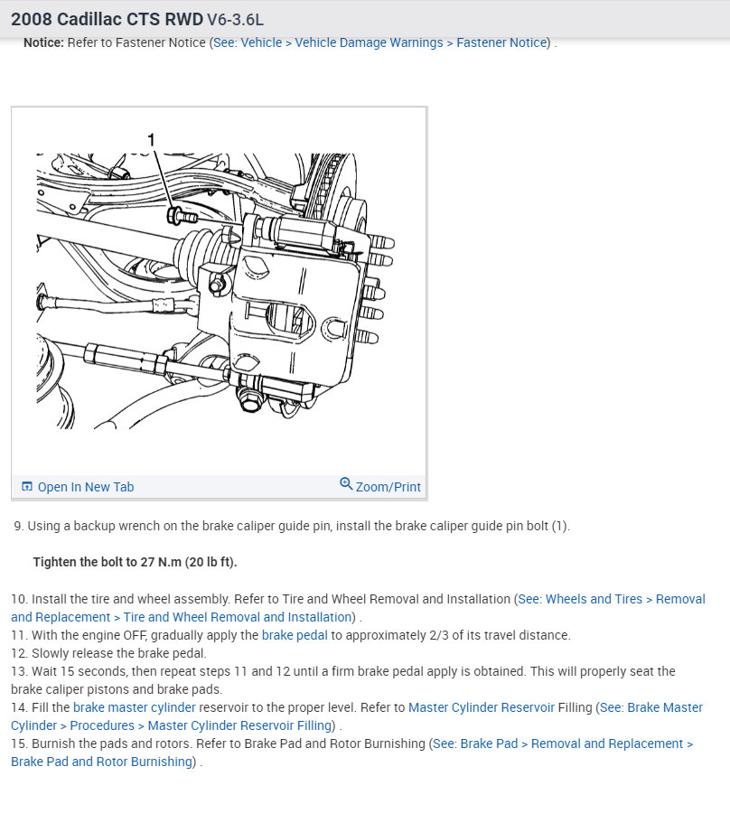

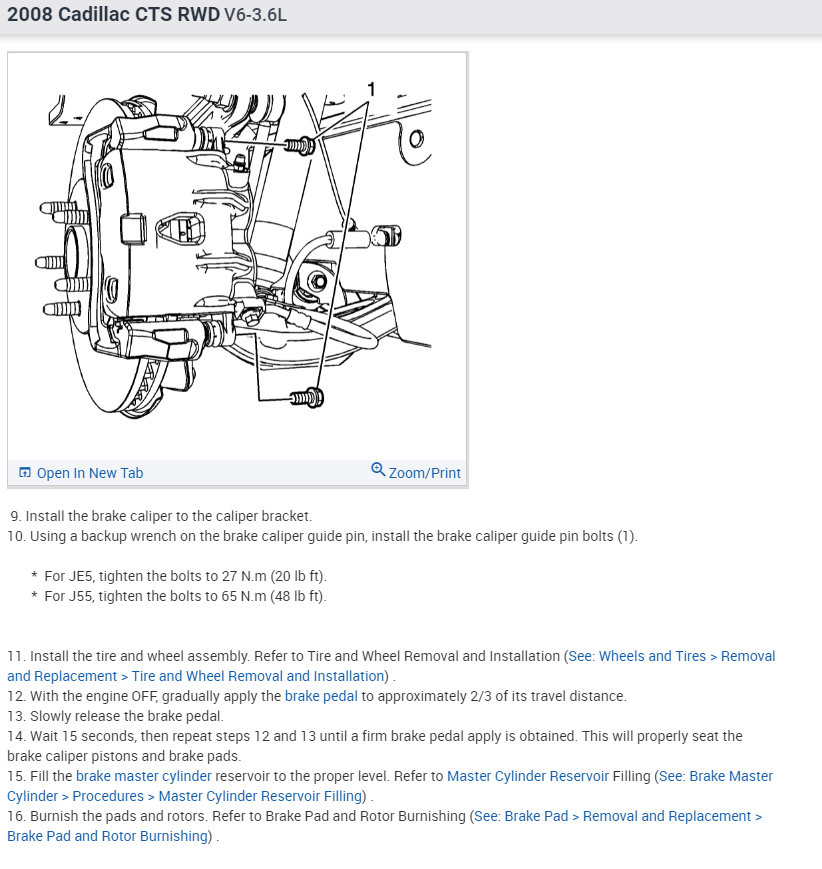

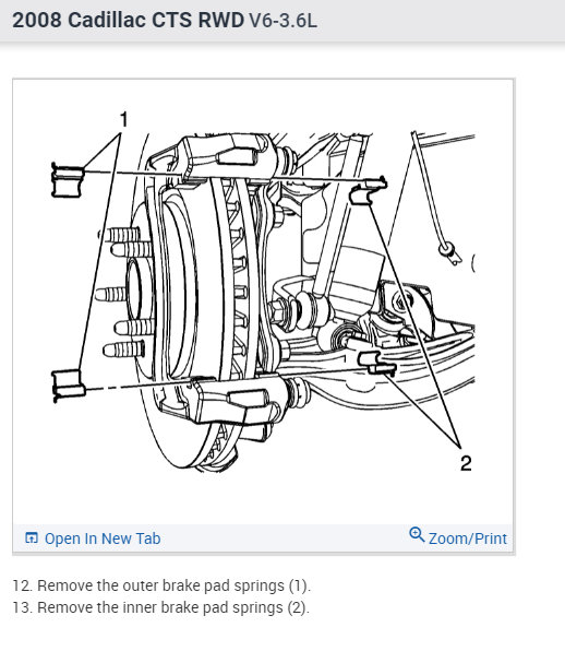

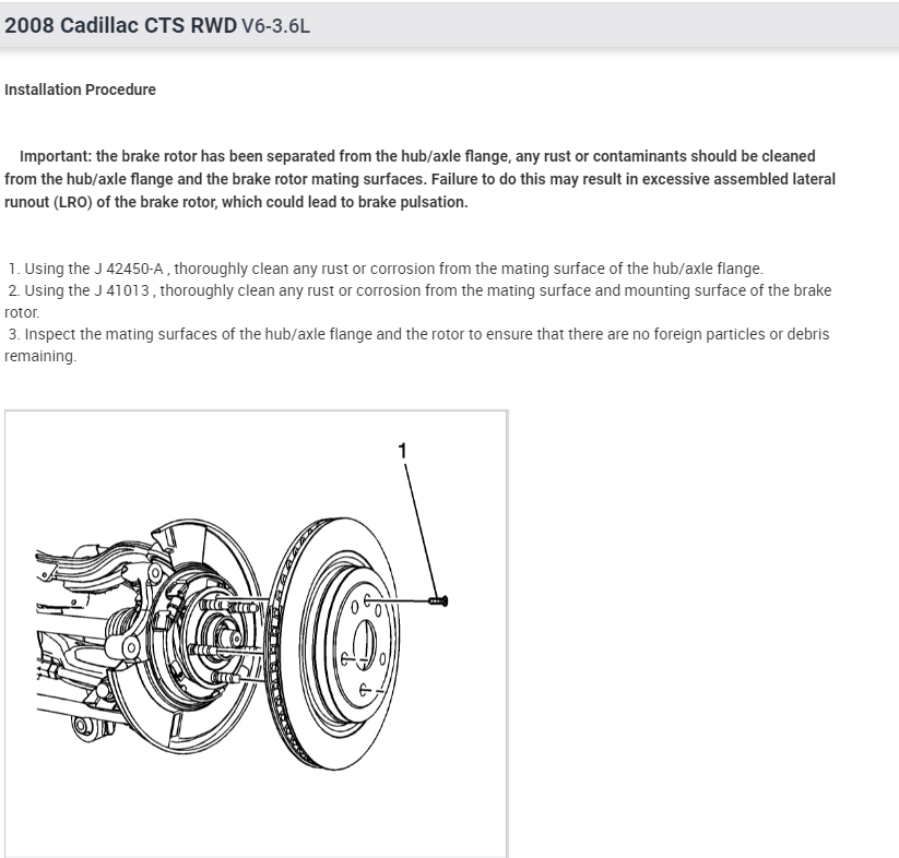

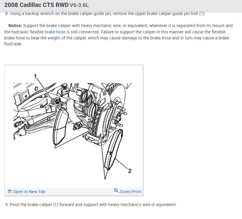

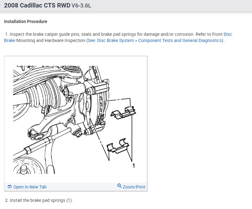

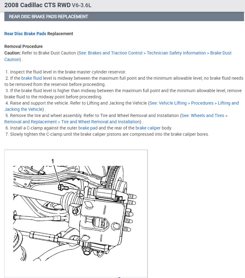

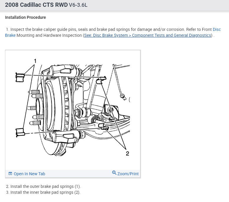

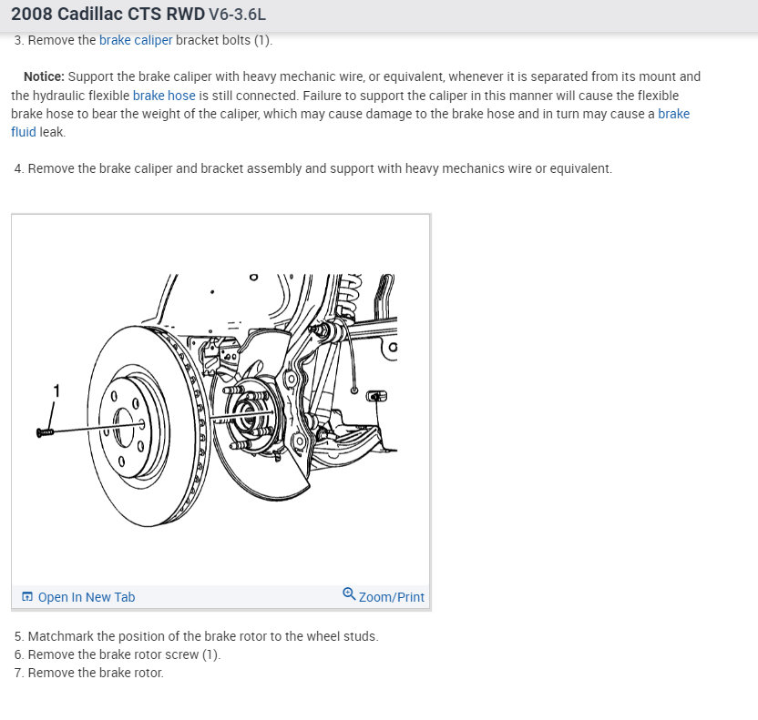

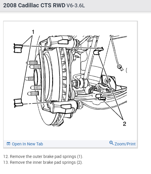

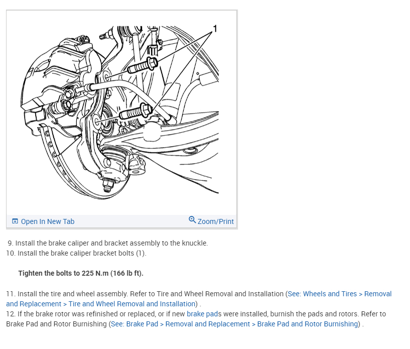

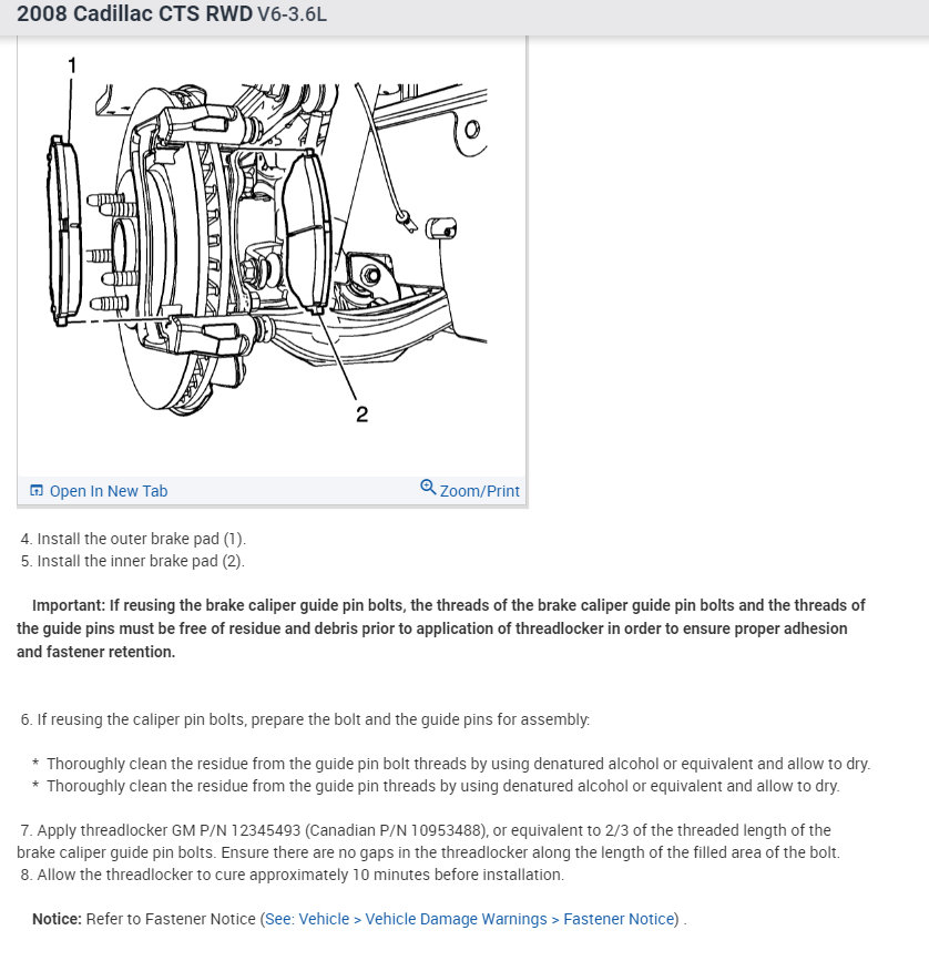

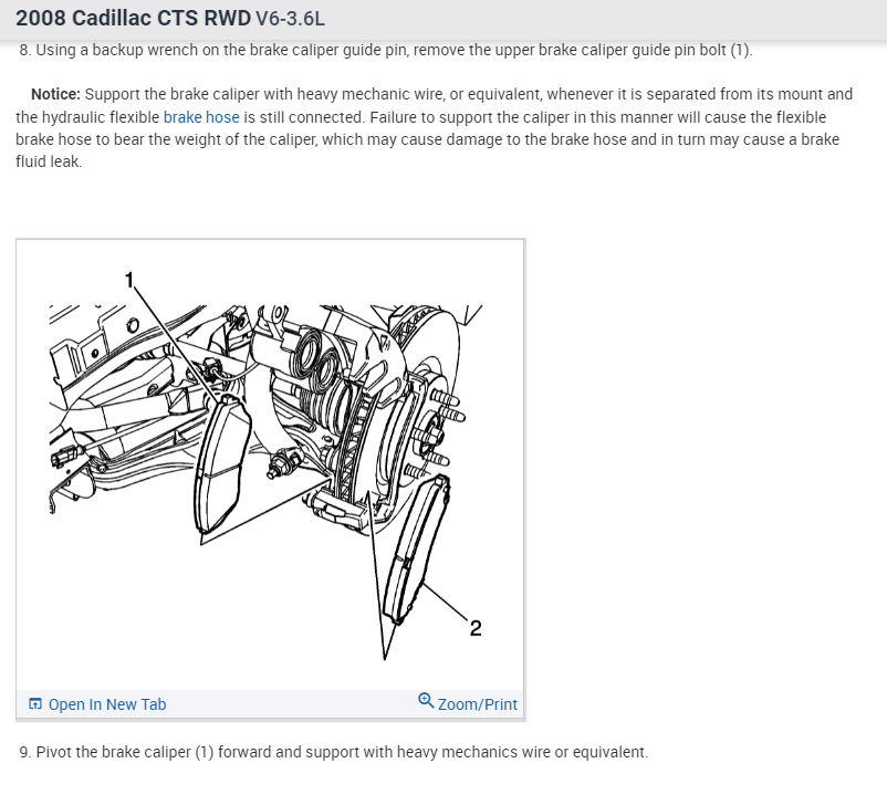

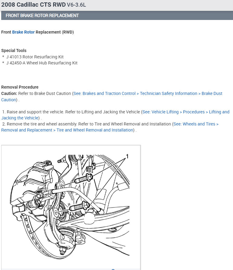

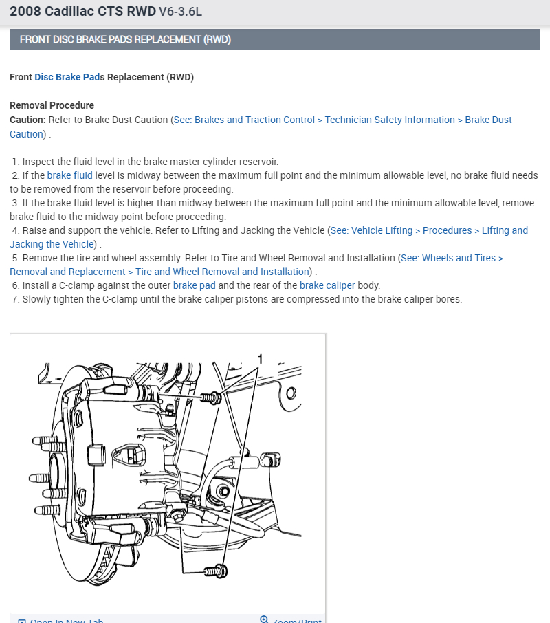

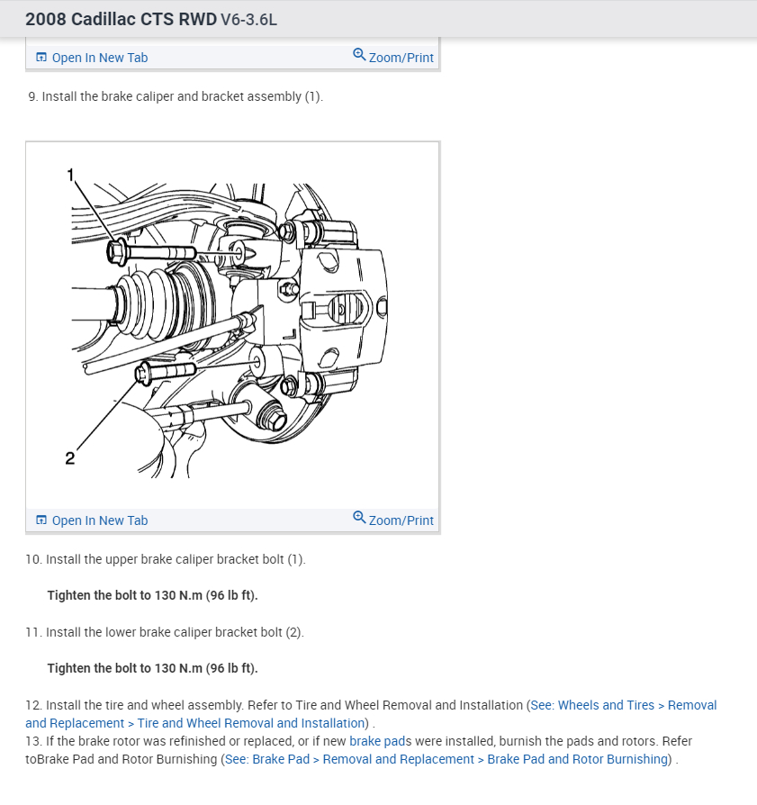

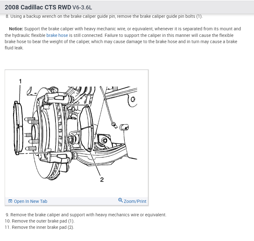

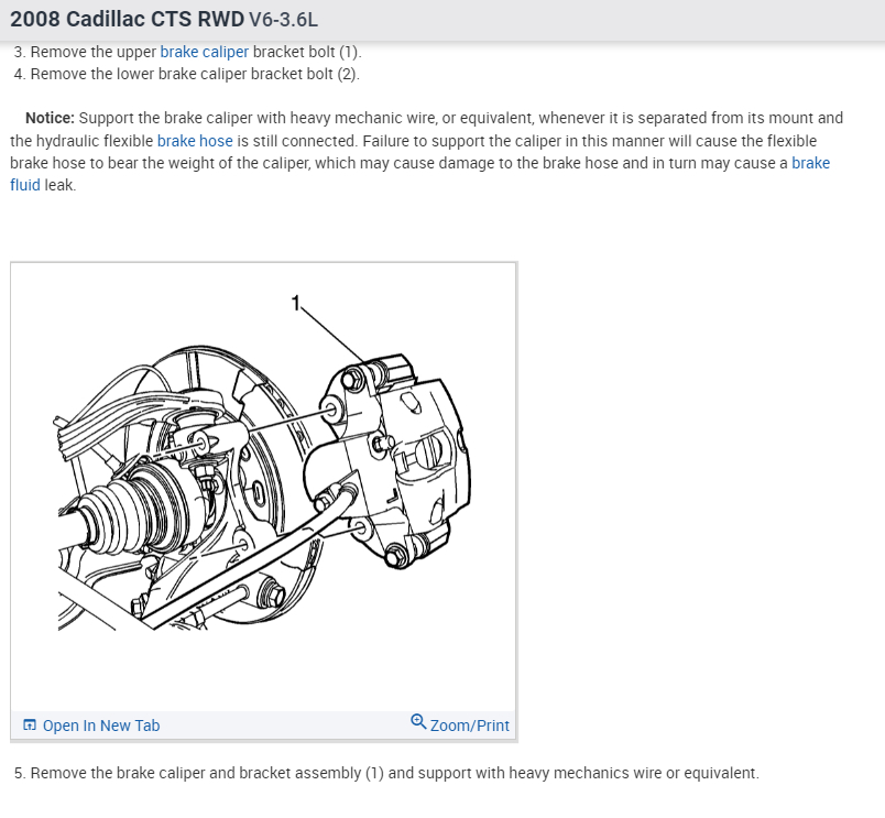

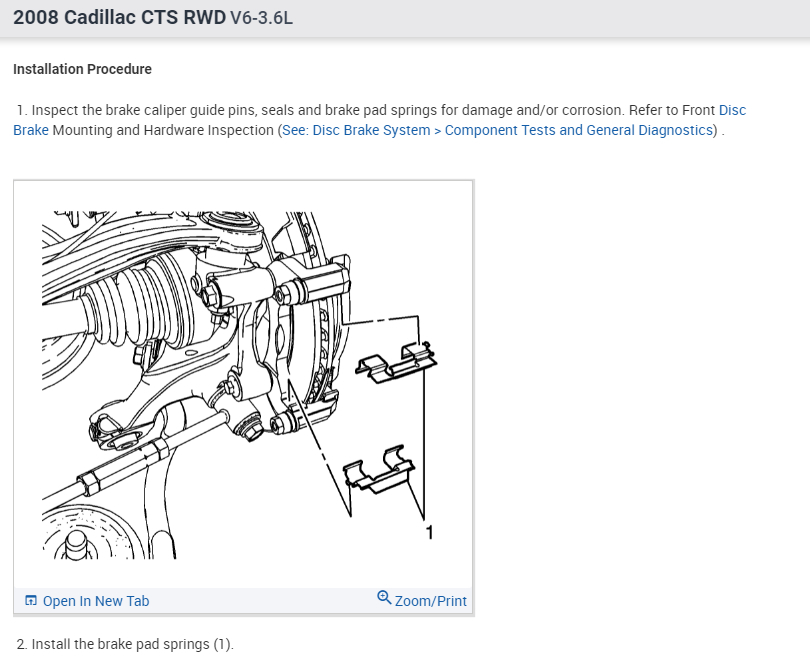

I have attached diagrams of the brake pads and rotors replacement procedure below.
