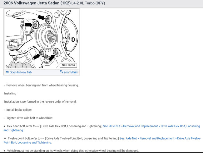

TDI automatic DSG transmission. I know the DMF is chattering when in neutral or park. I’m replacing the DMF next week. But when I’m driving at low speeds there’s a quiet grinding noise until i reach about 20-25 MPH. It goes away once I’m up to speed. Seems to make a different grinding noise when i make a sharp turn maybe. Any ideas? Is this the DMF grinding?
Jan 9, 2019 at 4:47 AM
  • 55,785 POSTS

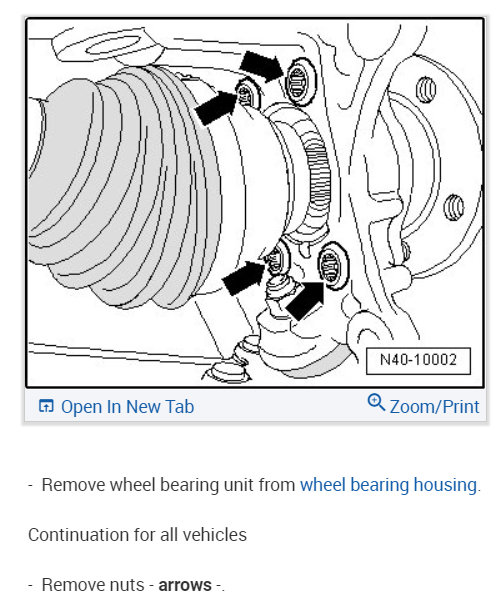

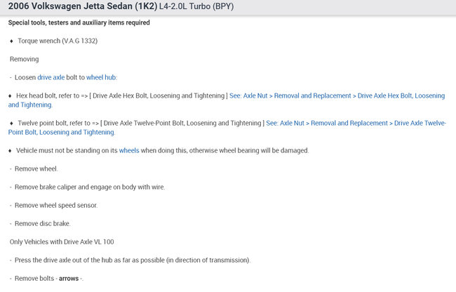

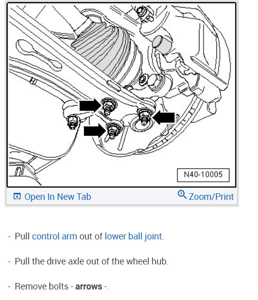

This sounds like a front bearing hub needs to be replaced. Here is a guide that will walk you through the repair with diagrams below to show you how its done on your car:
https://www.2carpros.com/articles/bearing-hub-replacement
I would do both sides. Check out the diagrams (below). Please let us know what happens.
