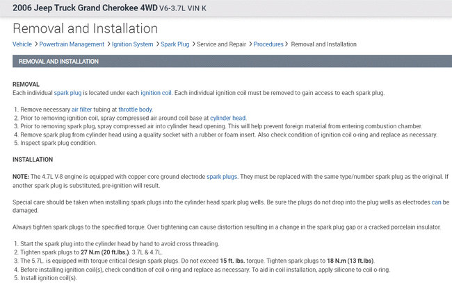

When changing the spark plugs do I need to change the coil pack as well or is that just recommended?
Dec 29, 2021 at 1:09 PM
  • 110,240 POSTS
Unless there is a problem with the coils, under normal conditions, only the spark plugs are replaced.
Here is a link you may find of interest if you are performing a tune-up:
https://www.2carpros.com/articles/how-to-tune-up-a-car-engine

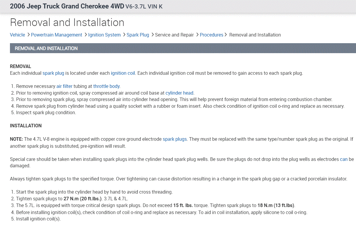

Also, the pic below is the directions for spark plug replacement on your vehicle.
I hope this helps. Let me know if you have questions or need help.
See pic below.
