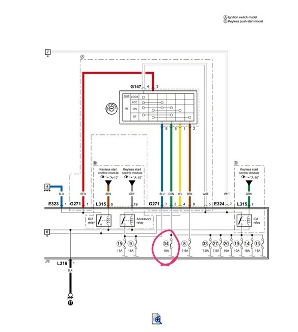

I have 2 questions on instrument cluster/android stereo and symbols on wiring circuit diagram.

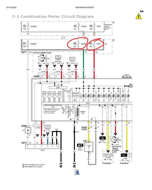

1. In the 1st of the 2 attached diagrams, there are 2 fuses 5amp and 10amp which go directly to the instrument cluster and appear to supply all the same components. Now, what is the purpose of these 2 separate fuses? Does it mean when 5amp is blown, the instrument cluster will still get power from the 10amp or vice versa?

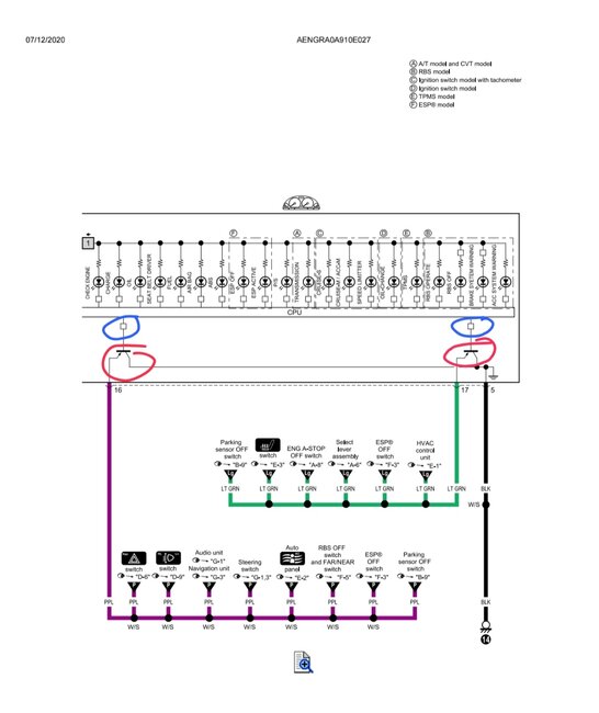

2. In the 2nd diagram, the red marks are a npn or pnp transistor? So also, what are the blue marks which has SQUARE empty box? What does this box represent?

Each fuse powers different parts of the panel. For instance one may be a power feed that goes to the illumination while the other powers the processor circuitry. One may also be switched power and one full time, that isn't shown in the diagram.
Boxes are connection points. Those are both shown as PNP, however that doesn't mean that they actually are the type used in that application, they just use it to show it is a transistor switched circuit instead of a relay. A quick tip on NPN vs PNP = Not Pointing iN represents NPN. Points iNward Pointing = PNP

Follow ups of the 2 diagrams, i confirmed that the 5amp is always hot, and the 10amp is hot when key at on or engine running.
If so, then, how these 2 voltages are controlling the different LEDs.
How does 2 voltages work?

They simply provide power to the systems, not just the LEDs. That power goes into the different modules and into voltage regulators and then it is sent to the various items that need power. The 5 amp is likely the one that is used to hold the memory items, and the 10 amp is used for active power for the remainder. So, the power for the gauges and displays as well as the lighting are all powered off it. For the illumination that would be a regulator, then a controller for the brightness and the LEDs in the array. Those parts would be in both of the modules. As such we know the issue isn't likely to be something in the "radio" or the instrument panel as they do not share the same components internally but they both are seeing the reduced brightness. So, you need to look at the components they share. The only obvious one is the dimmer control and its tie into the CAN network. A scan tool connected up might show you the brightness level in the body control module.
