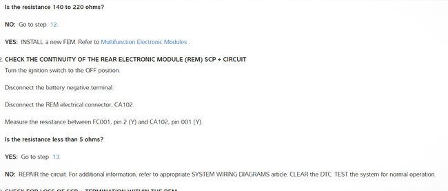

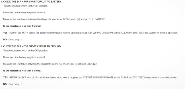

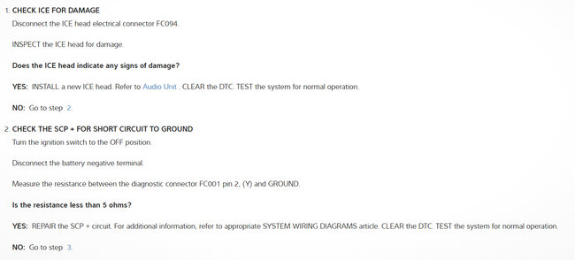

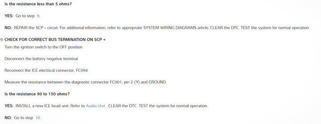

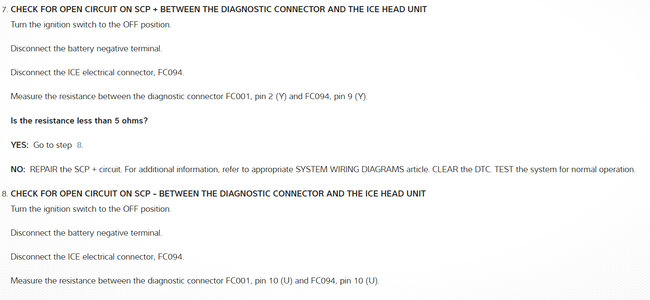

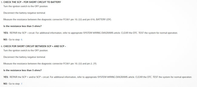

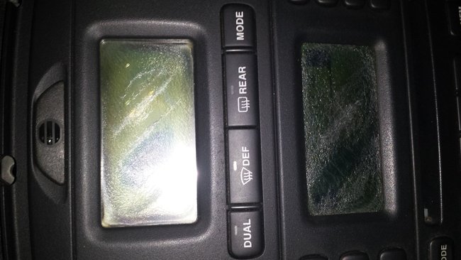

Hello, the screen is frosty, the radio does not work .However ,the clock shows the time but it is hardly visible.Can it be fixed please.?Thank you.Please see image below.
Feb 11, 2019 at 3:53 PM
SCGRANTURISMO
  • 4,897 POSTS

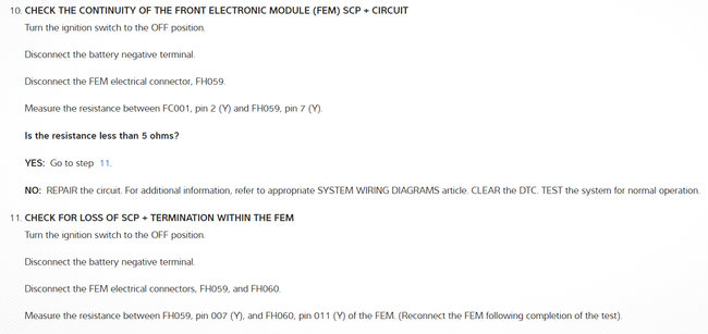

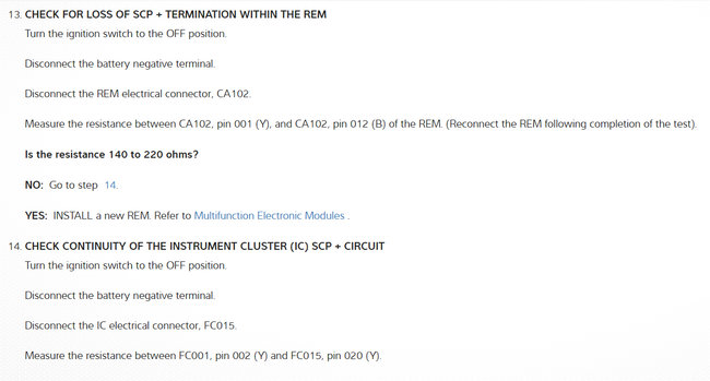

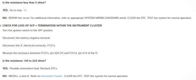

This is probably a problem with your In Car Entertainment(ICE) head unit. In the diagrams below I have included a step diagnostic checklist to determine what the problem is and how to fix it. Get back to us when you find out what it is, and let us know what you did to fix it.
Thanks,
Alex
