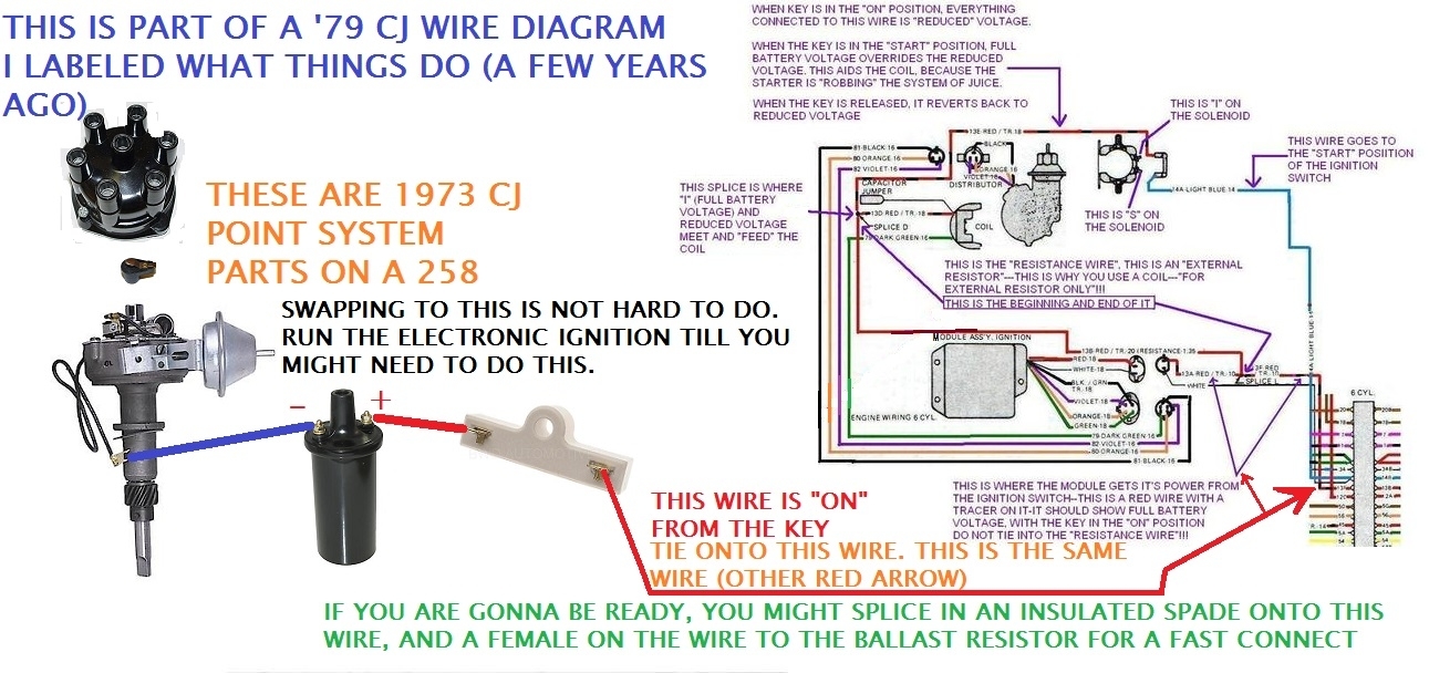

I am creating a bug out vehicle and part of it is making the Jeep EMP proof. Can the ignition module be removed and not replaced? If so, can you describe the steps to achieve this objective. Thank you for your time and thank you for your service.

Minor wiring changes will allow you to use an early distributor with points inside.
May be able to use it either way with just changing the distributors and using the appropriate harness to it (that you pre-assemble)

OK,
It might be possible to use some of the stuff you already have in a bind
To make this simple and all for sure compatible (already proven to work together, as they are for a 1973 258 application)
You are gonna need one of these:
https://shop.advanceautoparts.com/p/cardone-distributor-point-type-domestic-reman-30-1646/3850072-P?navigationPath=L1*14923%7CL2*15034%7CL3*16062#
Looks like it has a points and condenser set in it!
This goes with the above item
https://shop.advanceautoparts.com/p/bwd-distributor-cap-c168p/5201306-P?navigationPath=L1*14923%7CL2*15034%7CL3*16061#
This too is needed for the 1st item
https://shop.advanceautoparts.com/p/omix-ada-distributor-rotor-17246.07/10178897-P?navigationPath=L1*14923%7CL2*15034%7CL3*16061
One of these
https://shop.advanceautoparts.com/p/bwd-ignition-coil-resistor-ru12/20972203-P?searchTerm=ballast+resistor#
I like this particular one because the resistor coil is sealed inside the ceramic, some are exposed and will flop around and break.
And one of these
https://shop.advanceautoparts.com/p/driveworks-ignition-coil-26189/10703783-P?navigationPath=L1*14923%7CL2*15034%7CL3*16064
Now then, the hardest part!
Swapping the distributor.
Your plug wires will move to the new cap, do this in the same positions, in the same firing order sequence.
I'm sending a link (2) on replacing a distributor.
There are 2 ways to do this.
1) recording the rotor button position and the position of the 'dist. body', basically pull it out and put the other one in with everything positioned the same. DO NOT MOVE THE ENGINE while this is performed!
2) finding TDC, installing the distributor, when finished, the rotor button is pointing towards #1 wire on the distributor cap. THIS METHOD IS FOOL-PROOF, YOU DO THIS WHEN YOU HAVE SCREWED UP THE OTHER WAY, OR IF YOU ARE STARTING FROM SCRATCH.
With a 258 (and others) insure the distributor sits all of the way down. If it doesn't, the drive for the oil pump is most likely not lined up. Your distributor may be in right, you may have to lift it out of it's hole and "TWEAK" the oil pump shaft (deep in the hole) just a little bit with a long screwdriver. Then attempt to seat the distributor again. It may take a few "TWEAKS' to move it so the distributor shaft drops into it.
I made you a pic below using pics from the links I sent from Advance Auto Parts. This is just how EZ it is!

More questions? How's all of this a looking? Can you complete the mission?

Mission completed, all parts secured. Wiring changes made (not tested yet, but will soon) thank you for the detailed answer! Good instructions and diagrams. Thank you for using common sense answers. Those I understand.
