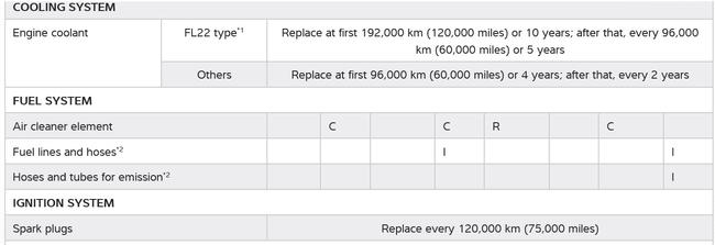

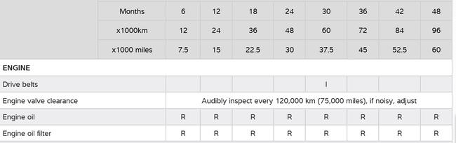

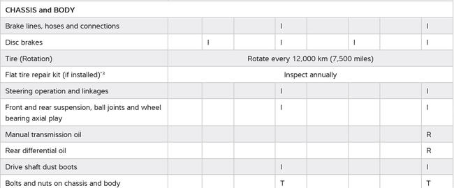

I have a 2010 Mazda MX-5 I bought with 10,000 miles on it. I called the local Mazda dealer to bring it in for a 10K mile checkup, they said all the fluids, radiator, brakes, differential, man transmission needed to be flushed/changed. Is that really the case? They actually looked brand new to me.
Sep 30, 2015 at 2:07 AM
HMAC300
  • 48,601 POSTS
if you have a manual it will be in there at back of book normally. You don'thave enough mileage to worry about any fluid change right now. see pics code is I=inspect L=lube R=replace C=clean T=tighten
