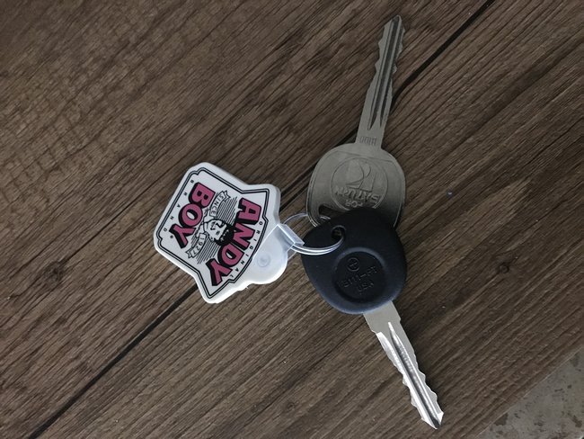

Greetings! Recently the car alarm indicator came illuminated on the dash. The nomenclature indicates that the vehicle should be brought in for service. The car still starts, runs and drives as normal. I would like to clear this notice. I did get two new aftermarket keys cut for the car recently from a locksmith. Any help would be much appreciated!

The extra keys have created the problem and the car might shut down on you. (I am surprised it is running) Do you have the original keys? Try using them to start the car and then shut it off. Lock and unlock the car using the remote then try to start the car an observe the security light.
Please report back.

Ken, apparently the keys that I have are all after market keys. The car was purchased from a dealer via auction and when it arrived those keys were received. One “ilco-B111-PT” key and one “B106” Saturn key. Both start the vehicle, only after I secured the two new fobs did I notice this occurrence.
How should I continue forward?
Jun 27, 2018 at 6:38 AM
  • 55,433 POSTS
You will need to have the new key programmed to the car a shop can do it should cost about $130.00. The Saturn key will not work.

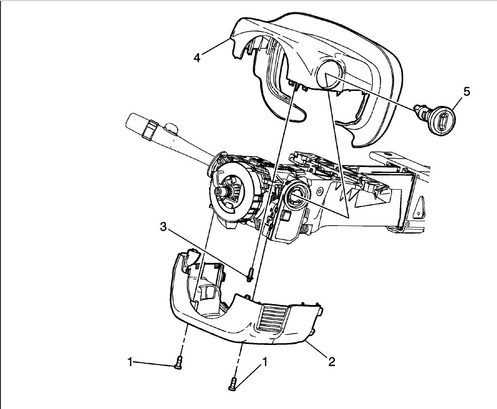

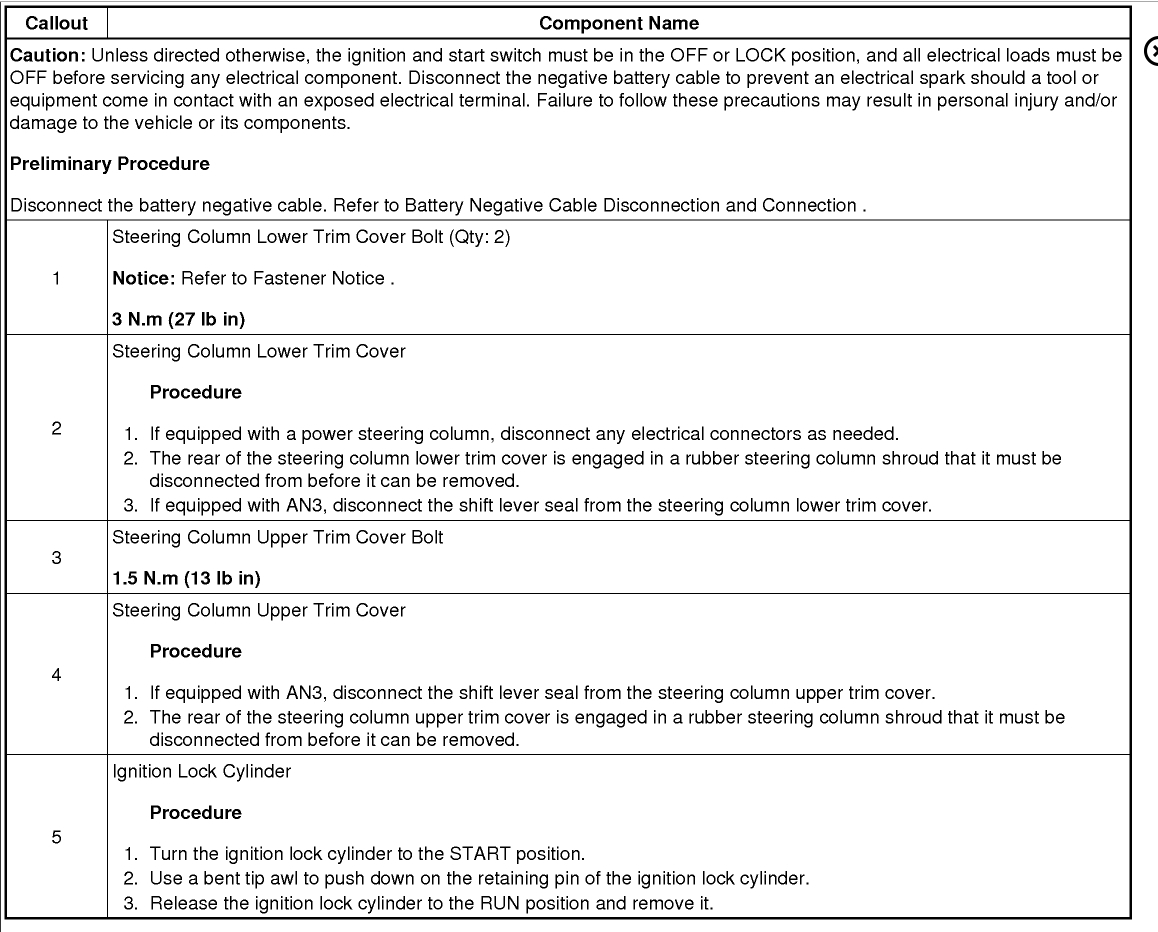

They could Here is the relearn procedure and diagrams on how to change the ignition lock in case you need it
