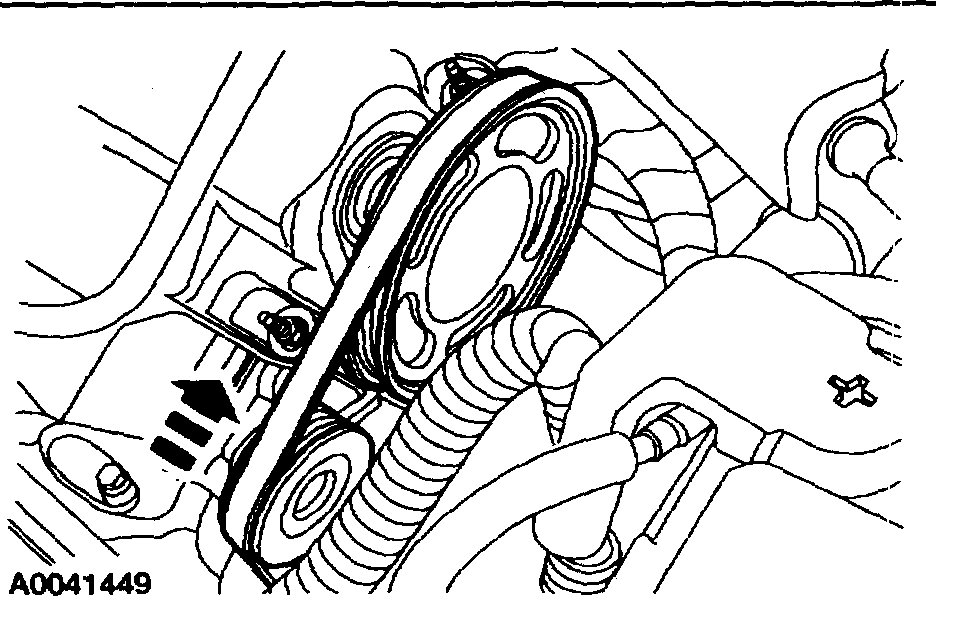

I have the car listed above with a 3.0 Liter DOHC 24-Valve V6. It has some kind of external camshaft drive covered with a shroud; you can see the pulley and the camshaft turning where it goes into the head. Isn't this an indication of a toothed belt driving the camshafts?
Sep 23, 2019 at 5:55 AM
Good evening

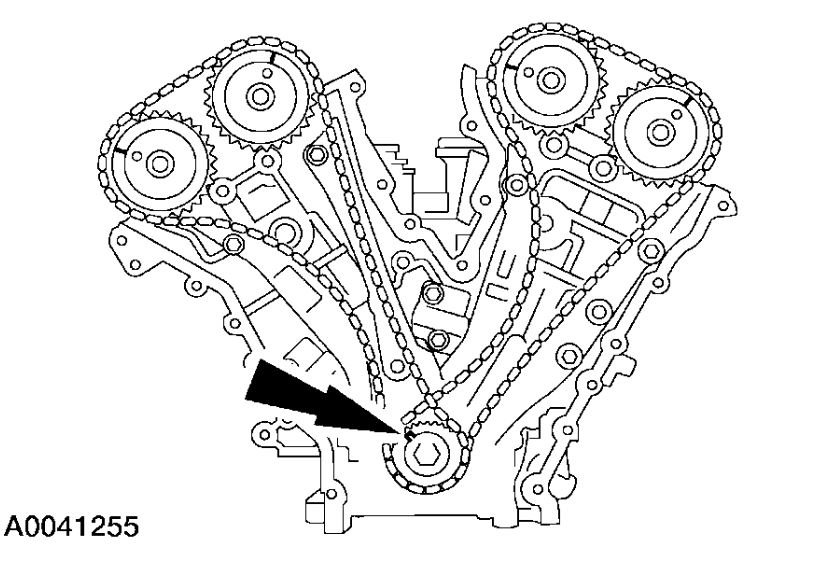

I attached a picture for you to view. Are you referring to the chain drive at the top?
If not, can you upload a video or picture of what you need?
Sep 23, 2019 at 8:14 AM
BMDOUBLE
  • 1,139 POSTS
This is the water pump mounted on the back side of the head. The cam is driven by a chain on the front of the engine but the back side of the cam drive has a pulley for the water pump.
