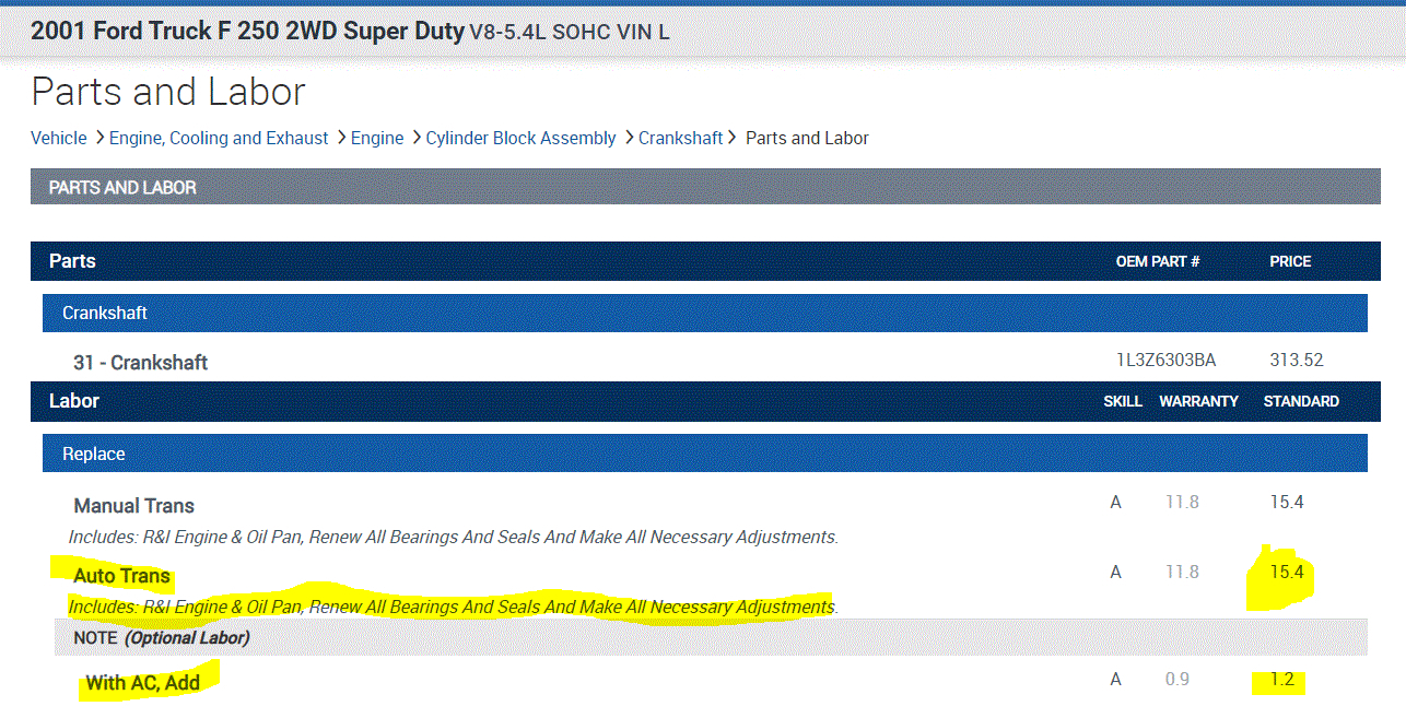

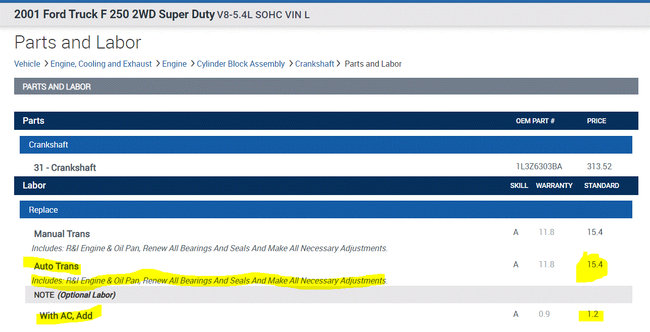

Need to know how many shop hours to put new crank and main bearings and rod bearings and new oil pump and new front and rear main seals in.
Apr 7, 2021 at 11:43 AM
  • 110,248 POSTS
I attached the flat rate hours below. The only thing missing there is the oil pump removal, but everything will already be apart, so I can't imagine them charging more than an extra 30 minutes.
See pic below.
