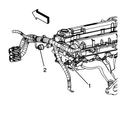

Where would the camshaft position sensor be located on a 2010 HHR?
Feb 16, 2016 at 5:44 AM
JOHNNYT73
  • 924 POSTS
It is an 4 cylinder overhead cam engine, it should be on the side of the cylinder head near near the top. I will attach a photo for you to see. Are you sure you need a cam sensor and not a camshaft actuator?
Feb 16, 2016 at 5:58 AM
JASPER JR
  • 8 POSTS
Actuator would be the one in the back right? Would you think it would be best just to change both?
Feb 16, 2016 at 6:18 AM
JOHNNYT73
  • 924 POSTS
The actuators sit on top of the valve cover I believe on the end. Which part(s) do you need to change? The cam sensor or cam actuator?
Feb 16, 2016 at 6:21 AM
JASPER JR
  • 8 POSTS
The cam sensor on the picture that you attached would the cam sensor be labeled as number 1?

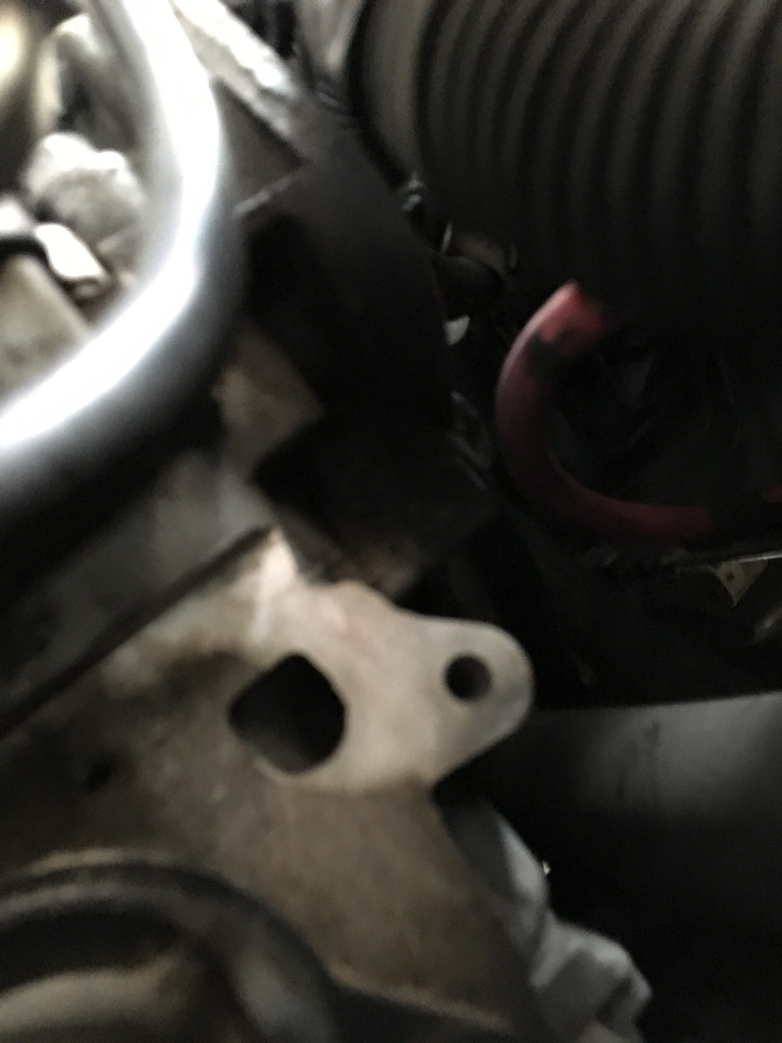

MIGUEL ANGEL SEPúLVEDA
I can’t find it , help me please

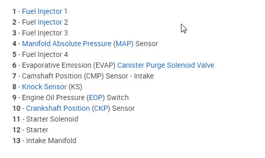

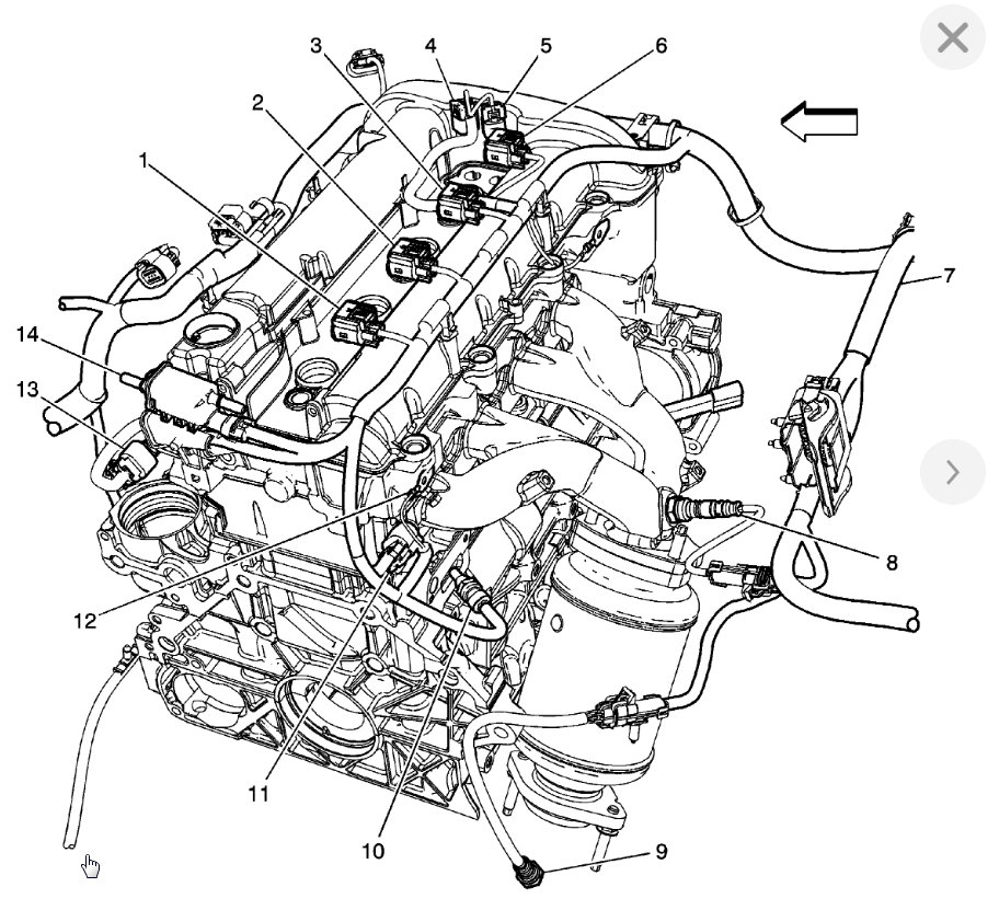

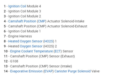

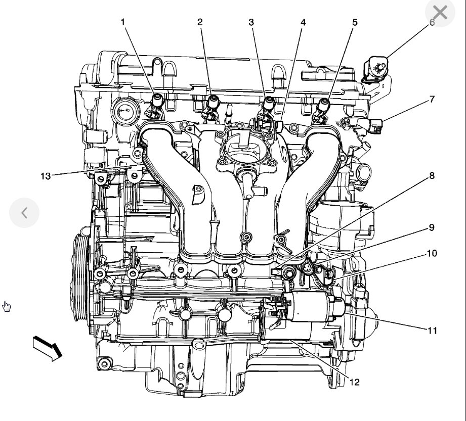

This is a very old post so it would be best to start a new post with your specific information because we have to assume your vehicle is the same as the other person's. That may be true in this case but that is not always the case and it just causes confusion and makes it harder to assist you.
Assuming your vehicle is the same, here are some location diagrams. If you have more questions or can't find it, please start a new post and we will help with whatever you need. Thanks
