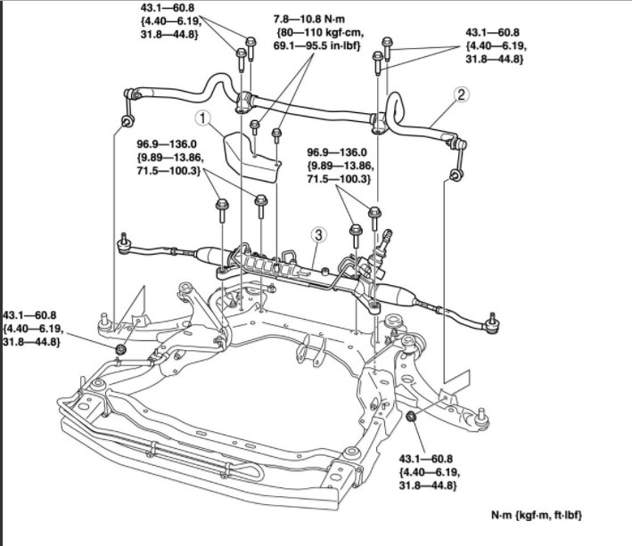

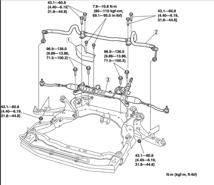

how to remove rack and pinion?
Aug 4, 2017 at 10:48 AM
Experienced Mechanic
55,616 POSTS
You will need to jack the car up to get started and you will need some line wrenches.
Here is a video of removing the power steering hoses:
https://youtu.be/BGBUv5r9fk0
Here is a diagram of what it will be like on your car (below).
Image (Click to enlarge)
