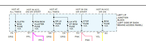

Lost communication with body control module?
Apr 2, 2025 at 9:46 PM
Experienced Mechanic
55,709 POSTS

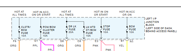

What happened with the P0445 code on your other post? I would start by checking the BCM power fuses. Here is a guide to help with the fuse locations in the images below.
Check out the images (below). Let us know how it goes.
