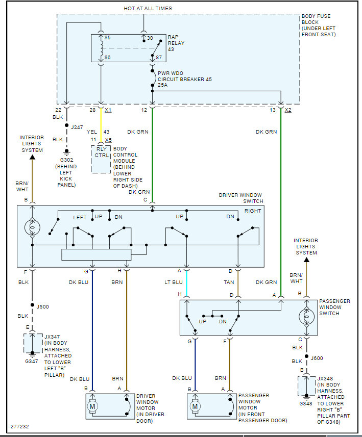

PW/PL 8-pin window switch wiring?
200 MILES
CALVIN MING
Replaced the door panel on my 2006 Express van and now have a 2008 door panel(by accident). Need the 8-pin wiring sequence for the 2008 door pw/pl switch.
So far everything else is working.
Oct 2, 2024 at 8:06 PM
  • 55,748 POSTS
Sure here is the power window wiring diagrams for the 2008 chevy express. Check out the images (below). Let us know if you need anything else.
