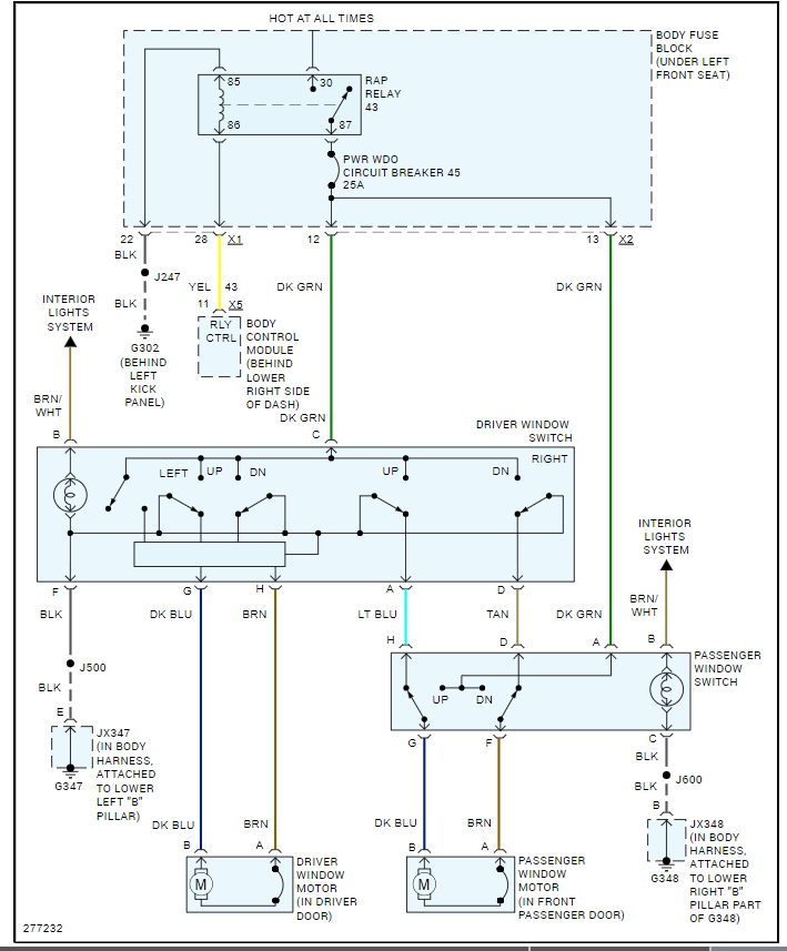

Replaced the door panel on my 2006 Express van and now have a 2008 door panel(by accident). Need the 8-pin wiring sequence for the 2008 door pw/pl switch.
So far everything else is working.

Sure here is the power window wiring diagrams for the 2008 chevy express. Check out the images (below). Let us know if you need anything else.
