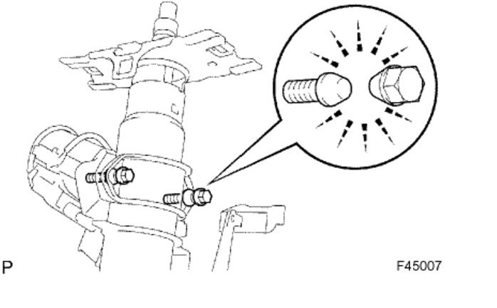

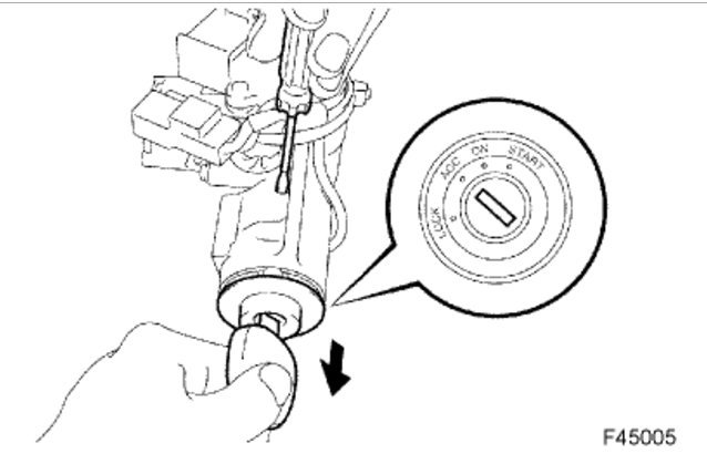

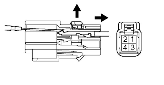

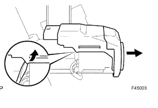

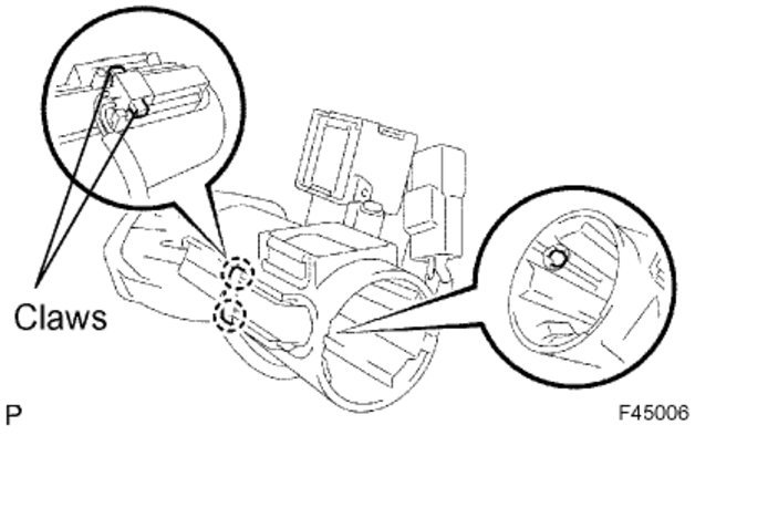

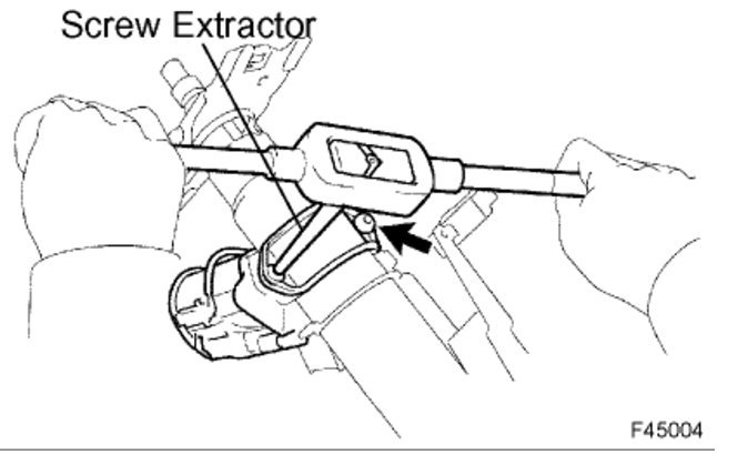

It sounds like the ignition lock is worn out. Here are guides to help you get it changed out.
